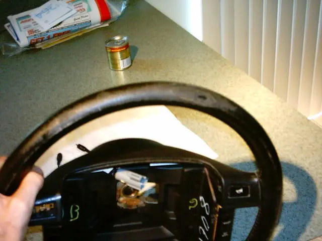

i had a pick of a steering wheel wore straight through from my notch when I got it, with a quick ratio manual rack and 245's. I personally hated it an swapped back. but like he said you really dont notice when your moving
and what is "a pick of a steering wheel wore straight through from my notch" mean anyway?:scratch:
I knew I should have stopped steering my car with my pinkies in the air...damn.
