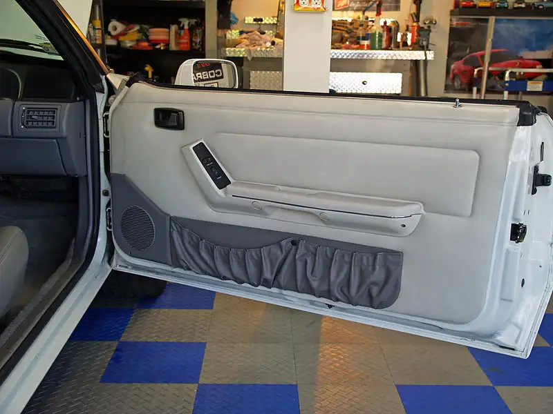

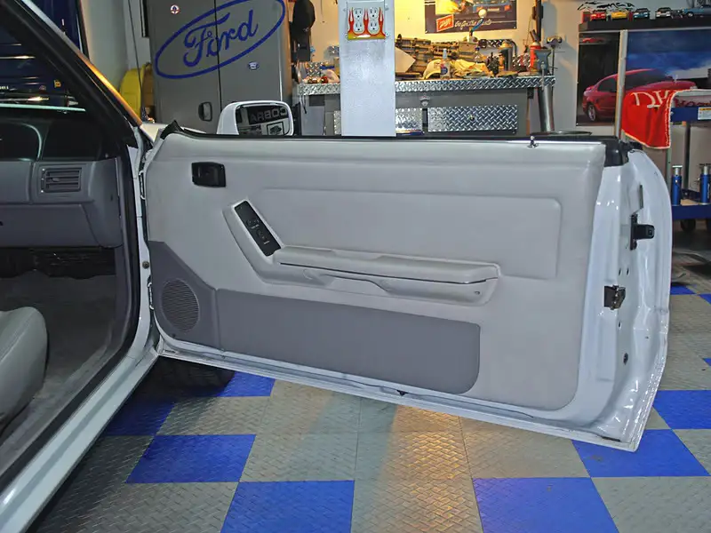

I used left over perforated leather from my seat project.
Before:
After:
The board holding the pocket comes off in about a minute after you pull the door panel. The pocket is stapled to the board the can be easily removed. Then do what you will with the board.

Those look nice. I will probably end up doing something along those lines. Nice garage
