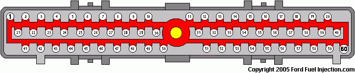

Complete computer, actuator & sensor wiring diagram for 91-93 Mass Air Mustangs
See the following website for some help from Tmoss (diagram designer) & Stang&2Birds (website host) for help on 88-95 wiring http://www.veryuseful.com/mustang/tech/engine/ Everyone should bookmark this site.
