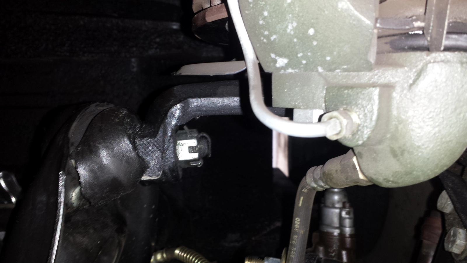

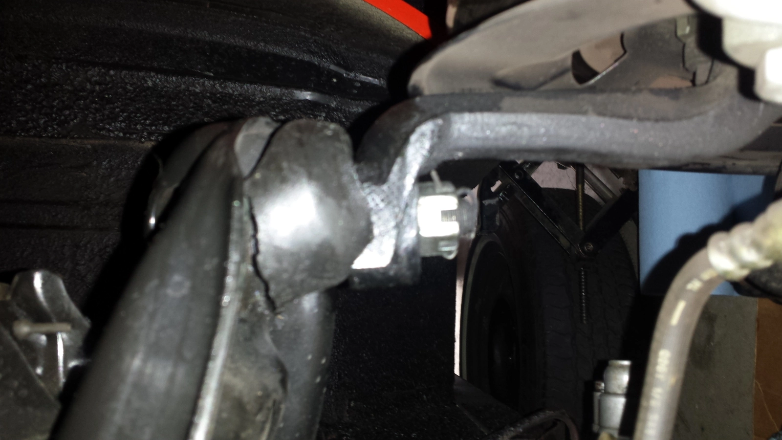

S Sasank Poduri New Member Nov 23, 2013 1 0 2 Nov 23, 2013 #1 Nov 23, 2013 #1 Unable to identify what bushing this is. And, how to replace it.
rbohm Founding Member Apr 12, 2002 6,698 550 204 tucson,az Nov 23, 2013 #2 Nov 23, 2013 #2 thats not a bushing it is the ball joint dust cover/grease cup. you need to pull the spindle to replace that item, and perhaps even the boll joint itself.
horse sence 15 Year Member Nov 29, 1999 12,398 8,321 233 Wile Coyote's stunt double Nov 23, 2013 #3 Nov 23, 2013 #3 yep, you will have to drill the rivets to pull off the grease cup . it looks like it was over filled with grease and blew out.
