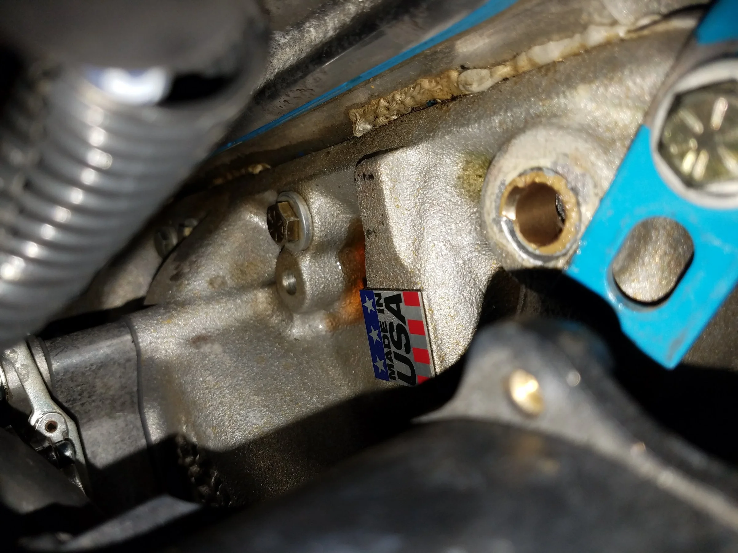

So I just got my car running, poured water in it, and fired it up and let it warm up. Everything was going great sounded good. Then I noticed a tiny leak from my water temp guage sending unit. So I put a wrench on it and it snapped right off. Any tips on getting the broken peice out?
Thanks for the tips guys. I went to advance auto and bought a broken screw extractor. Same thing as an ez out i beleive? Anyways it worked great!! Backed right out without even any heat. Got a new fitting and Teflon taped it, no leaks!! Once again thanks. I was worried I'd have to drill and tap it.
