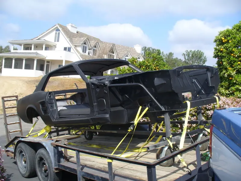

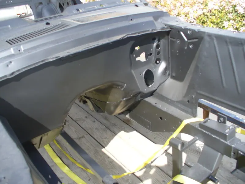

I just picked up my 67 from Street Rod Factory in San Marcos, CA. I had them strip the paint and rust and then primer most of the surfaces. I don't know if they did the whole car with just sand or some combination lighter media and then sand for the rust. There is still sand in many nooks and crannies.
They stripped the body (inside, outside and underside), doors, fenders and trunklid. The primer is epoxy. Total cost $1650 and they had the car for 4 weeks. Turned out good and now I just have a little body work and a lot of sanding to do. Then I'll add primer/sealer and more sanding and then it's back out to be painted.
I had my car done there as well, they used walnutshells on mine...it is light tan in color...at fisrt look it resembles silica sand.
Car looks good so far!!!
Solid looking body.
Did you have them paint it as well? JD told me about another Mustang they did about a year ago and after media blasting it was brought back for the paint.
I just checked the left over media. It sparkles like sand. I think they told me they would use walnut for the paint removal but sand for the surface rust. The body is straight with very little rust damage. There was some surface rust on the roof, trunklid and fenders. That was the main reason I wanted it blasted.

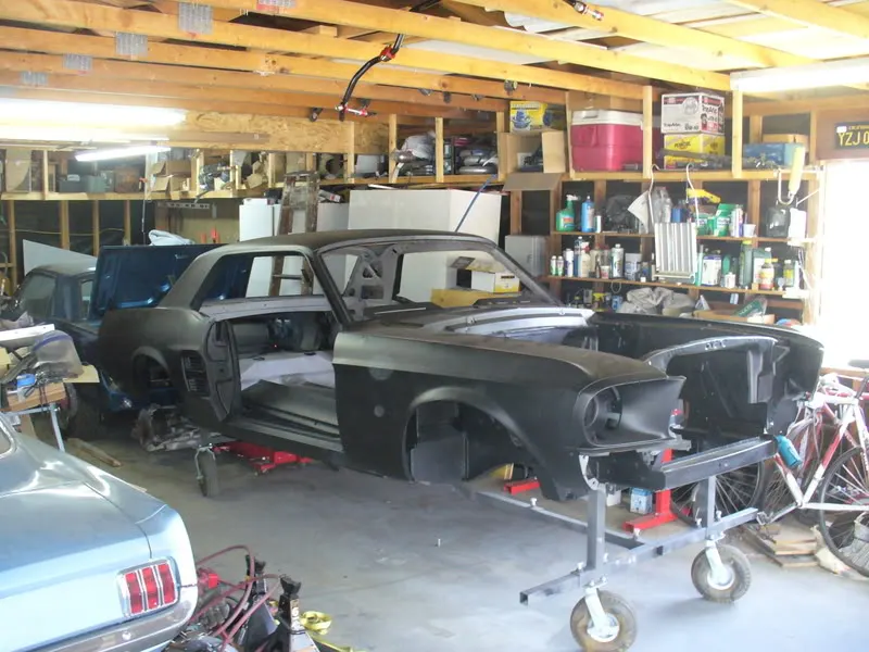

is that a bullitt license plate in the background of your pic?
That's the original plate to the '67. Like the rest of the car it's in great shape. It will go back on when finished. I'm not sure about the bullitt reference?
There sure is a lot of stuff in my garage. Eventually I'll have all the tools and enough spare parts to build a whole Mustang. Plus stuff for the house and yard and old camping gear we haven't used in 10 years.
O.K. I just found the oginal Bullitt license plate: JJZ 109 so mine's sort of similar.
