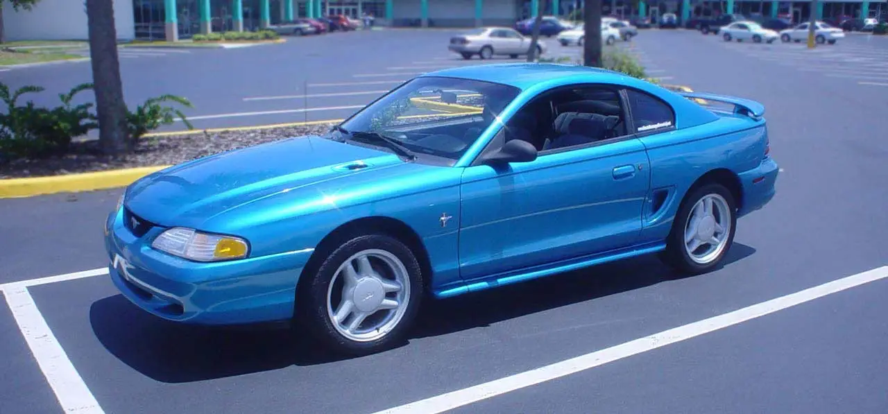

new pic of car
Hey all, just thought I'd post a new pic of the car after I had waxed it and cleaned it up good.
Looks really good Dave. I used to have tribars on mine too. Got tired of buying tires every year or so. So now I have the ugly '99 flat ponies.:rolleyes:

Ugly!?! Ugly?!? :mad: ;)
I use simple green and a sponge. It may not be recommended as I've never bothered to check, but it works exceptionally well.
Perhaps ugly wasn't the proper term. Beauty challenged?:shrug: :D You do know I meant the '99 base GT model 16" flat ponies aka '00 v6 ponies? You too can score a set w/ like new BFG tires for $395.00 at Stangparts.com ;) I guess I could try to fix up those waffles I have in the garage.
