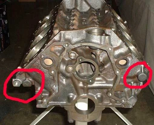

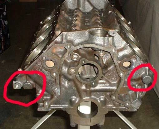

Here is how a Mexican block differs from the regular 302 on the outside:
That and it says "Hecho en Mexico" in the lifter valley. That is the only difference from an early 289/302 besides strength.

On the oil pan difference.
I am assuming that you will be putting the engine in a Fox chassis which has a rear sump. 302 blocks for Fox chassis in the 80's had a indentation and a hole drilled back by the lh 4th main bearing area to accomodate the rear sump dipstick. Any small block from the 70's {including Mexican blocks} did not as most of them had a front sump and timing cover mounted dipstick. There are some exceptions, E series vans and the first couple of years of Foxes, 77-79 Fairmont, Zephyr, 79 Mustang and Capri etc come to mind. For the Fox bodies, Ford had a pan, stick & tube set up that allowed a no hole block to be used. This pan set-up is long discontinued from Ford. I'm sure some aftermarket oil pan companies make one but it will be another expense that you may never think about until you go to put it all together! :shrug: That would suck! :mad:
I'm sure a machinist could drill an older block for you but it would also be another expense and a PITA if the hole was not drilled just right!
Fords aint like a Chebbie, us Ford owners gotta think a little when we want to swap engines around!!:D :D

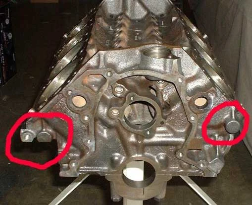

Ok, i didnt think of this before... but now that Im looking at it (lets hope im looking at it the right way)... Does anyone know if that extra crap on the left is gonna mess with my blower bracket assembly? Im sure it can modified to fit but Id like to know before the project is underway! :shrug:
