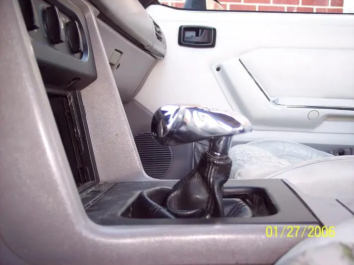

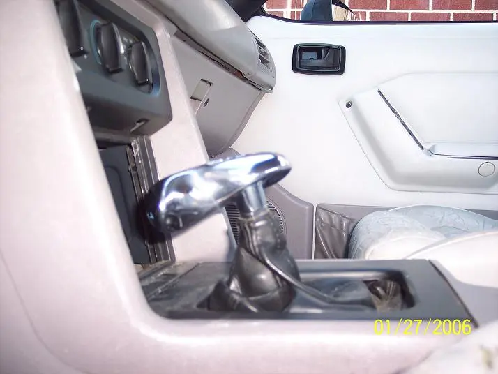

i cut 1 1/4" off the top, 1" off the bottom of my pro 5.0 shifter. Then I redrilled the holes so that 2nd gear is almost straight up. Ive done this mod for a few of my friends and I havent seen a shifter with a shorter throw yet.
this first pic is the shifter in 1st.
this pic is the shifter in 2nd
This mod only works on the fox style console. The 94 & up consoles wrap to close to the shifter after the mods are done.

That looks too short almost like reaching down into the console. How does it feel
