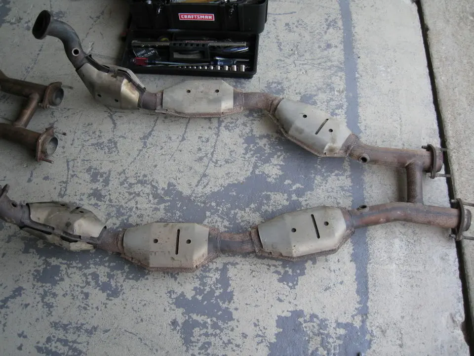

Pre '00 has 6 cats.. His stock midpipe had 6 cats on it
