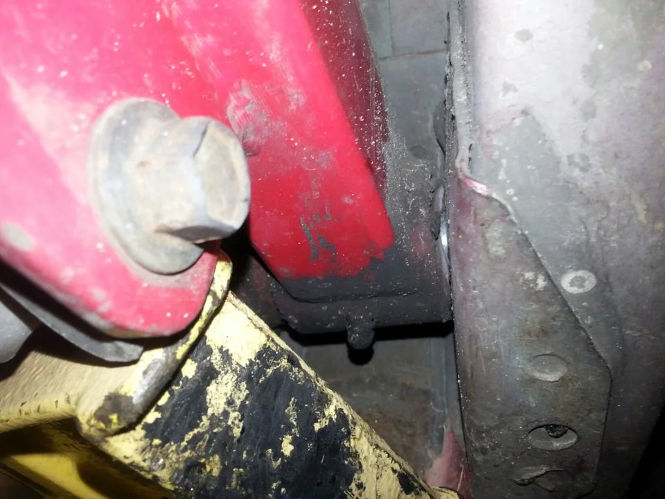

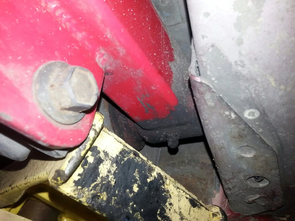

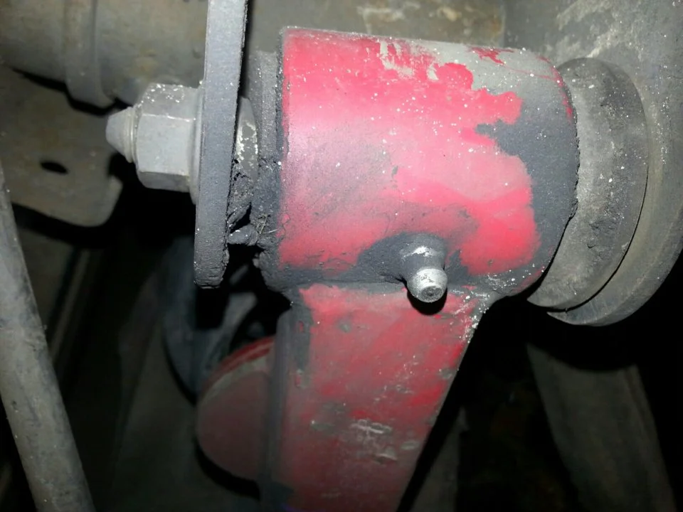

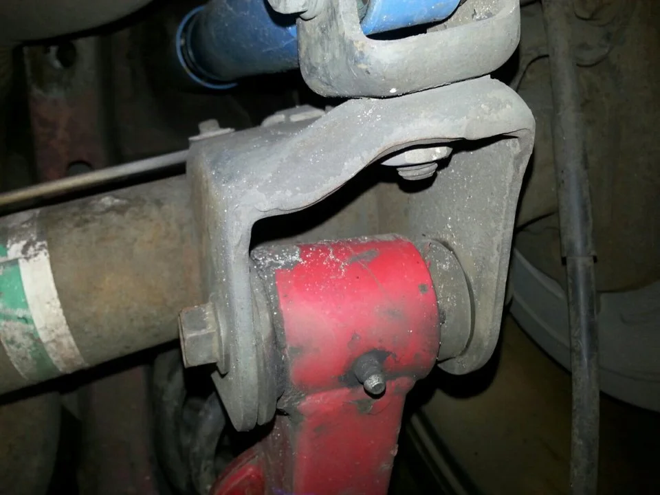

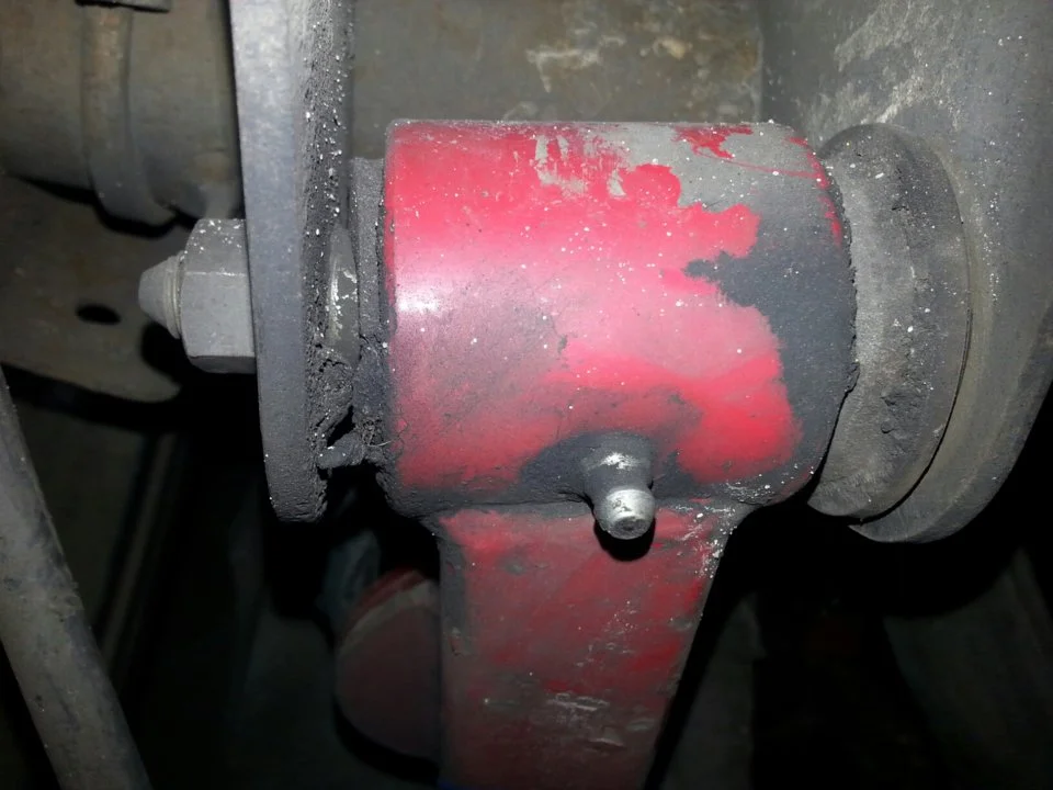

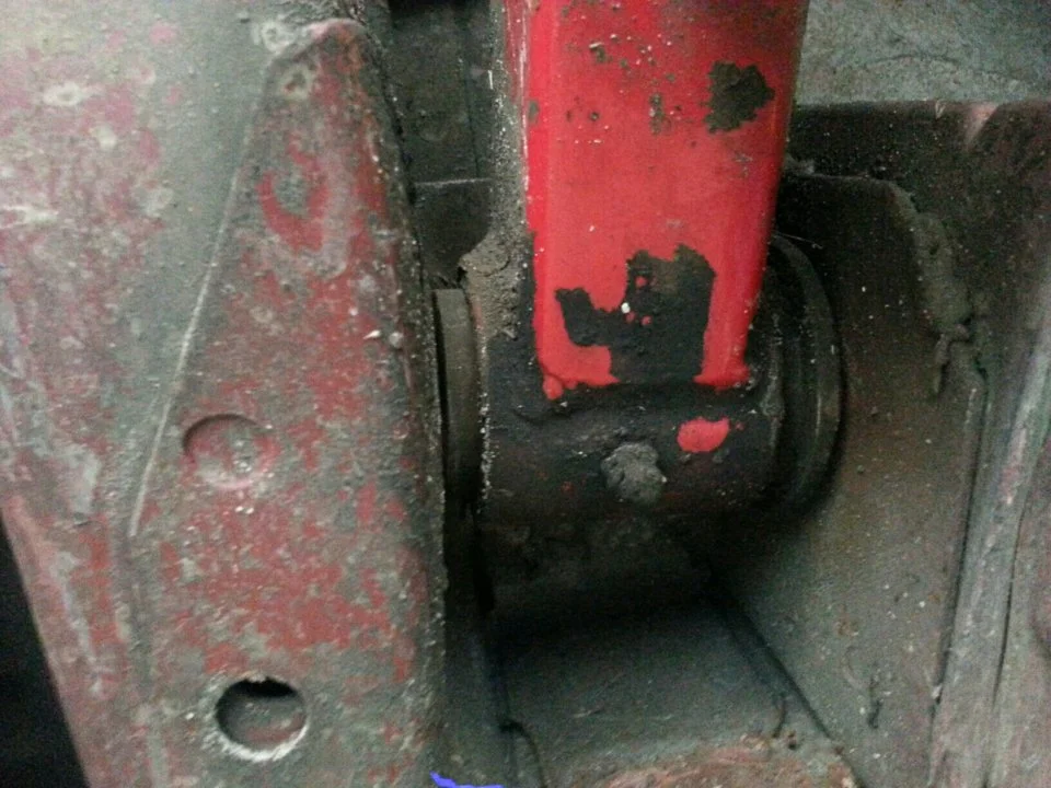

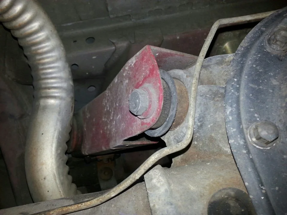

This is for everyone and an update on rear suspension check. It really wasnt anything noticable to me and the guy at precision tune who checked the car even though I could tell he wasnt that knowledgeable on the matter. Somewhat but not an expert. At least I could get the car up in the air and take pics which I will post below.
Here is the main issue I am having. When I go over certain low spots in roads and even some railroad tracks at normal speed, I hear the scrape sound from rear and I'm sure the fenderwell lip is hitting the tires with the rear of car going down that far. New shocks and struts put on last year, new isolators, struts, and all front end work. Tires are 295 35 18's in rear on 18x10 wheels. I did notice the way I was parked in garage for a week since drove car before today, it appeared car was leaning or squatting more in rear but it didnt look so that way today in shop so not sure if it was my garage floor or what. Not exactly sure but using 2 fingers check there and when got home, there is just a lil more than a hair difference using the 2 finger check method which is what can get between rear tire and fender lip. Also looking at the lowers, I wonder why the arm isnt the width of the housing? The arm is resting on the bushing though the bushing has a rubber sleeve. Also do the arm need to be more centered on the bushing?
I just hate that dawggone scraping sound when I hit those spots in road, it's irritating and appears the tires are being hit some, can actually see it. I even rolled fender lips some with a baseball bat sometime last year. I want to make sure everything in rear is up to par so here are pics below and let me know what yall think I might need to do/change.
pic 6 is in next post

also another pic, compare pic 7 to one of the other 5 and you should be able to see how one is centered and the other side appears the arm is more to the end of the bushing/housing

If tires are rubbing, its probably on the inside of the wheel well, about a 275 is about the widest you can really go without some kind of work with a bfh. A 295 is almost an inch wider than that.
The bushings in those arms do look pretty tired though, I would at least throw some new bushings in there, I would almost bet a call to prothane or energy with some measurements would find what you need (they probably make most of the a/m arm bushings, or at least the material for them)
when i bought those arms at first, the ones that came in the Mac arms actually crumbled up. How do you know when Polys are worn? Mine are actually energy suspensions the bushings that we swapped out before
