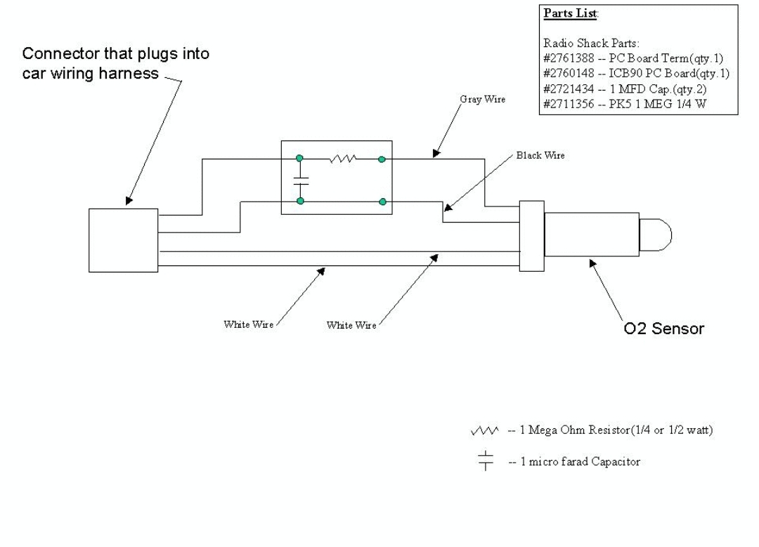

I used homemade mil elims back in the day on an 04 Mach1. It's just a 1mF cap and a megaohm resistor. Worked great for 5+ years till the car was sold.

It's been a while since I've played with MIL eliminators, but I think they still might need to be present in the exhaust stream to generate a signal range that the eliminators "tweak" slightly. Those dead-legs might not let it work properly. Or it might? Who knows.
