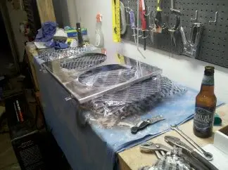

I did not have a fan shroud for my radiator which is another reason i bought an electric fan, i didn't see spending more money on a shroud, i had one borrowed from a buddy and it didn't help my cooling problems

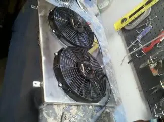

So there are no directions in the box on how to install these fans so i had to do some web searching, i finally figured it out
I test fit everything together before i dropped it in the car.

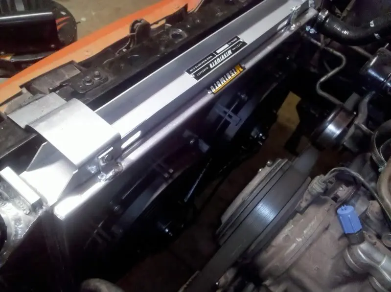

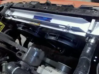

Dropped right in, had absolutely no fitment issues, i had to custom fab some brackets because of my hood.

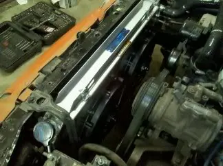

once again fit great
more of the same since i cleaned my droid camera it worked better
Overall, i am satisfied with the purchase of the kit, i didn't need all the hoses but it will be nice when i get a hole in one at 12pm and the stores are not open. Fitment was great and car runs a good 190* with a/c on and idling in traffic. I got the relays wired up to turn on with a/c and im trying to tune the fans to start at the correct time. Hope this helps someone who wonders about this product
