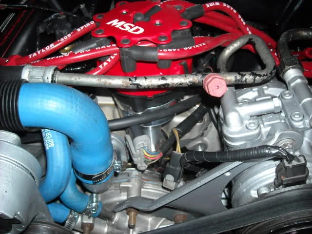

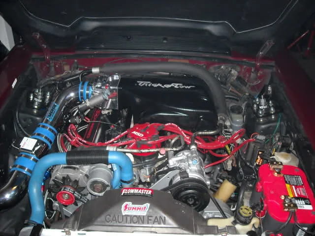

my car is doing the same thing i just put a new 306 motor in it with 30 lb injectors and the trick flw fuel rails and regulator and ss braided lines...today was the first day i really drove it since it being built...my question is where should the timing be and the fuel pressure be at for a pretty moddified motor.. it felt fine when i got on the highway goin from 4th to 5th...but just getting on it it hesitated on me also here is a pic of my setup
and here is where the distributor is my buddy set it advanced if it right?

sorry to hear that, sucks to have put all that together to have these bugs that could be anything. im in the same boat although ihave the gt40 mods for a i just recently strated using the car and enjoying it, but everytime i go for a ride i get hit with something else...as for your timing i would still think 12*to 16* even with your mods....
.are your injectors new or used???
