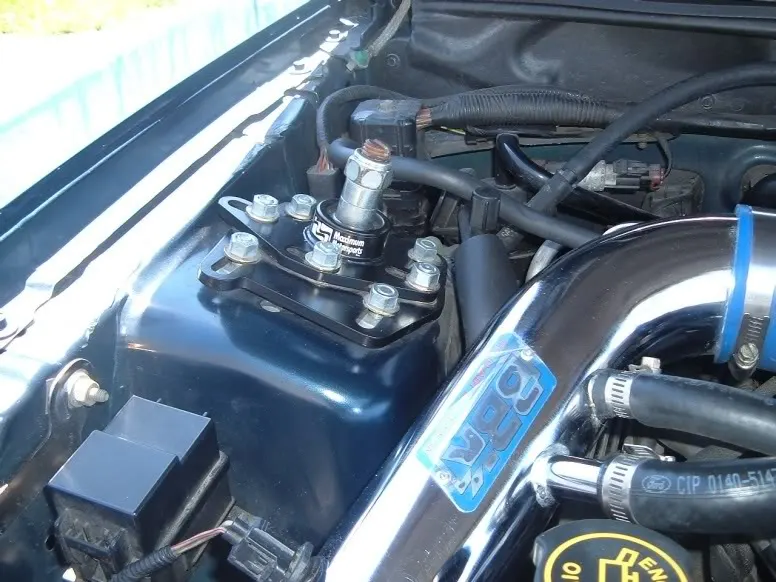

What would you like to see? Here's where we are right now:
All 4 wheels on the ground.

I have sportlines which are pretty much the same as your springs and i have the same struts/shock you have..I have the 2 big spacers on top and the small ones on bottom and mine look just like yours and they are doing me just fine.. my car is also set up for open track though, which is why the spacers are flip fliopped....and my top plates are in - camber whereas yours are in +.. but hrere's a pic if it helps any
oh and as for the shaft on the strut turning with the nut, mine did that too.. i had to break out the air tools for this one... so if you got em, use em
