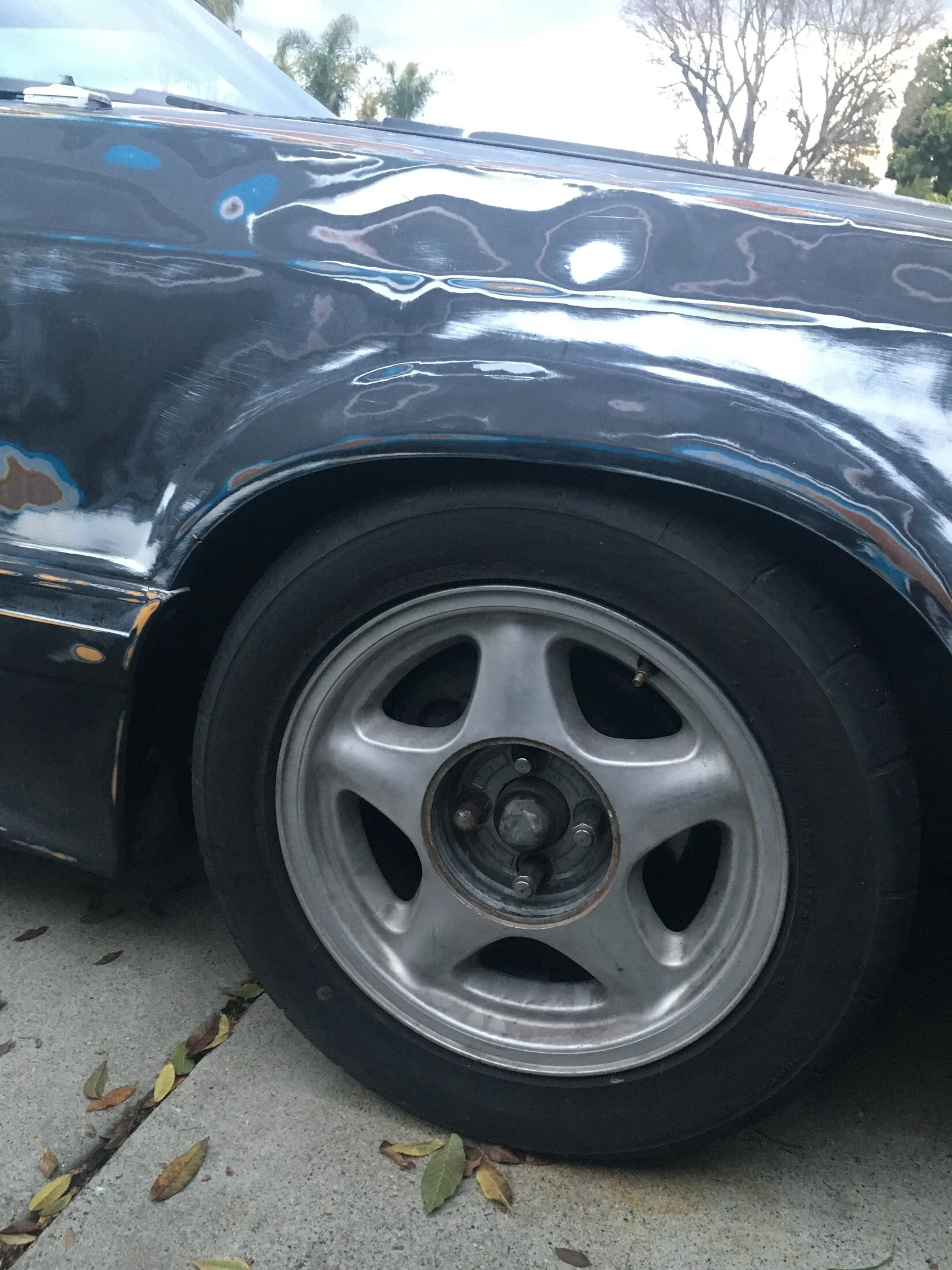

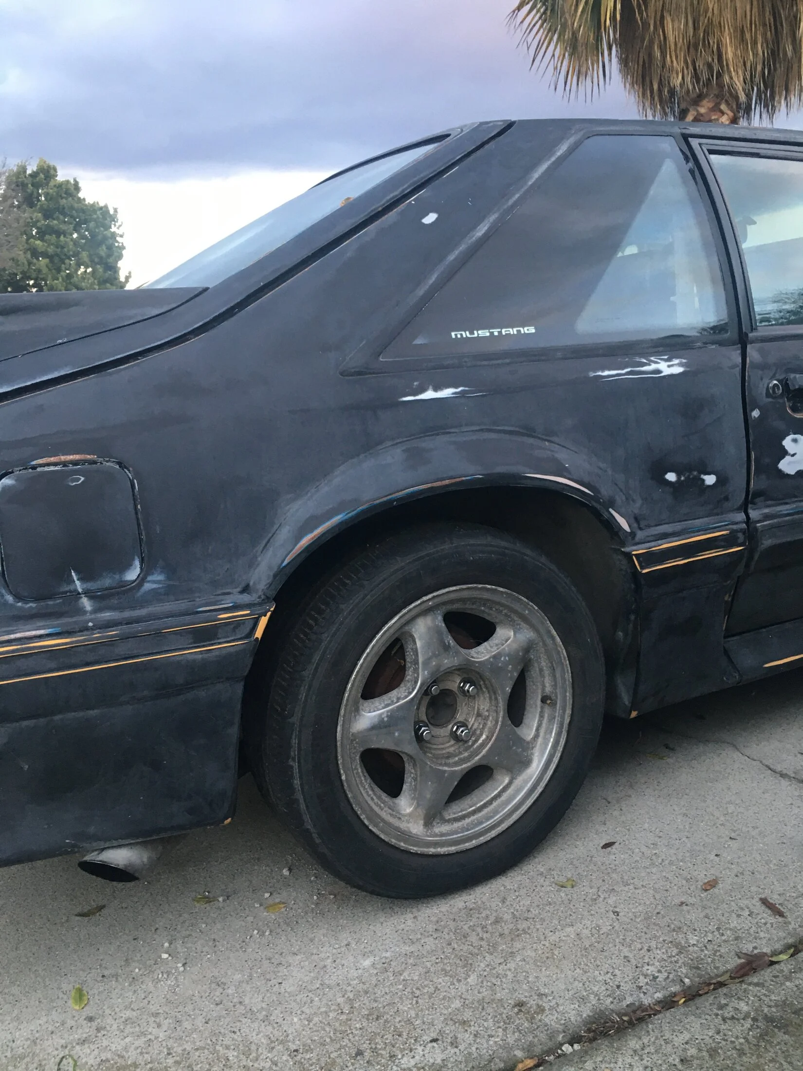

Peace and Blessings all. I just got to installing some Global West RLCA and a set of stock uppers with newer rubber bushings. I did not replace the axle bushings. After installing the control arms I torqued the bolts down without loading the suspension and put it on the ground and saw the ride height was looking stock. I realized I was supposed to torque the bolts with the suspension under load so I got back under the car loosened my control arm bolts, my shock to axel bolts and my quad shock to axel bolts. I then jacked up my axle just until the rear started to lift off the jack stands, re torqued the bolts and put my wheels back on and dropped the car to the ground. My ride height is still looking stock. My sway br is also a little lower with these control arms, but I dont think this will be a big deal.
I have SVE Lowering springs which before the control arms had my back end much lower around 24.5" from ground with 205 55 16 tires
my ride height after changing the rlca's in about 26.5"
I also recently installed MM CC plates, QA1 coilovers and Koni DA with JDI bumpsteer kit and new sway bar end links u front. I adjusted my front ride height to match the reaer which was around 24.5" at the time. The car has 0 miles on it after all of these mods, I have only driven it around the block.
Does anybody have any ideas as to why my ride height is so high... the springs have been on my car for around a year and are broken in... do I also need to break in the control arms. has anybody else experienced this? thanks in advanced.
IMG_2046.webp After Control Arm Install and re torque with suspension under load
IMG_2049.webp front with 225 50 16

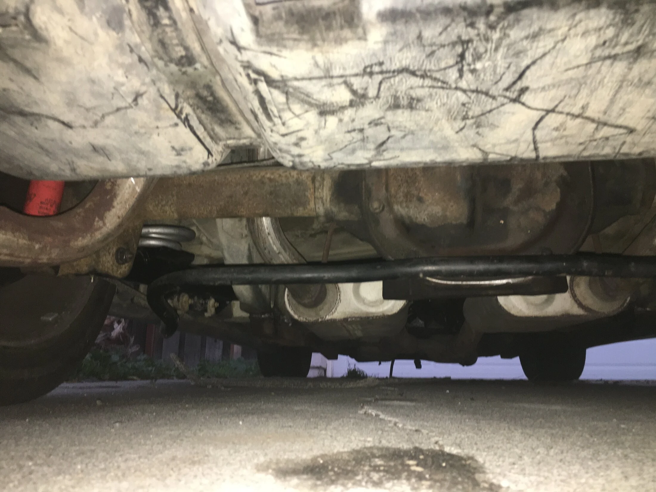

IMG_2053.webp sway bar position
Did you loosen the bolts to the point that the inner sleeves in the bushings were loose and could pivot properly?
I assume the global west arms have 3 peice poly bushings? If so, these do not need to be torqued at ride height because the inner sleeve is not captured by the poly bushing and is free to rotate. Really the concern is the upper arms because the rubber bushings are impregnated around the sleeves. Those need to be torqued at height.
Usually what I do is install all the bolts just snug enough to prevent rattles, but loose enough that the inner pivots can move. I drive the car around the block up over bumps and such to articulate the suspension. Then i'll torque at ride height.
Other things to check. Do you have the rear spring pigtails in the correct orientation. If oyu look at the springs from the rear, both pigtails should be pointed to the driver's side.
Thanks for the reply... I will check the orientation of the springs pigtails as soon as I can get back under the car, i know i pointed them in the same direction as each other but not sure where they are pointing. I loosened the bolts enough so that i was able to move the nut by hand... I may try loosening them again and going for a ride around the corner, i have a parking lot with speedbumps just up the street.
Just for the sake of checking, you can loosen the bolts and leave them loose and do a few short rides. When you get out, the ride height shoyld be where it wants to be even before you retorque. That way you can adjust springs and such, all before torquing it down.
Usually what i do to torque the rear is jack the rear up and put the axle tubes on jackstands so the weight is on the springs. Then i can get under there and torque.
If you bought the LCA's from Global West recently then they have spherical aircraft bearings on the frame side and a Del-A-Lum bushing on the rear end side so they can be torqued up at any height or loading. If it was difficult to get the UCA's over the rear end bushings or inserted into the body mounts then you are already fighting a battle. You should really replace the ones on the rear end if they are original or you do not know their age. The upper bushings taka a beating.
Other than that Mike summed it up very well. If you continue to have issues call GW as they are super helpful. I run their subframe connectors on both of my cars and their UCA's on the T-Bird.
