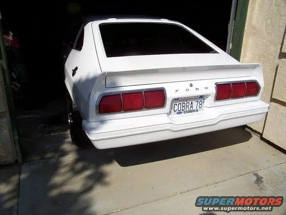

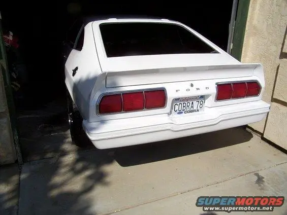

It wasn't that labor intensive I spent all of 3 hours doing it. Oh yeah, I decided to come home for lunch and slap them on the II so here's a pic.

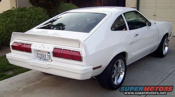

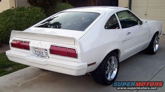

Here's another pic
