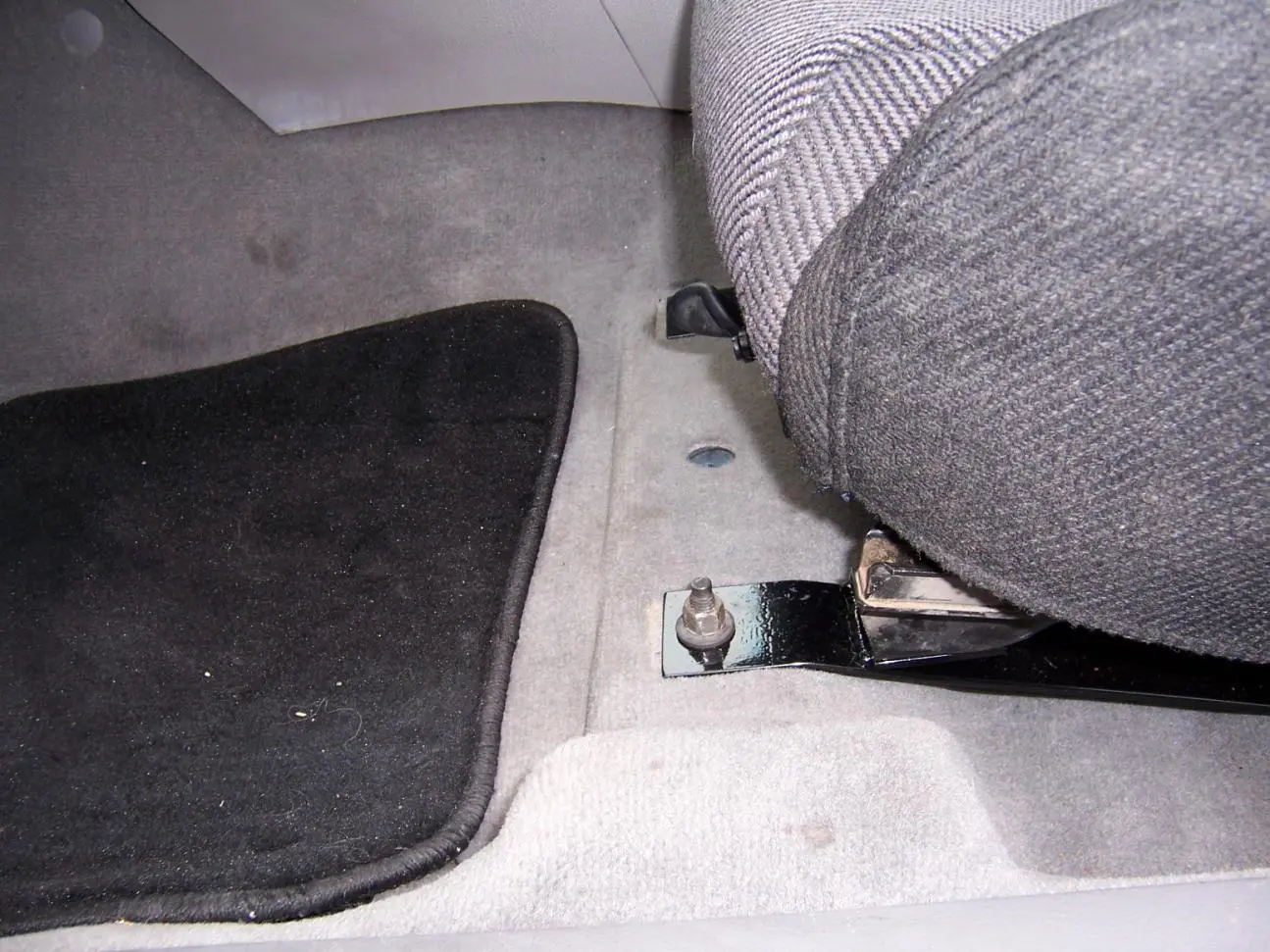

I'm 6'4 with a 36 inch inseam. I had the seat track extenders on my stock seats and they made the car fit alot better. The extenders give you about 4 inches more room.

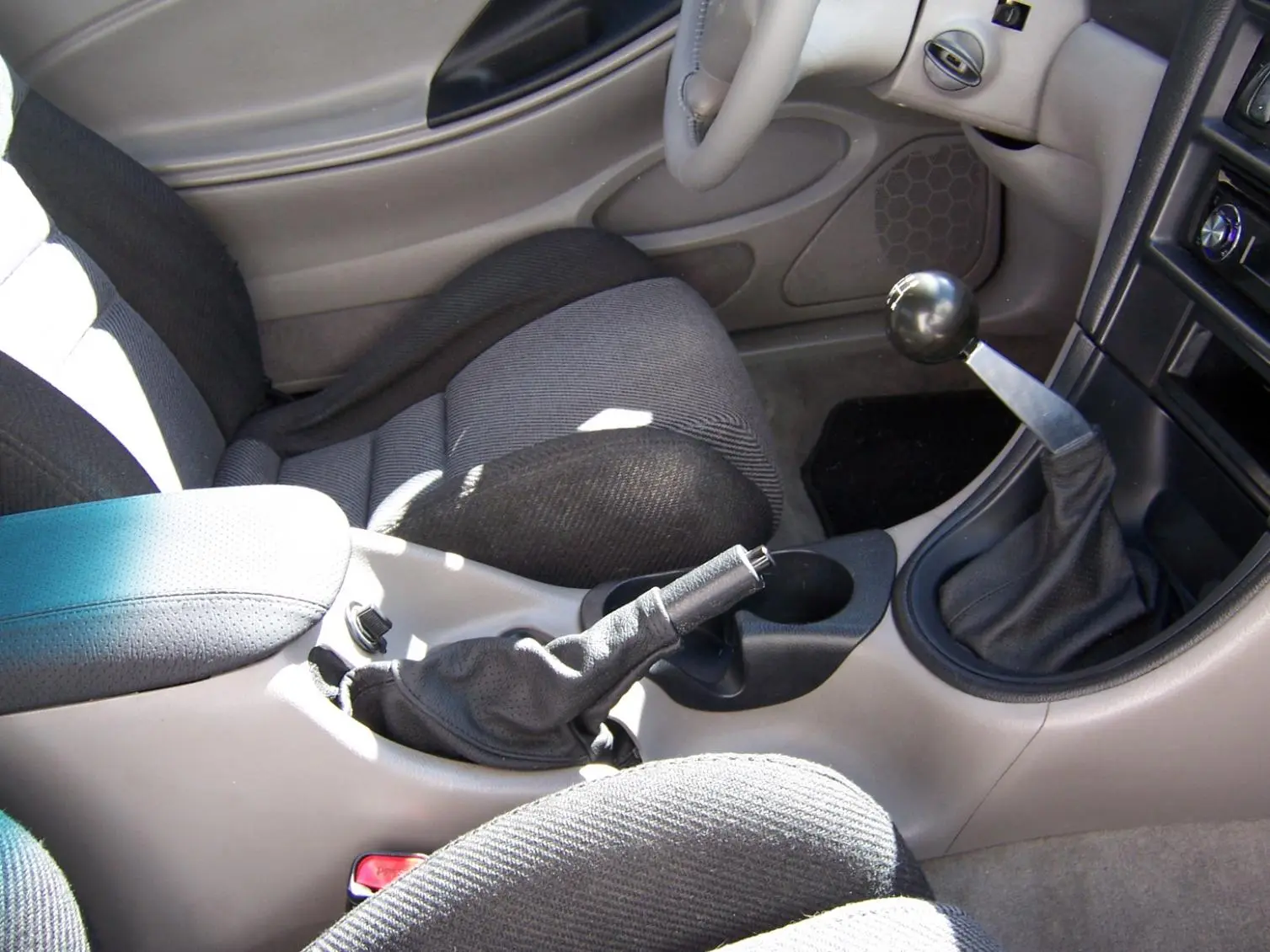

I needed a longer shift lever after I moved the seat way back so I put a UPR Rockcrusher lever on my shifter and now my car fits me.
