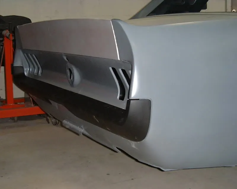

I am kicking around the idea of filling in the body line between the quarter panel and extension piece on my 67 coupe. The only thing that worries me is if it will fill without cracking in the future. I am trying to get this car as slick as possible, no emblems, antenna, no side or rear moldings. Has anyone ever done this? Thoughts?

My last '66 had that done. Also welded in the seam on the valance. Looked good and in over 10,000 miles I drove it, it never cracked. Prep it good.

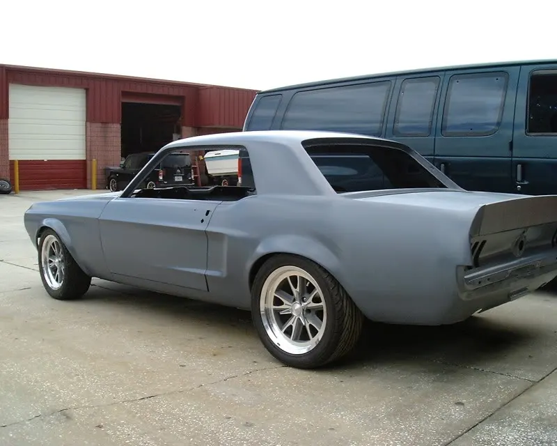

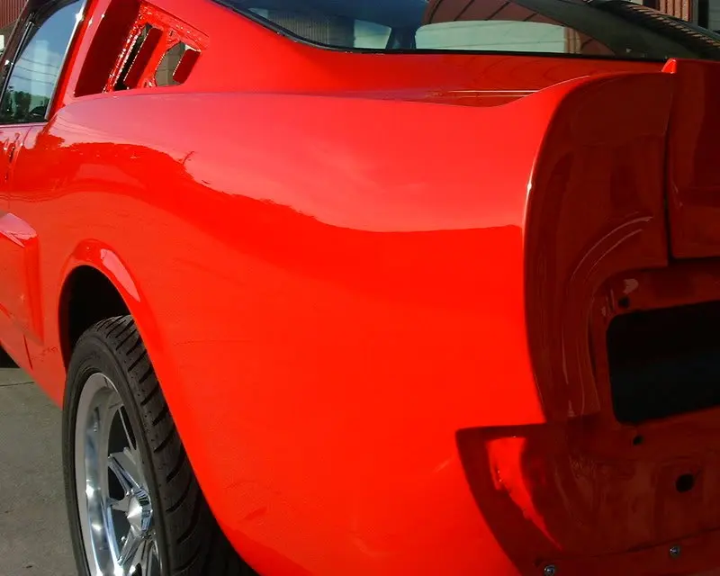

I have done it on two 65's, 68 fastback and a 68 coupe. I used panel adhesive and also bolted them on.
I also did away with the drip rails
Looks great! I think I will do both the drip rail delete and smooth the joints at the rear quarter extensions the next time around.

Wow, yeah, im definately going to slick these lines up, that 68 coupe is EXACTLY the look I'm going for, low and mean. I am not going to shave the door handles tho, just too much trouble, and still kicking around the idea of shaving the drip rails, how much trouble is involved in that procedure?

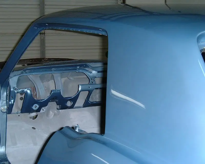

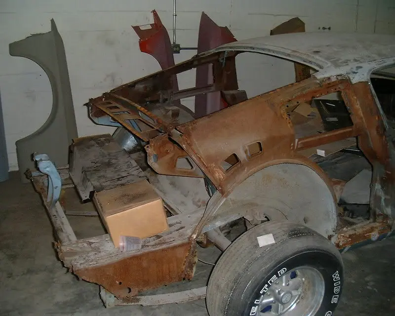

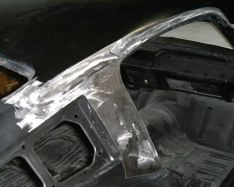

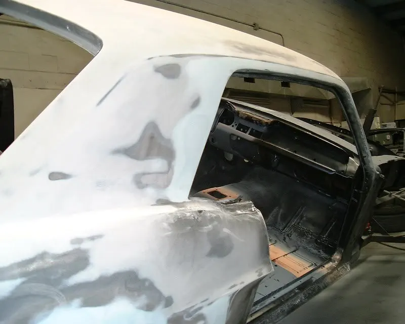

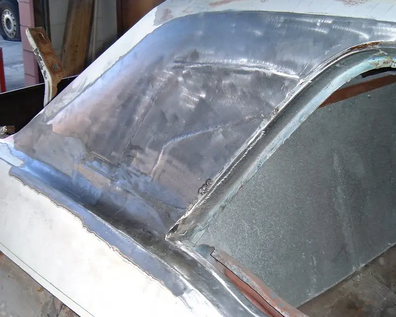

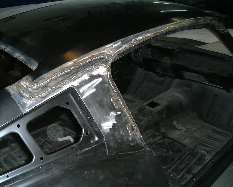

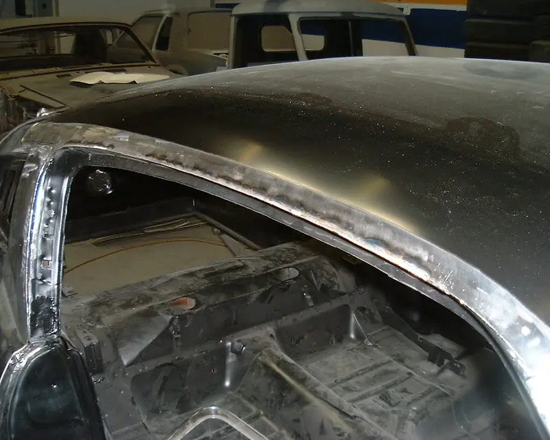

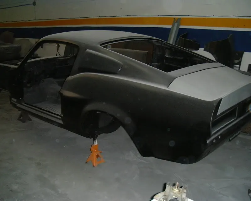

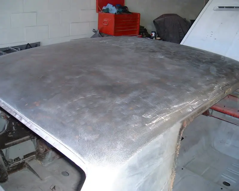

My coupe was not a rust issue so it wasn't as hard as a 67 Coupe with a lot of rust we did. I liked the look so I did it to my car.
The first thing it to cut off the drip rail and all the rusted sheet metal. You will have to fabricate a patch for the rusted out area and weld the area where the drip rail was cut off.
My 68 coupe during bodywork
1968 Fastback that was so bad we had to install roof and both quarters
Grind welds than epoxy prime and do your bodywork

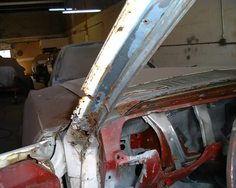

Where the factory attached the roof is a lead seam you need to remove it before you can weld it back together. The easiest way is to melt it. If you look at the fastback pictures you can see a patch welded to the rear sail panel where the quarter and roof meet also the front windshield post. You can use bondo but we did not want it that thick so we welded a patch.
Later this year we will be doing a 65 Fastback and I will have progress pictures of removing the drip rails.
