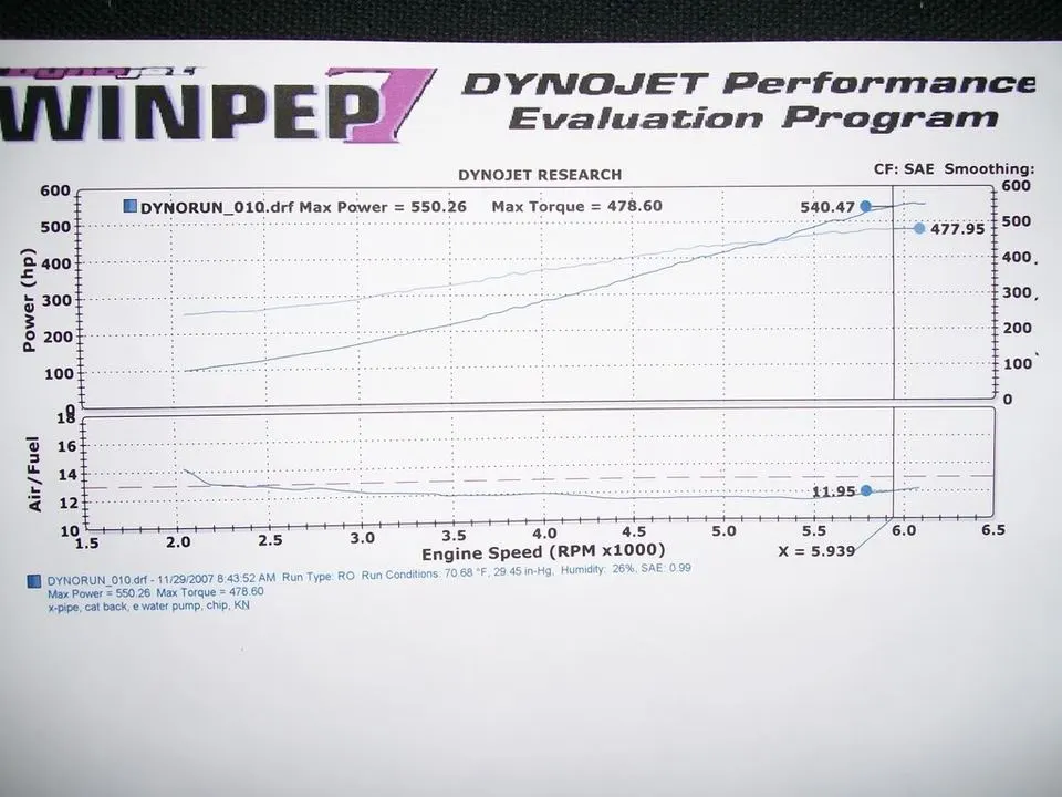

Tim2002GT said:
PM hotmustang331. I think he had his stock bottom end GT over 500 whp before the accident.
Yup, stock bottom end:
But his daily set-up i believe was 477/466

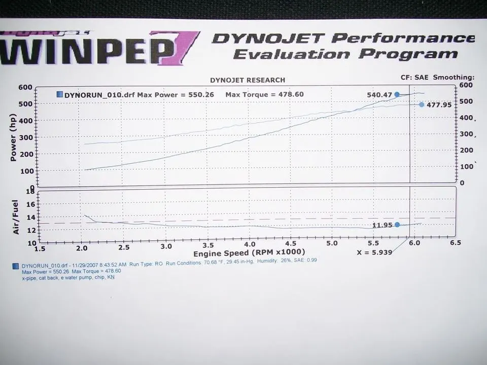

Yep, as the above have said...I made a peak of 550RWHP. That was with the boost climbing until he (dyno operator) shut it down, because it was having trouble building boost due to the light load the dyno puts on the car.
I daily drove the car @ 9-10 PSI which was somewhere between 47X and 500...I really cant remember and it depended on the PSI. I think 10PSI was 499RWHP. I went WOT ALL THE TIME....I wasnt easy on it by any means.
That car gave me almost ZERO trouble....infact I have had more problems out of my 03 cobra making just 476RWHP and 29K miles than I did with my GT @ over 70,000 miles. It was turbo charged around 55K miles....before then was cammed since around 20K miles and seen an uncountable number of 6200-6400RPM shifts.
My cobra started missing the other day....and now tonight its breaking up @ WOT and the miss is pretty bad at idle. Its like one thing after another and I just hope its nothing serious. So far just alot of more or less minor problems.
