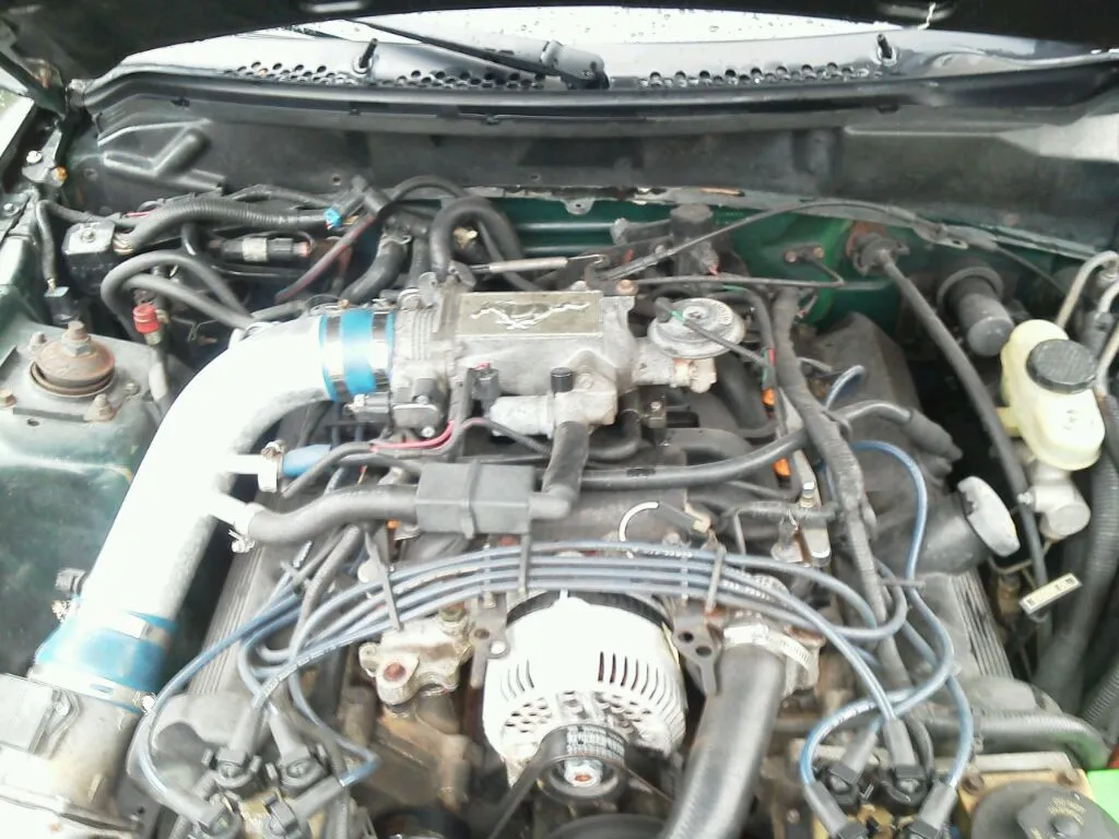

This is what the top end looks like.

did you buy this car from a guy out of scottsboro alabama?

No,came out of south Florida.

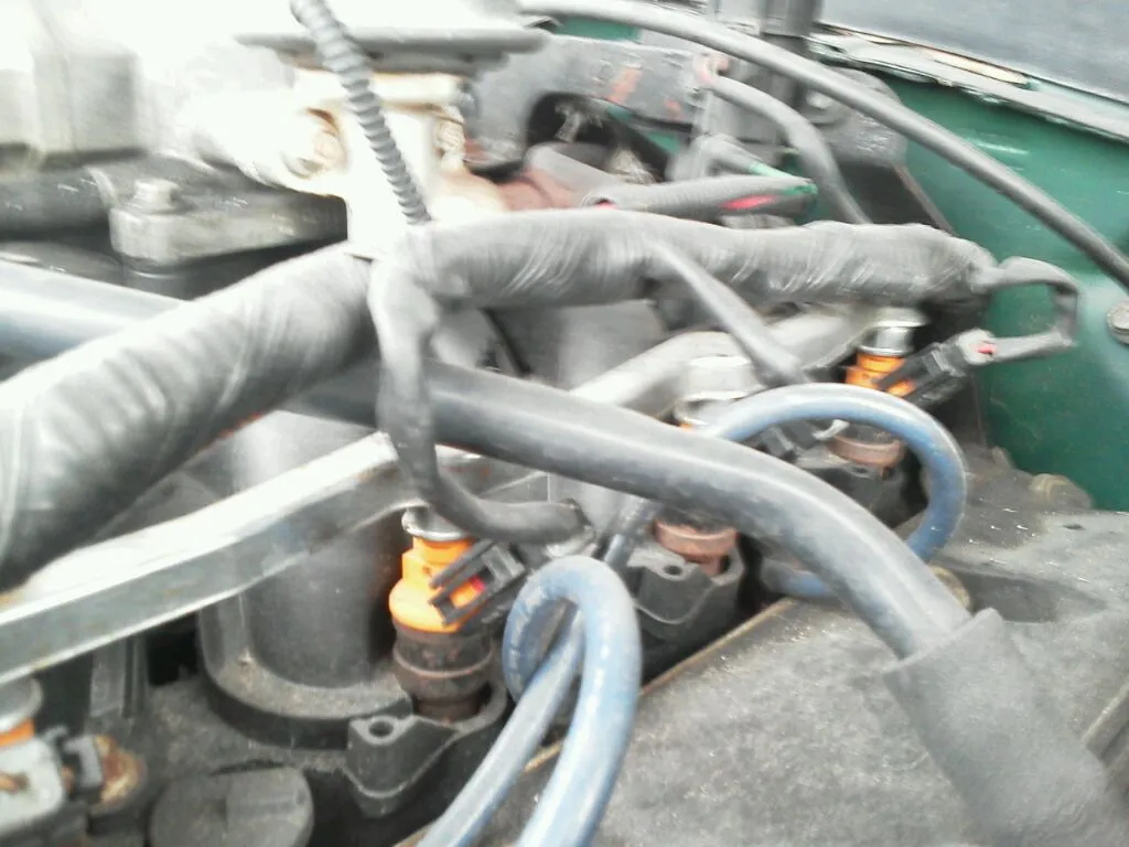

You have the 19lb fuel injectors.
