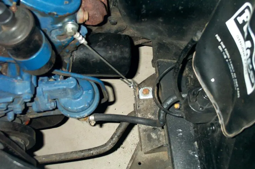

Hey 302, here's a picture of my torque strap. I had some extra braided steel cable laying around so I figured I'd try it out. Mine's not as beefy as yours but I think it will do the trick. If not...I'll just make another one out of thicker cable.

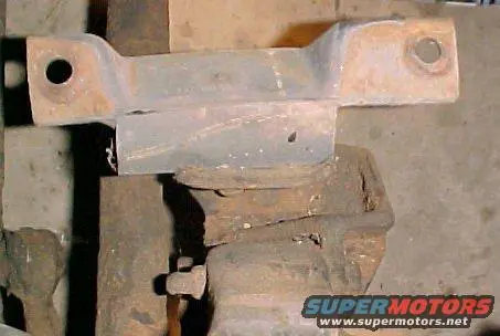

It looks like there are 6 pieces to use the cast posts. The motor mounts, the cast posts, and something that looks like angle iron with a bolt through one end. What is that piece for?
It is basically an angled spacer. It is mounted between the rubber motor mount and the cast posts. Definately needed. The stud mounts into the cast post (actually a square hole. The hole on top of the V-spacer is for attaching the rubber mount.

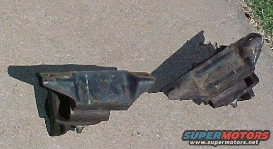

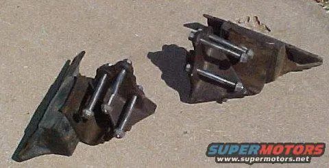

Here is a set of 65's that I recently sold on ebay:
And here are what the 65' rubber mounts look like:
302 coupe said:
pics of said mounts
attachment.php
attachment.php
The first one pictured above is for 11/65 and after convertible mustangs. They have a bolt(nice upgrade), but they don't work on hardtops, the mount is too short(heigth wise) and the bolt holes will not line up on the block, part number for those is 2287. A similar mount, part number 2286, is for hardtops, looks similar but is taller and has no bolt. I have the 2286's and they suck. the other mount shown above is for V8 stangs made up until 10/31/65. They are the post type mount that require the cast iron frame mount. Part numbers for these are 2220 and 2221 for LH and RH sides, respectively.

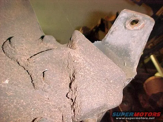

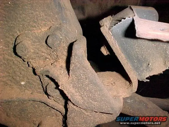

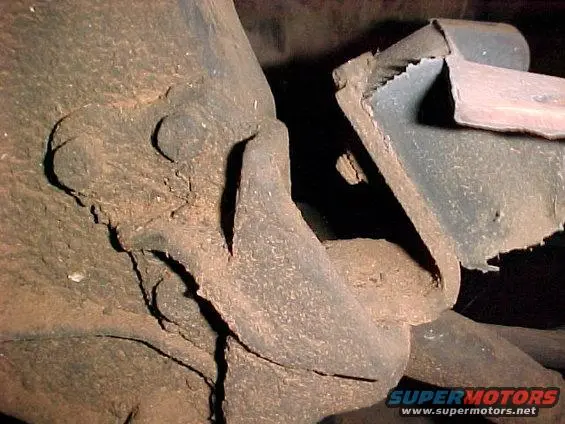

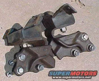

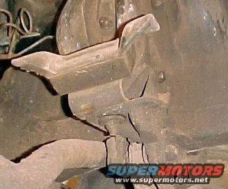

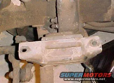

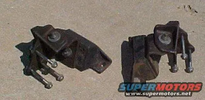

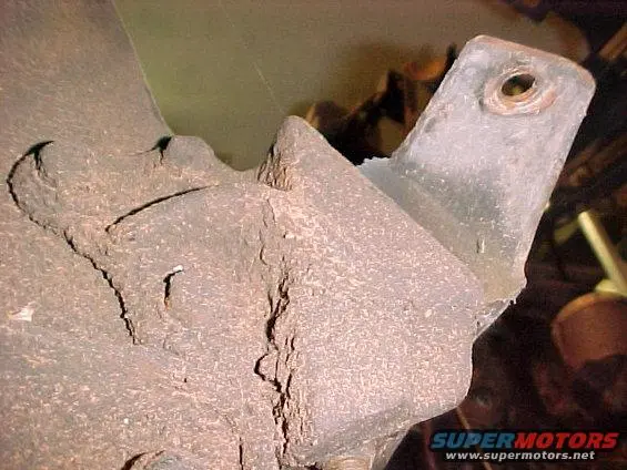

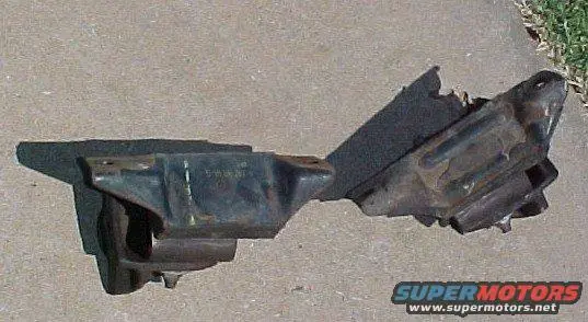

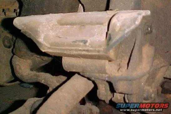

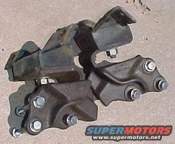

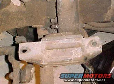

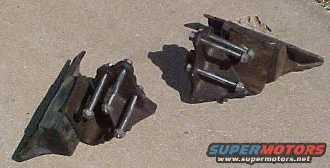

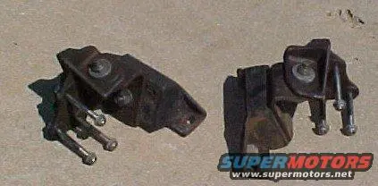

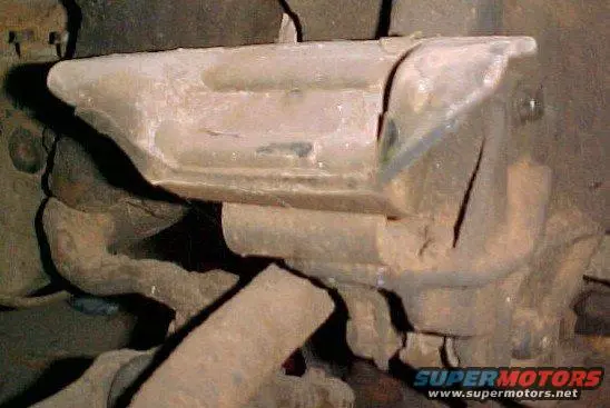

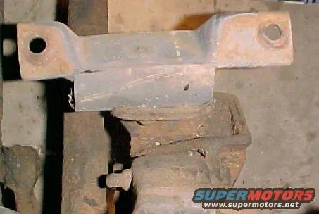

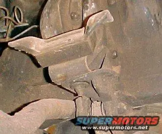

Cast mount pics, both installed and loose. These are the same mounts, dirty and cleaned up.
