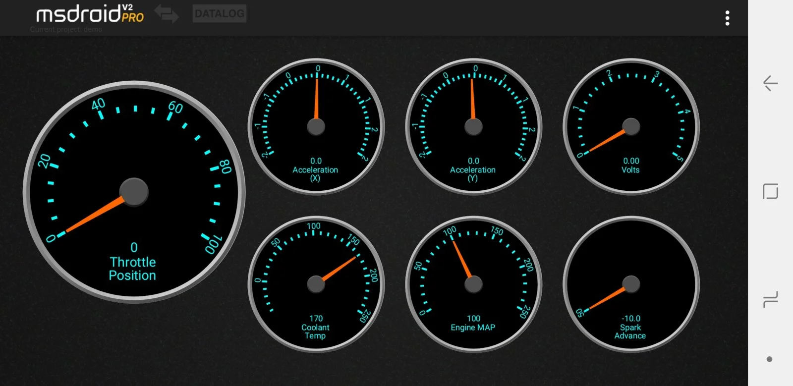

This app has a customizable dash board to display just about anything you want to see from MS. Doesn't have the option to change many colors but there are several different types and the grid layout for placement that we're used to.
It will allow data logging and histogram while driving without having a laptop hooked up. Also, works through bluetooth or cable.

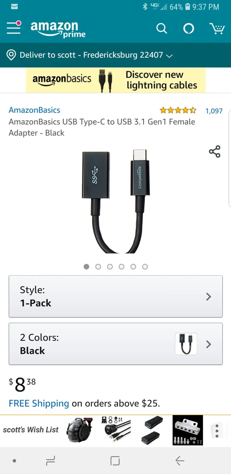

Just found out why my samsung s8 doesn't pick up my mspnp2. There's a usb adapter the plugs into the phone. There was one in the box my phone came in. Since I moved it got tossed or lost somewhere ( I hold onto everything forever...usually )

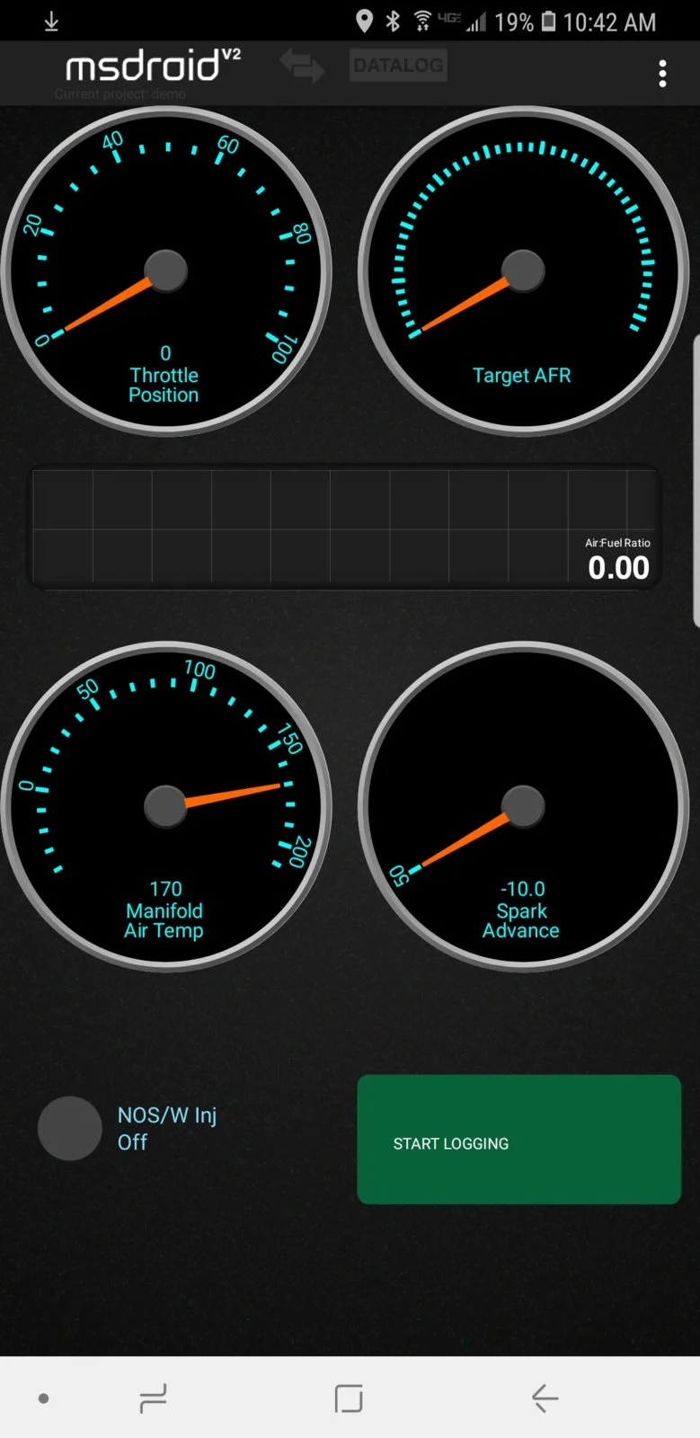

Got everything hooked up this morning. The app is decent. Spent hours building my dashboard but when tune is loaded from MS the dash board goes to default and has to be built again. I guess I spent my time in the demo and not the actual dash board. Response is pretty quick for gauges. I think this will make it simpler to log. We'll see how this goes.

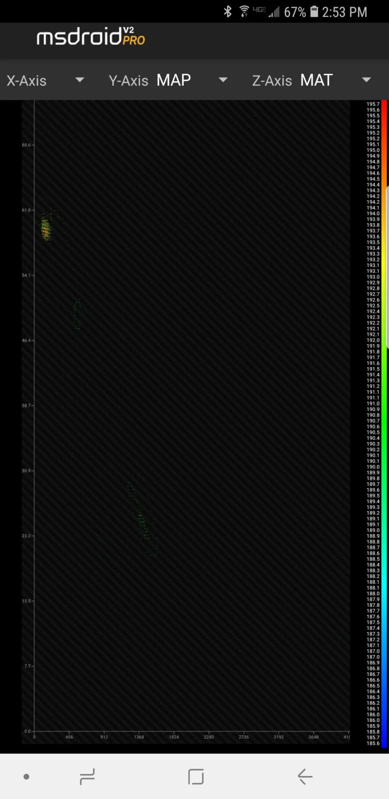

Here's a scatter plot...
There's no scaling available to make it easier to read...no zoom function either.

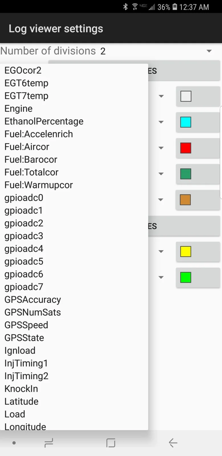

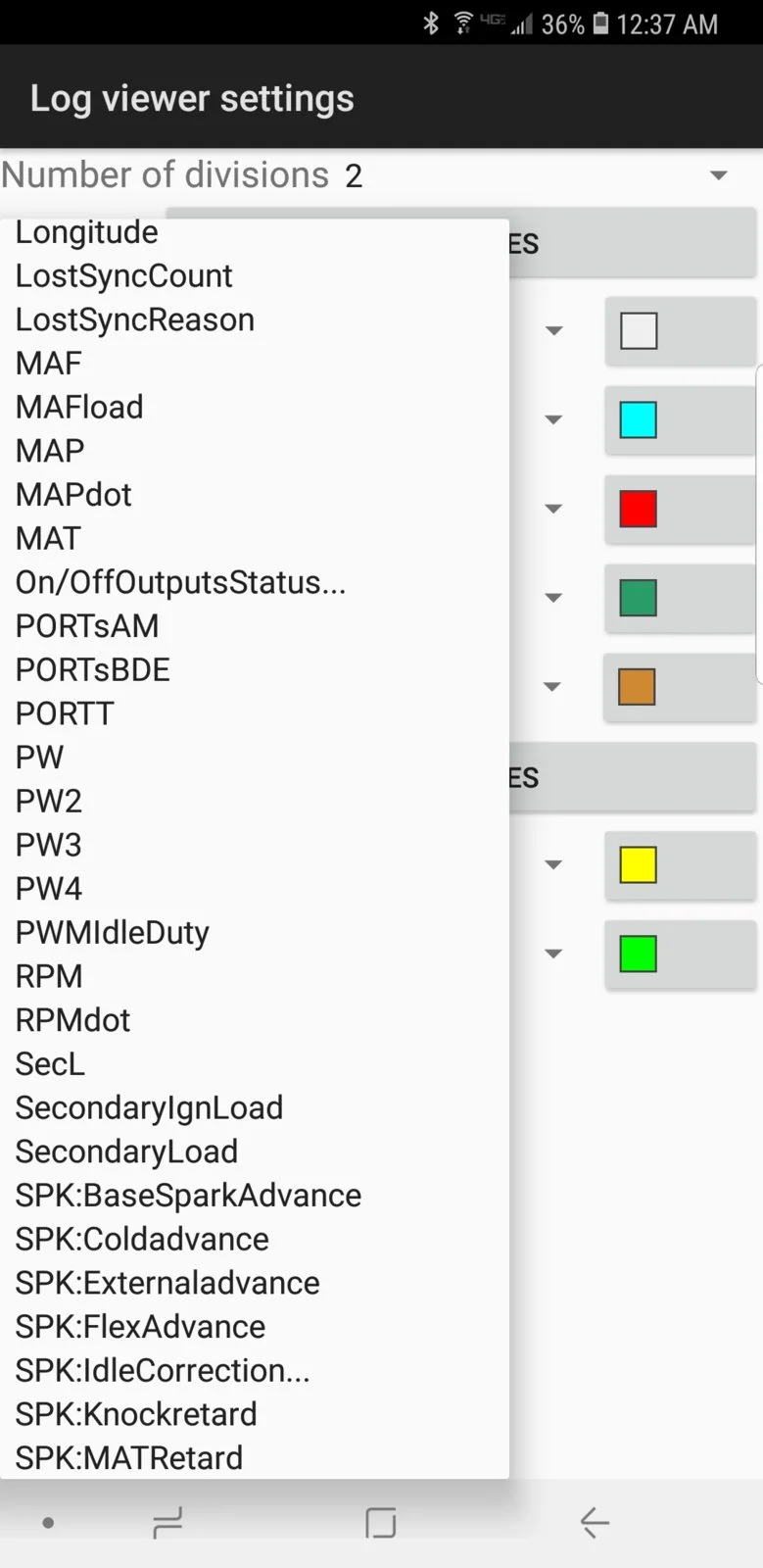

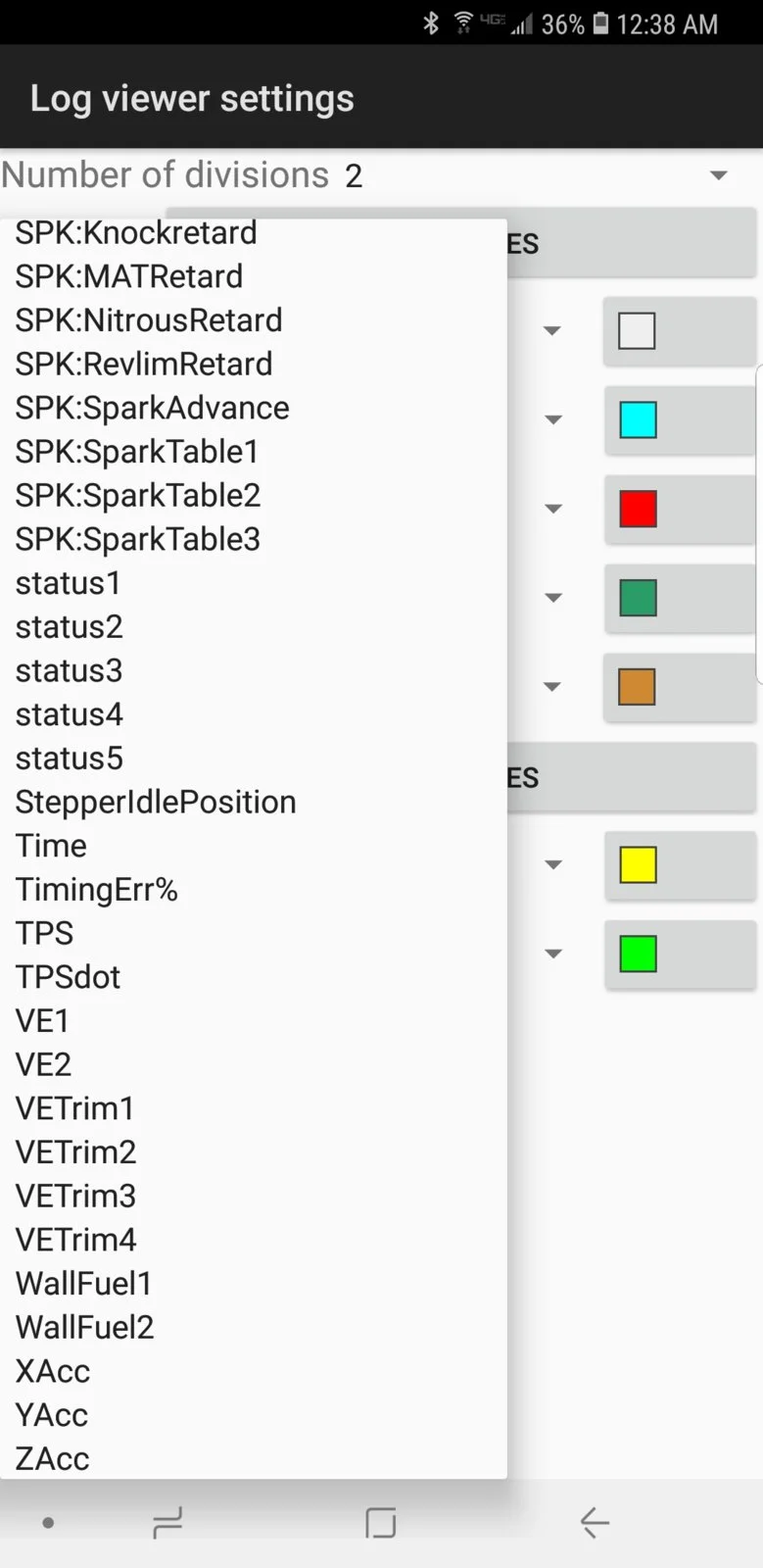

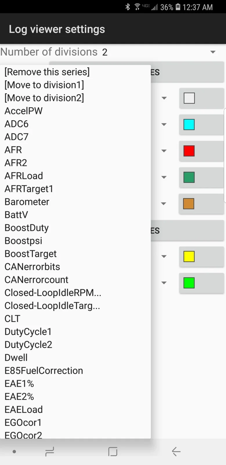

MsDroid doesn't have an in.hg. setting for the data log. ( not one I can find anyways ). Here's the list...
@a91what this is the complete list for the log viewer. If you see something that would give me a true vacuum reading let me know. I don't see anything and vacuum is the most important thing for diagnosing a car. Well....to me at least.
In msdroid you have to use the MAP reading to calculate vacuum. Makes it a bit complicated for a noob like me...

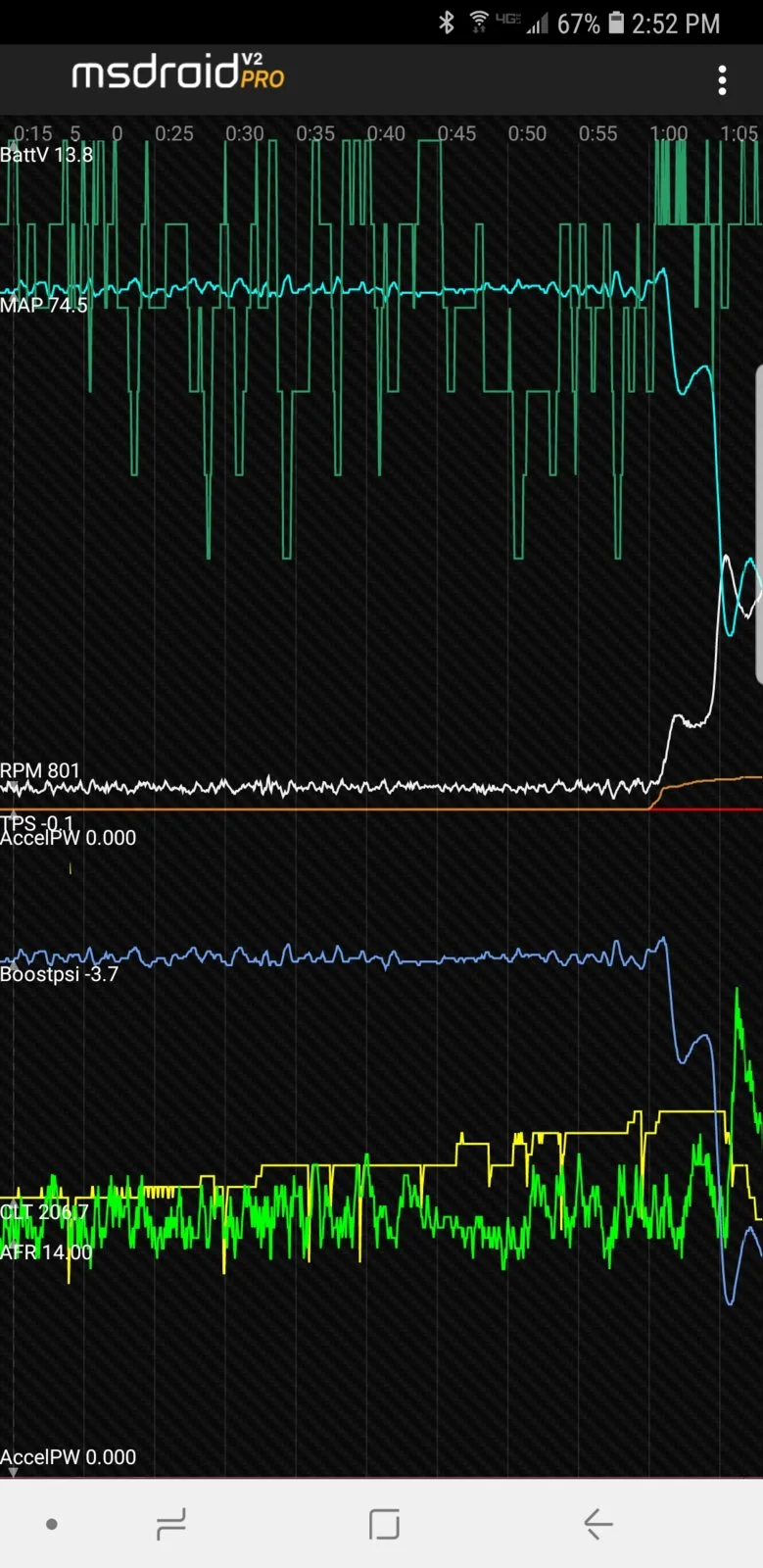

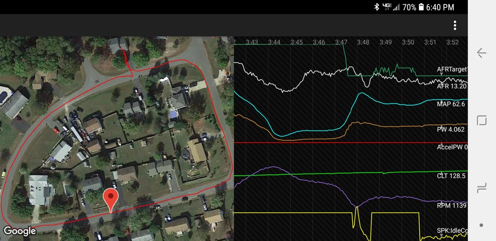

The app has GPS mapping and satellite view...which I think is cool. The app also keeps locking up when trying to view data logs. The only setting that works is scatter plots. This is nee for today. Yesterday it worked. I've sent info to the creators so we'll see what happens.
It's raining today so may not get a driving log done.
Found out I had a parameter listed in my log view that my ECU wasn't communicating. That caused the app to freeze because it was searching for something it couldn't find.

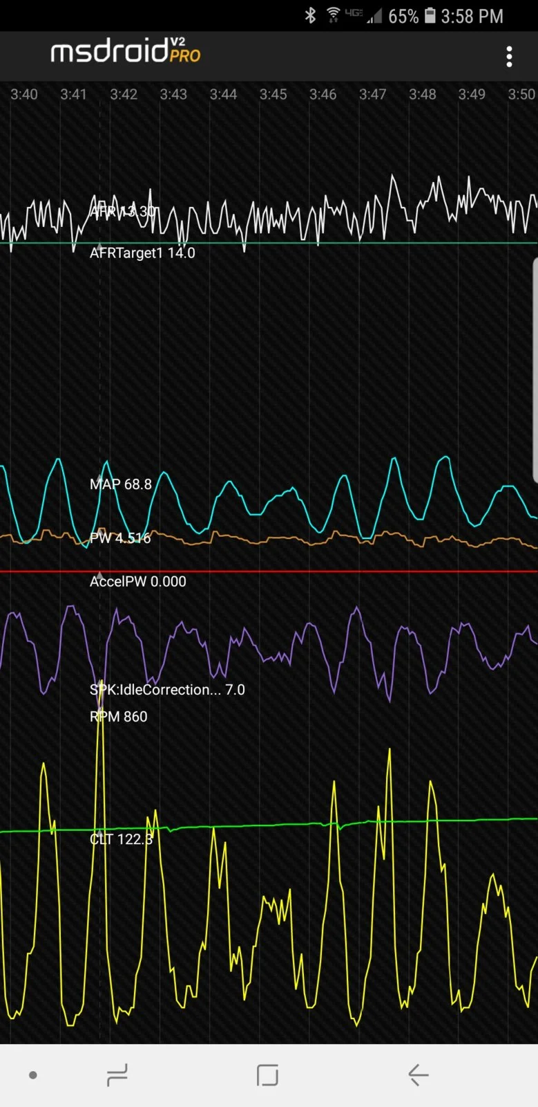

Back up and did a warm up log. My idle spark correction seems a little high with some surging. These th hinges will get smoothed out when Steve gets his hands back on this stuff. Going MAF but it'll take time to get there.
Here's a snapshot of the log. This app has caused me to have a renewed interest in tuning and logging the car. Way easier than pulling out the laptop.
Will still use the laptop to do any real changes but this is ok once you start to understand the glitches. I think it could actually be helpful.
