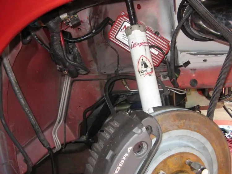

We put mine in the best place of all:
it's tucked nicely in there on the pass side. Then, we put thin plastic sheet across it to keep out any splashing. We had to extend the wires on there but everything seems to be working so far.
