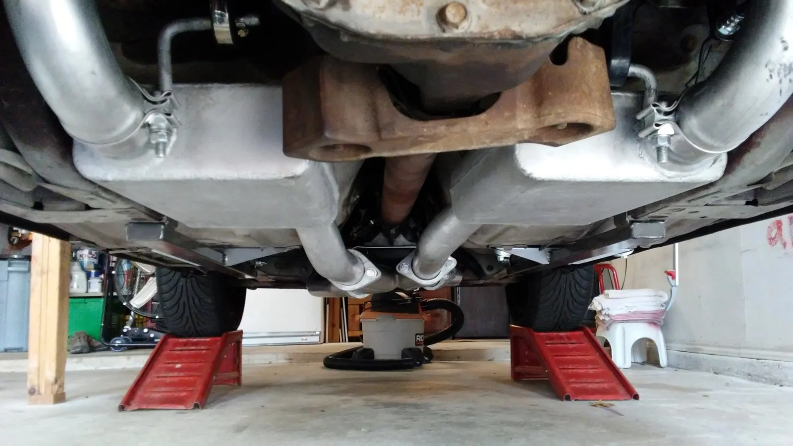

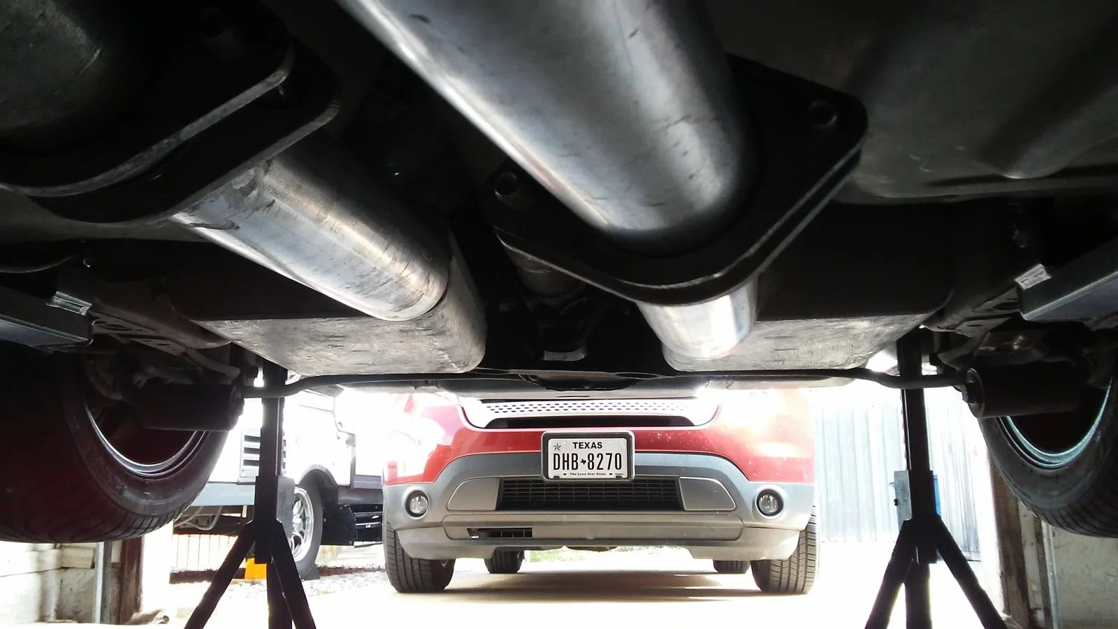

I agree with the proposals above but have been partial to MAC exhaust products since the mid 90's when I outfitted my '83 single exhaust 5.0 with MAC headers, 2.5" cat's and full catback system with Dynomax Turbo muffler's. Back then U bolt clamps were provided which limited flexibility to adjust and swap out components. I loved that exhaust but was never fond of the fitment as it was designed for '86 and above. Over the axle was very tight especially on the passenger side with brake lines and such. I recently upgraded from headers back with MAC 2.5" X pipe, flow path mufflers, over the axle pipes and 3" chrome tips. Muffler flow tubes are welded and over the axle connects with clamps. I used Walker 1" band clamps which worked well. All other joints are ball and socket which allow for adjustment and quick removal. The flow path mufflers are about an inch smaller in all dimensions than the Dynomax Turbo's I had before. With the adjustable tips, I can make both sides symmetrical and it looks and sounds great. I was able to install the entire system with front tires on 8" ramps and back axle supported with jack stands. Of course having a low profile creeper at my age is mandatory. Downside is the MAC stuff is probably pricier than some will want to pay.
