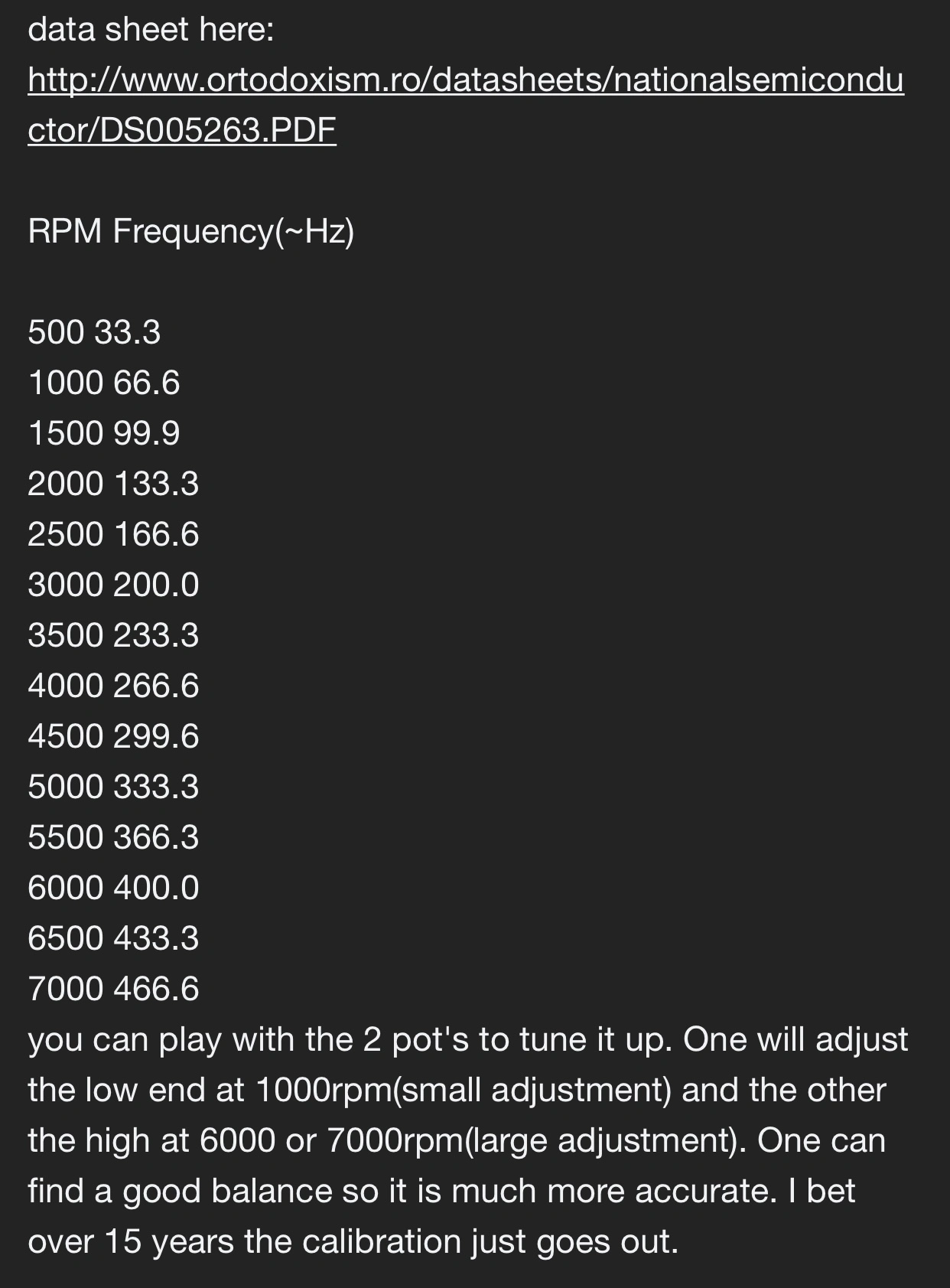

Maryland Stang said:
Here is the info borrowed from 89ragtopgt at corral.net. All credit goes to that person...
Apparently you can use tone generation software that you can download onto your PC or laptop. Install the software and use a 1/8" plug on your sound output connected to wires that are connected to the
signal input on the back of the tach.
I have downloaded the tone generator software and setup the table of frequencies used to calibrate the tach. The next step is to use a frequency counter to see how accurate the tone frequencies genterated by the computer are.
I will keep y'all posted as to my progress...

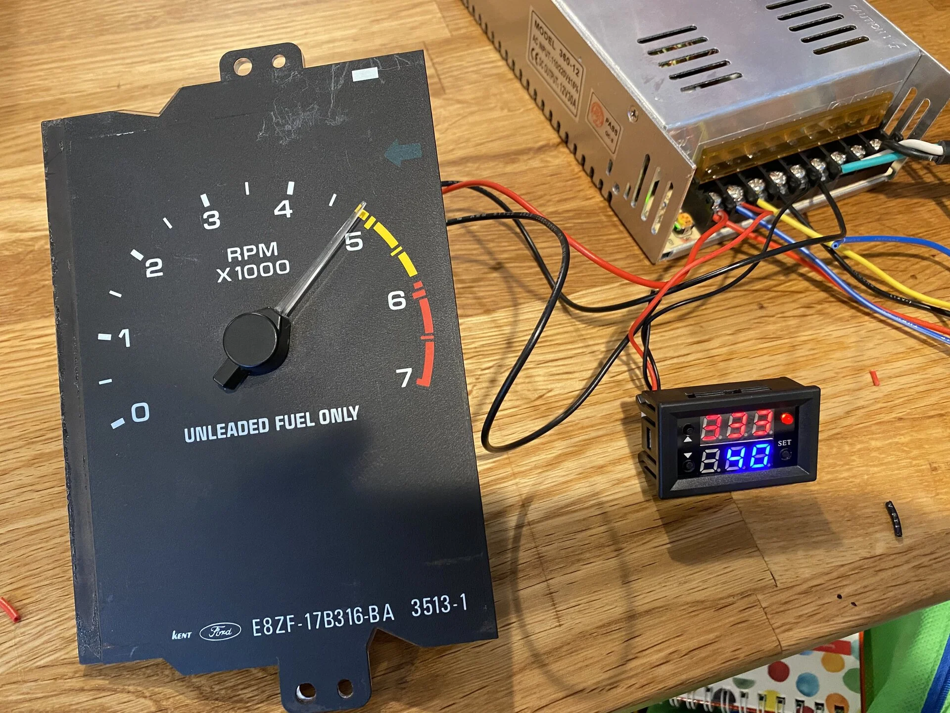

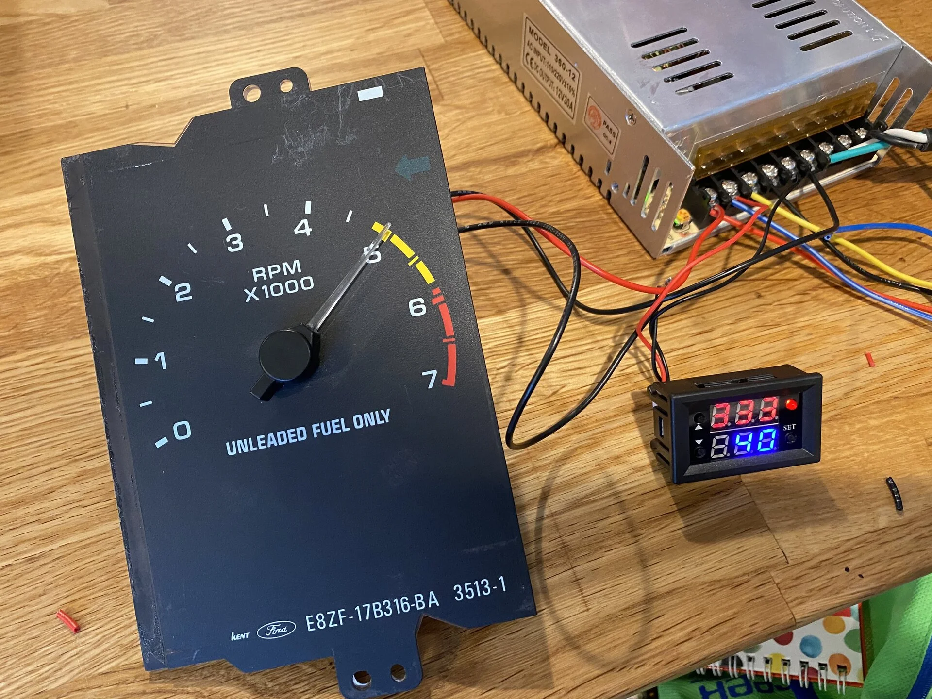

Well it works. My little $13 ebay frequency generator did the trick.
set it for 5k rpm and was slightly under.
slight tweak of the pot and spot on
it’s linked earlier, but here are the values.
Reactions: 7991LXnSHO

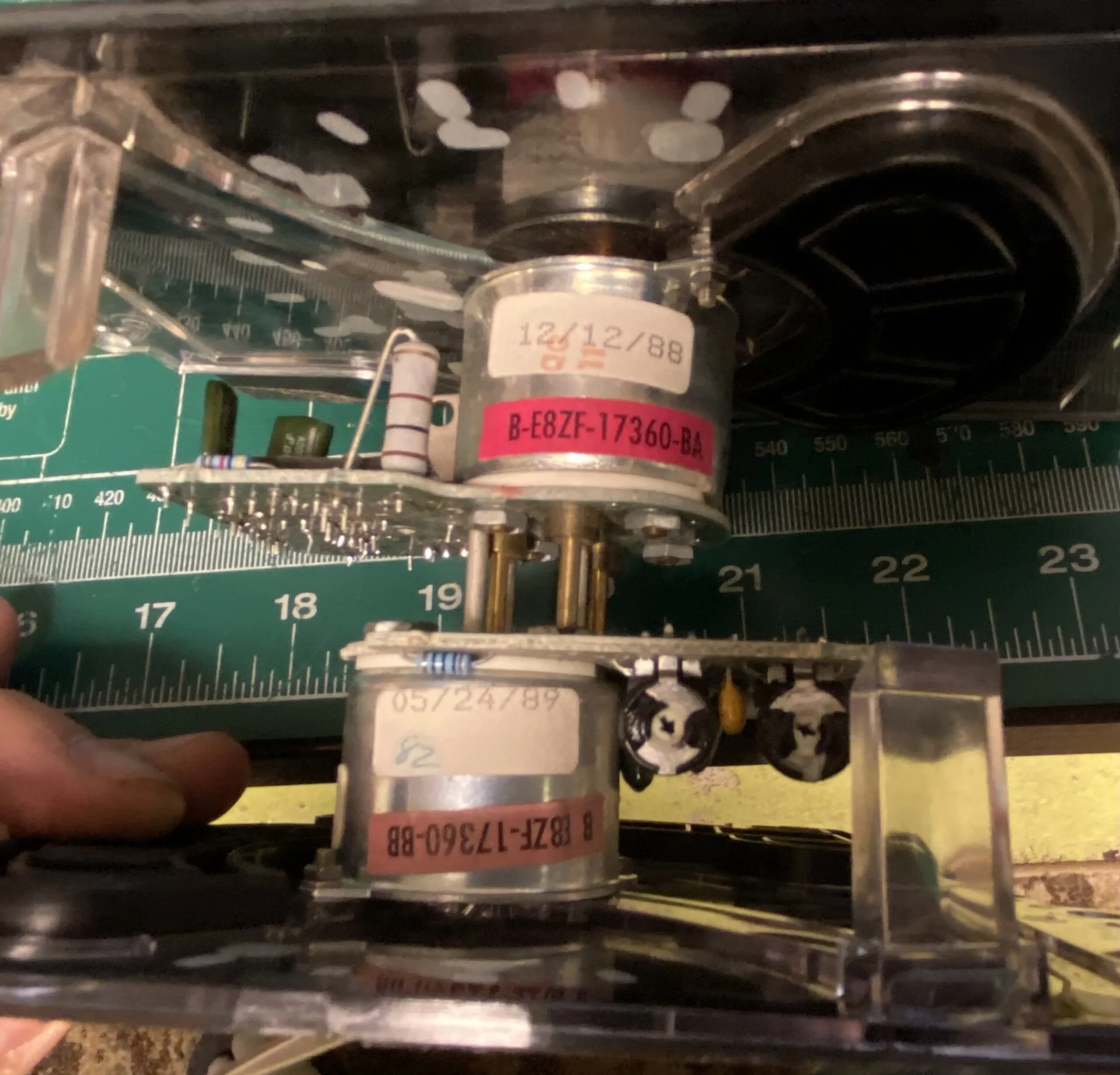

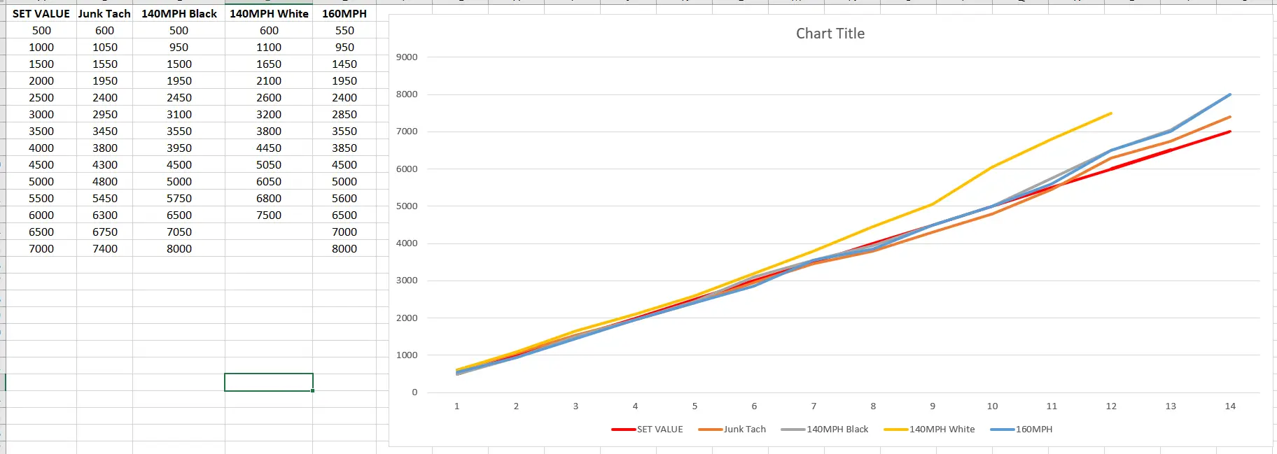

BTW,
The tachs up to early 1989 only had one pot of adjustment. The late 89 and later tachs feature two pots. One for low range, and another for high range.
Here's an example I did of 4 factory tachs I had on hand.
Three are untouched from Factory, but the orange plot is one tach (with single pot) that I played around with and made some adjustments. As you can see I've gotten it better than the three untouched units.
And here's the difference in 1989 tachs. One is early, and one is late. You can see the single pot on the far side of the early tach, while there are two pots on the later model. I believe the outer pot adjusts the high end of the range, and the inner pot adjusts the low end. They affect each other, so my technique was to adjust the high end, and then go to the low end and tweak. Make small adjustments.
