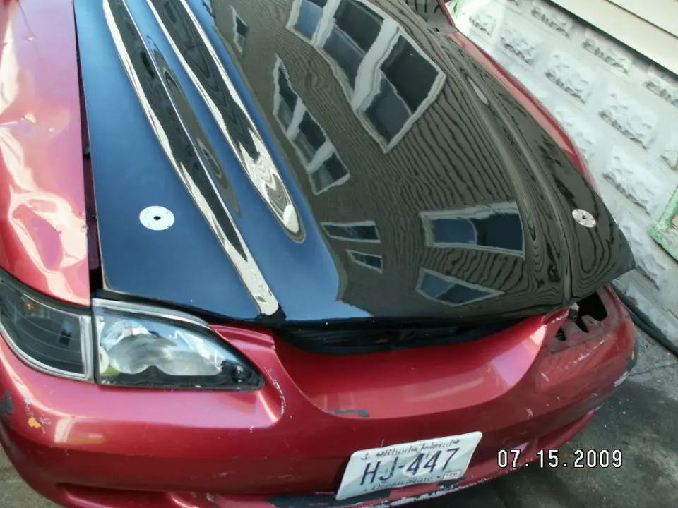

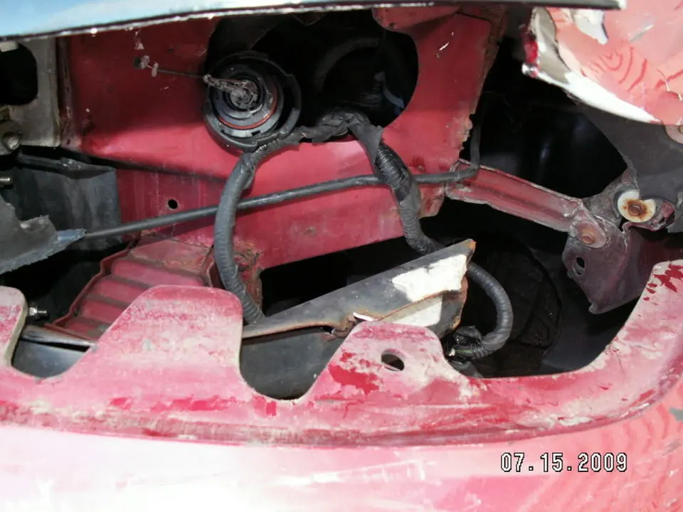

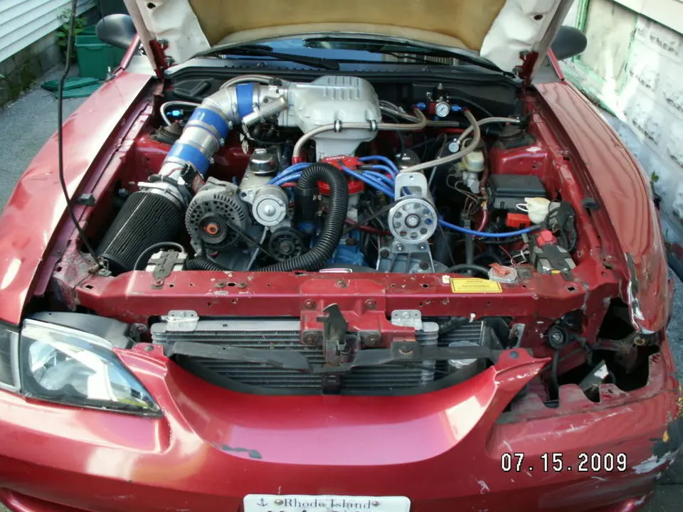

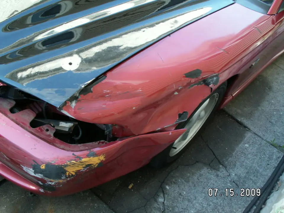

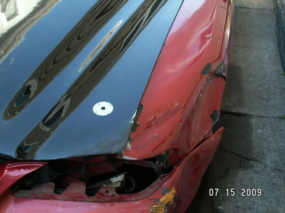

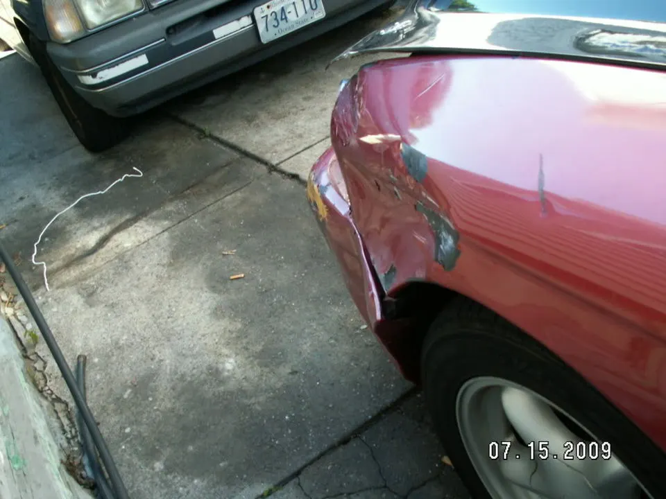

So im driving on a 2 lane road in the right lane. Some idiot decided to come from the left lane last minute to take the 95 south on ramp to my right. Slammed on brakes. but he was only about 30 feet infront of me when trying this.
So my nose is shifted slightly to the passenger side. Radiator support pushed. and obviously i now need fenders and lights now.
Do you guys recommend having it pulled? Or Replacing the radiator support and frame/ Aprons like here. ~~~>http://cgi.ebay.com/ebaymotors/ws/e...TRK:MEWAX:IT&item=120355963706#ht_9907wt_1185
What would be more cost effective as well??? Rebuilding another car isnt really in my options right now...that would be a hell of alot of work.
My buddy does professional Auto Body work...Most of the cars he does are 60k and up vehicles. Porsche, BMW, Mercedes. Only thing is he does't want to give me a price until i shop around first. I know it would be expensive....but i figure if i change the front frame work this would eliminate the very costly frame machine part of the process. I can handle bolting things like a k member in and other random parts which would reduce the labor he would charge me to welding the front frame in and hanging fenders.
And now for the carnage.......

When stuff on a car gets pushed sideways theres a whole lot of bent stuff. Even the top of the radiator support is bent more than it should be. Thats why i figured why not rip it all out. and weld in a fresh piece.
THAT is not bad at all! I would have a frame shop "pull" that front-end. Does your buddy do that or know someone that would give you a good deal? After that, it's just a matter of hanging parts and that's easy.
Before I'd R&R that front subframe, I'd just swap all of the good stuff over to a good body shell. I think that once a car is apart like that, it will never be the same. Of course, it prolly wont be the same after being pulled, either.

Yeah liability which is making me rethink that one....I think im going full coverage from here on out. The Radiator support needs replacing and also the Bumper reinforcement if im going to keep it as is. But my buddy is making the frame machine sound like major work. Its tweaked over about an inch. I havent even tried opening the passenger door because it will hit the front fender.

I think it can be pulled. If the car still drives straight, then it's probably only bent fwd or the a-arms. and that's really minor.
Not sure about that. The passenger door makes contact with the passenger front fender So i haven't tried fully opening it. It def looks like everything slightly shifted from the firewall forward...Im tempted to swap the whole front frame and get a better result then trying to straighten bent metal.
dosent look too bad.
the pass fender may have just been pulled to the side,not the whole frame.
pull the fenders,then you can tell how straight the frame is.

I contacted a friend the one that works at the body shop....he said hell put it on the frame machine and hang all the parts for $1200....But i have to buy the reinforcement bar, Header panel, Rad support, Front fenders, Bumper. I was looking at parts on ebay....so im probably looking at a total of $1600
Passenger fender was dented prior to this accident...I bought the car from someone who had his chick go off on the car.
When i popped the hood i could def tell the Apron wasn't where it was supposed to be. They will be removing the bent rad support and taking measurements. I guess he says theres a book that has all the distances of frame related parts.
