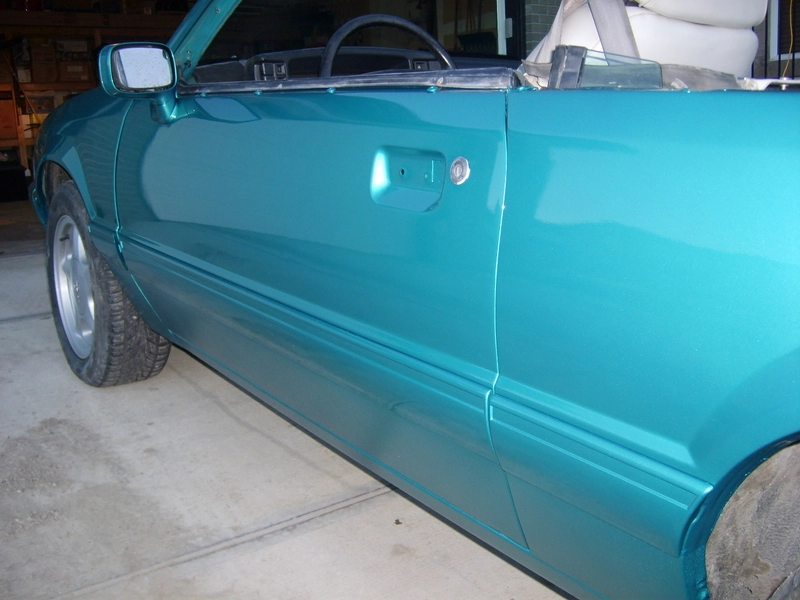

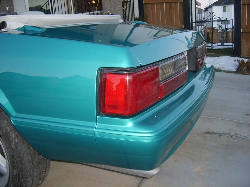

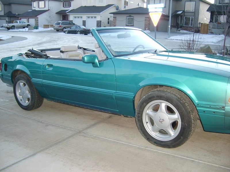

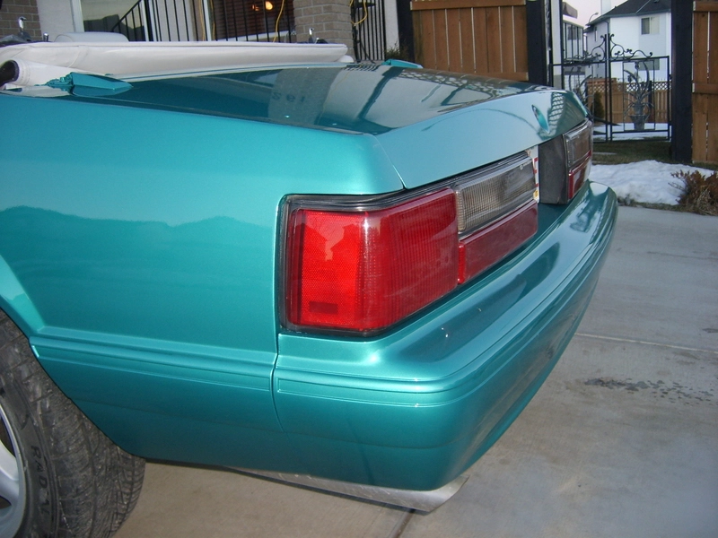

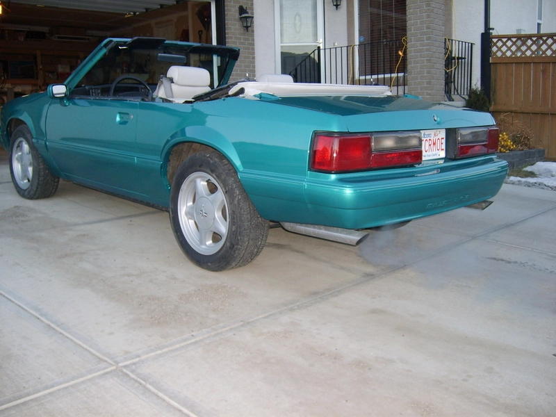

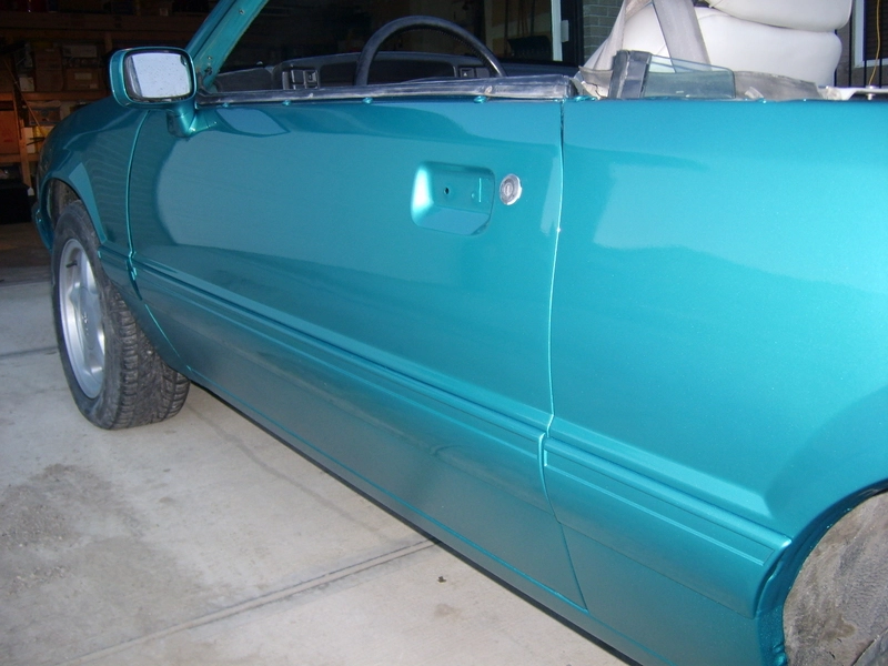

Find the orange peel now HAHAHAHAH. Notice the color difference between the booth lights and sun light

I still don't know what orange peel is... anyone care to elaborate for me?
haha sorry for takin the thread
Look at the top pics when his car is in the paint booth. Look at the reflections in the paint, see how rough they are. That's the orange peel, it's not smooth. Looks like an orange peel, hence the name. Every paint job in the world has it to some extent. Wet sanding and polishing will remove it.
