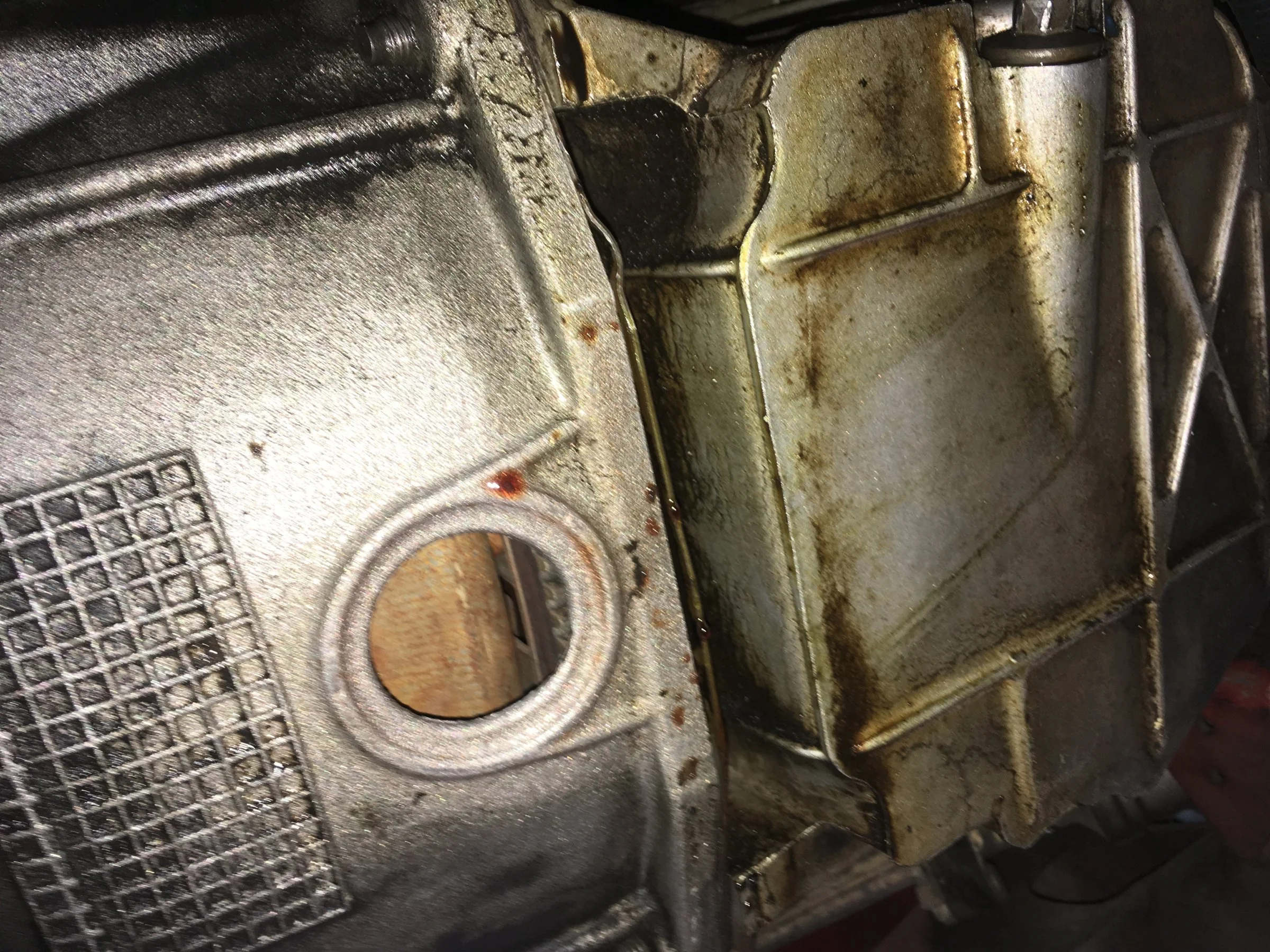

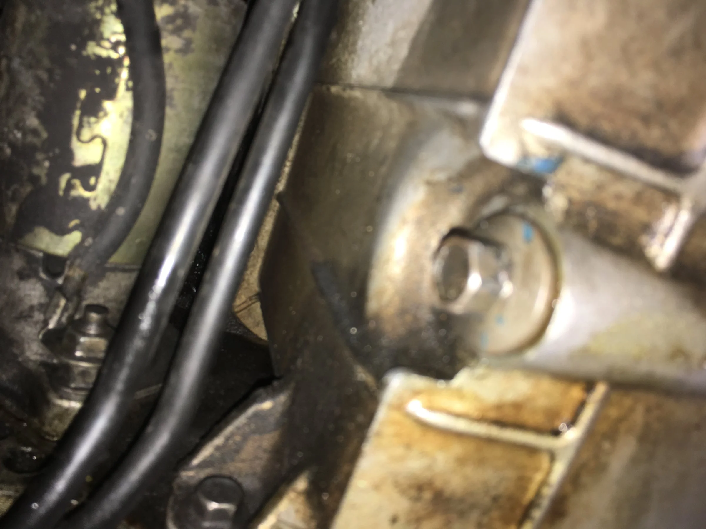

R Remy11 New Member Feb 1, 2017 16 0 1 Feb 8, 2017 #1 Feb 8, 2017 #1 can somebody tell me where these leaks are coming from in the picture i have below? Attachments IMG_0870.webp 736.3 KB · Views: 204 IMG_0871.webp 170.3 KB · Views: 193
RaggedGT Been here over a DECADE and still no CT Mod Dude Jul 20, 2014 4,741 3,192 203 Taylorsville ky Feb 8, 2017 #2 Feb 8, 2017 #2 Oil from the rear main seal?(maybe) ATF from the pump seal? Or the dipstick tube?- all just guesses, i'd clean it up the best you can with degreaser and towels, and then just monitor it for the next few weeks and see where it's wet

85ragtop BTW, I like dudes. 10 Year Member Nov 29, 1999 823 475 123 NC Feb 9, 2017 #3 Feb 9, 2017 #3 What kind of vehicle?
R Remy11 New Member Feb 1, 2017 16 0 1 Feb 11, 2017 #4 Feb 11, 2017 #4 85ragtop said: What kind of vehicle? Click to expand... 2000 mustang 3.8l v6
85ragtop BTW, I like dudes. 10 Year Member Nov 29, 1999 823 475 123 NC Feb 11, 2017 #5 Feb 11, 2017 #5 Moved to sn95 tech for you. It will get more traffic here.
Noobz347 Stangnet Facilities Maint Tech... Er... Janitor Admin Dude Jan 4, 1985 43,200 21,374 234 Box behind Walmart Feb 11, 2017 #6 Feb 11, 2017 #6 I couldn't tell you one lawn mower from another with those images. If that's oil, it's probably coming form your rear main. If not, then the front transmission seal.

85ragtop BTW, I like dudes. 10 Year Member Nov 29, 1999 823 475 123 NC Feb 11, 2017 #7 Feb 11, 2017 #7 It looks like trans fluid and oil. So more than one leak I would assume. How many miles are on it?
R Remy11 New Member Feb 1, 2017 16 0 1 Feb 12, 2017 #8 Feb 12, 2017 #8 85ragtop said: It looks like trans fluid and oil. So more than one leak I would assume. How many miles are on it? Click to expand... About 100000
85ragtop BTW, I like dudes. 10 Year Member Nov 29, 1999 823 475 123 NC Feb 12, 2017 #9 Feb 12, 2017 #9 As stated before it could be a number of things. Clean it up good and drive for a bit then check and see. If all else fails use some UV dye.
