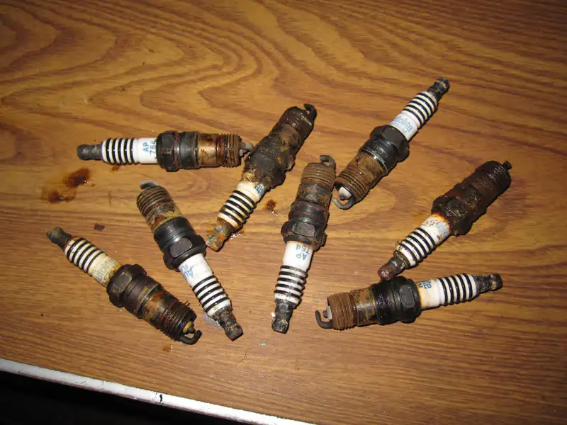

Soooo I found out why my car was missing
Threw in some new NGK's and it's running like a top. Thanks for the suggestions guys.
