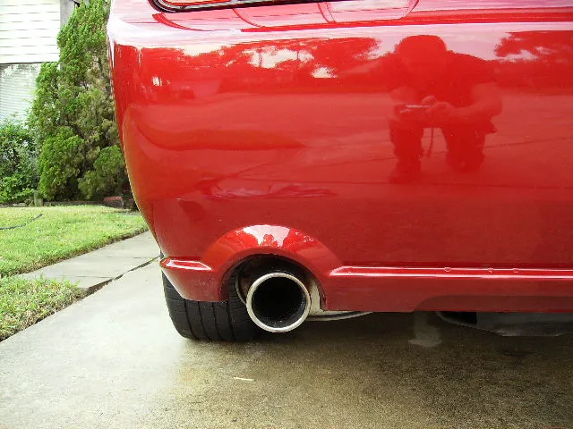

I kept my stock and went to Walmart and bought two of their chrome tips 3", had the muffler shop cut my old ones off and weld walmarts on. Cost 25.00 for the tips and 25.00 to weld them on.
I didn't like the small stock tips.

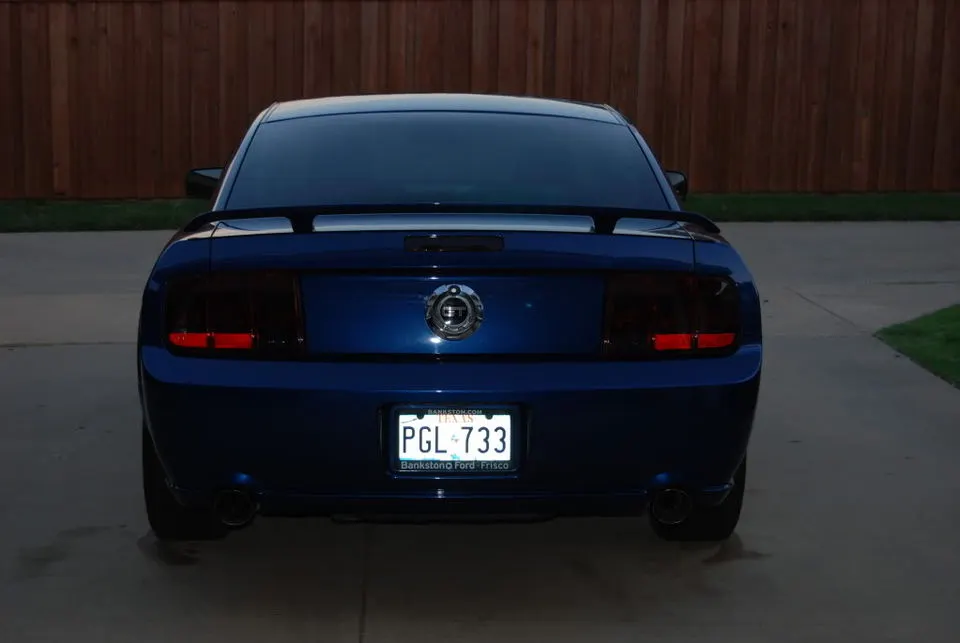

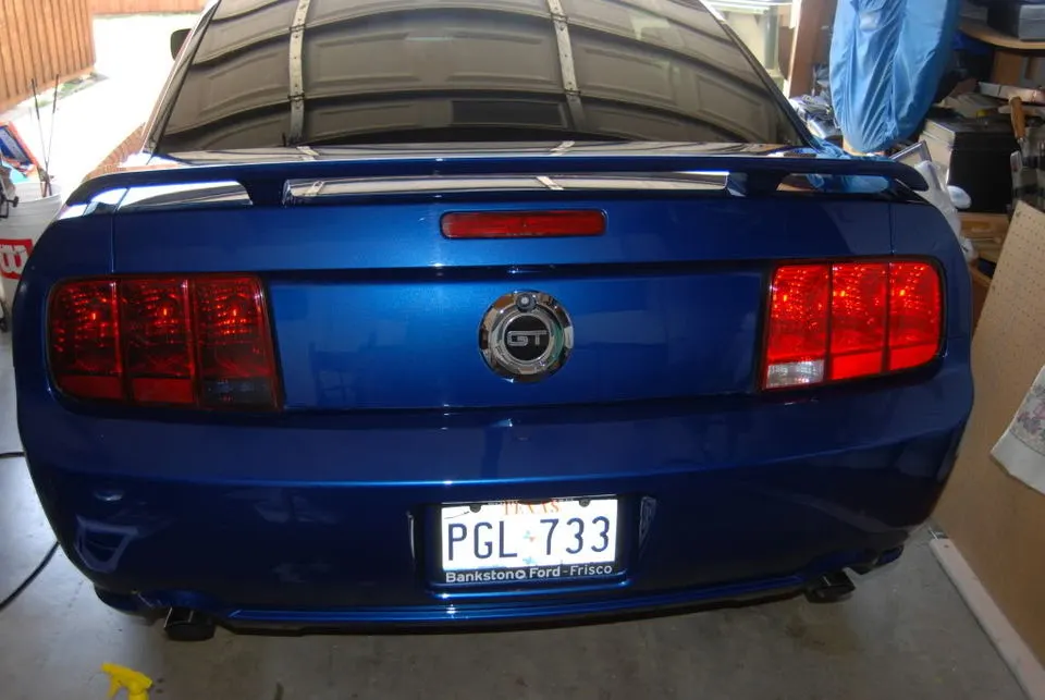

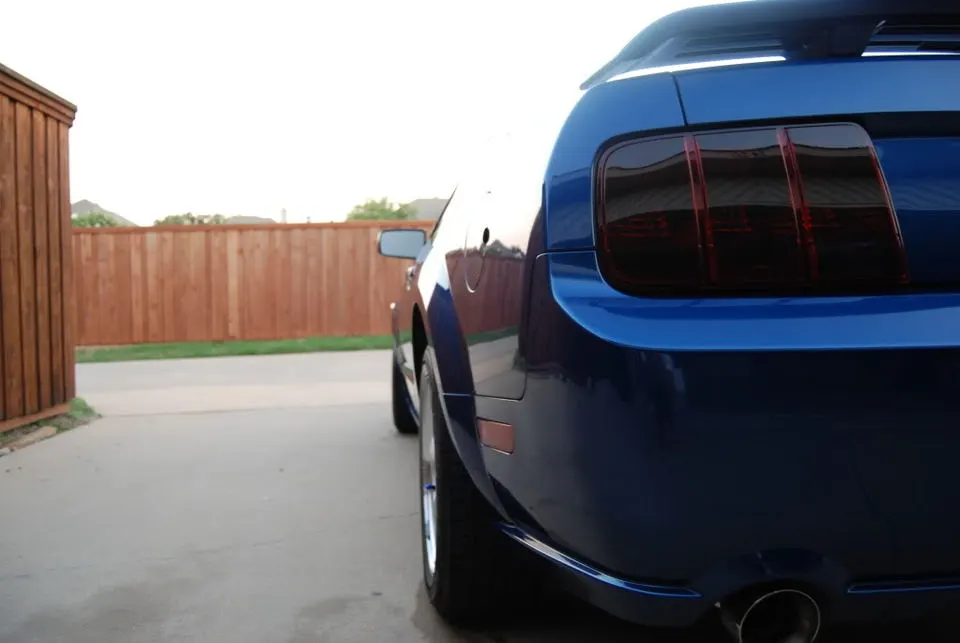

I tinted ALL of my lights this last week. I will take pics today. I ordered a Bulk roll of tint film from Lamin-x for 150 bucks, it was 18"x15' I tinted EVERYTHING on my car and still have a TON of film. Each set of lights precut kit is like 60$ so just tinting 3 sets of my lights more than paid for the bulk roll I bought. I am cleaning the car today, I will take pics for you. It is a little tricky doing the tails with film cause of all the curves and edges, but a blow-dryer that has a hot setting will help tremendously.
I took a couple quick pics. I am very please with how they turned out. They look a bit darker in pics, You can still see a slight hint of red through the film and you can still see the chrome reflectors of the headlights some. At night the lights shine through perfectly, during the day you can see the brakes no problem as well.

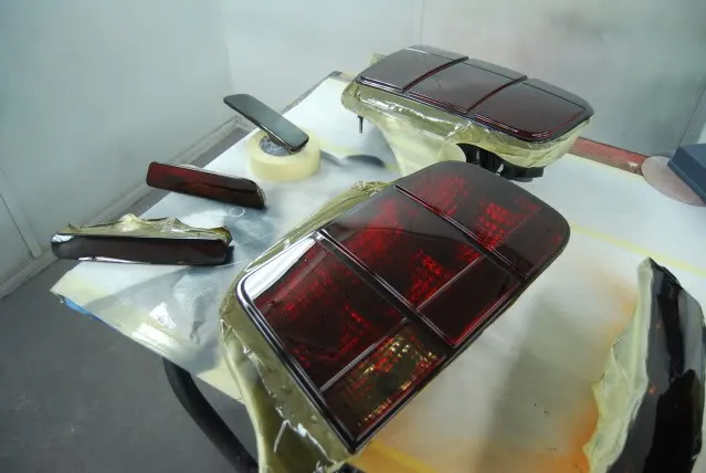

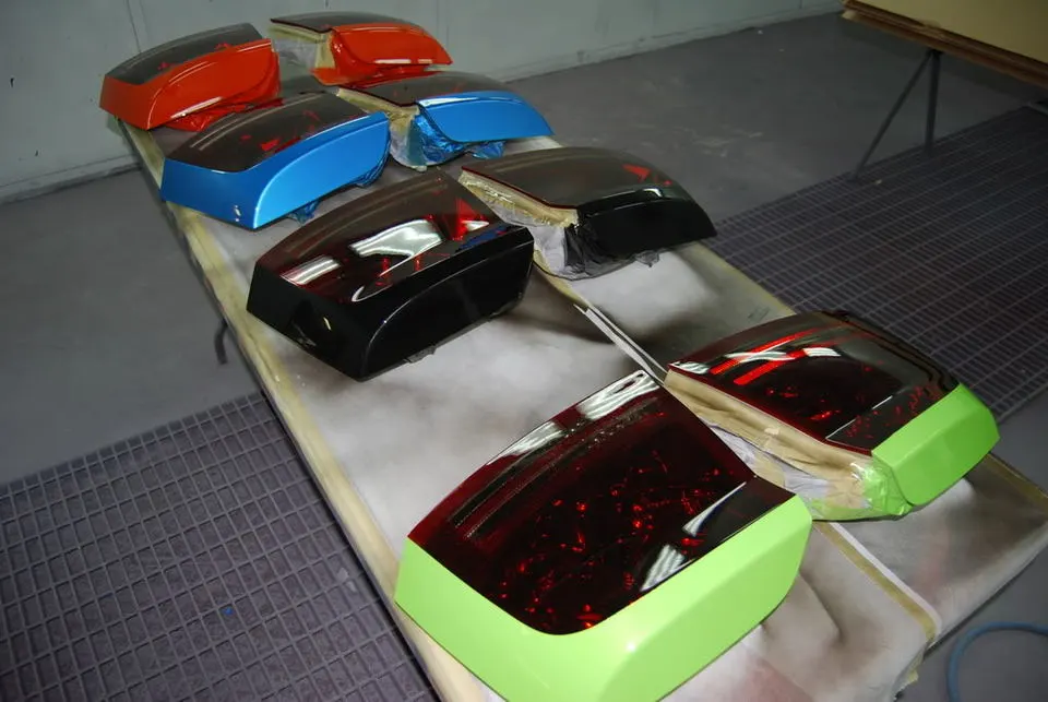

At the place i work, 402 motoring, we've been spraytinting taillamps for years. If you do have them sprayed i suggest doing it at a real nice, licensed place with a spraybooth, not some backyard operation. legality varies per state, often it is a grey area, we have cars all across the country and haven't heard about people being hassled (windows you'll get tickets almost weekly, but no trouble with lights).
Whatever you do, and whoever you go with PLEASE don't spray them with the VHT spray cans, no offense to anyone here that may have them but i have NEVER seen those that don't look terrible. they may look good enough on a $500 93 dodge spirit, but not a $15,000 mustang.
I've seen film go both ways, some real nice film jobs and some real poor ones. If people have good reviews from the American muscle stuff that should work well for you

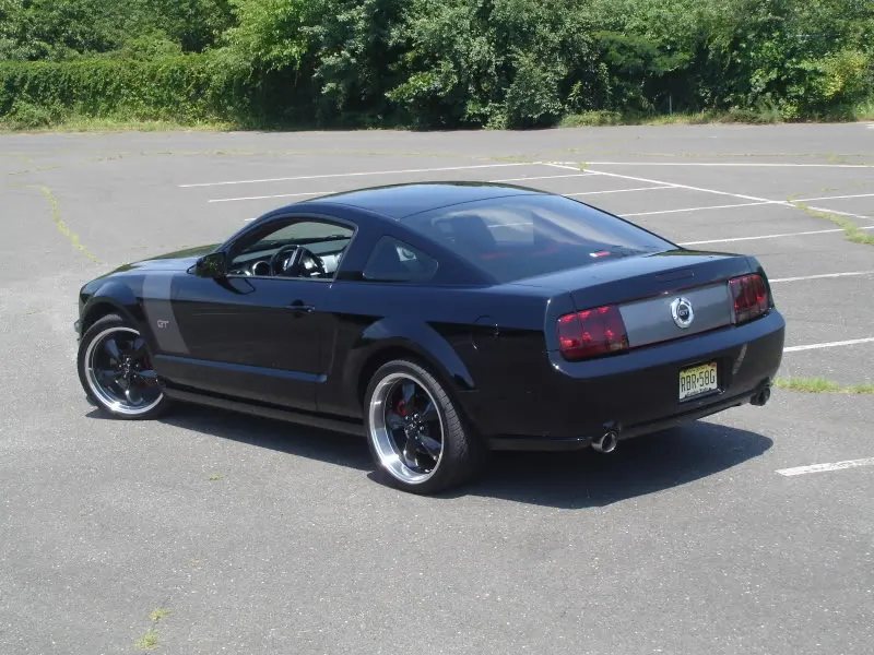

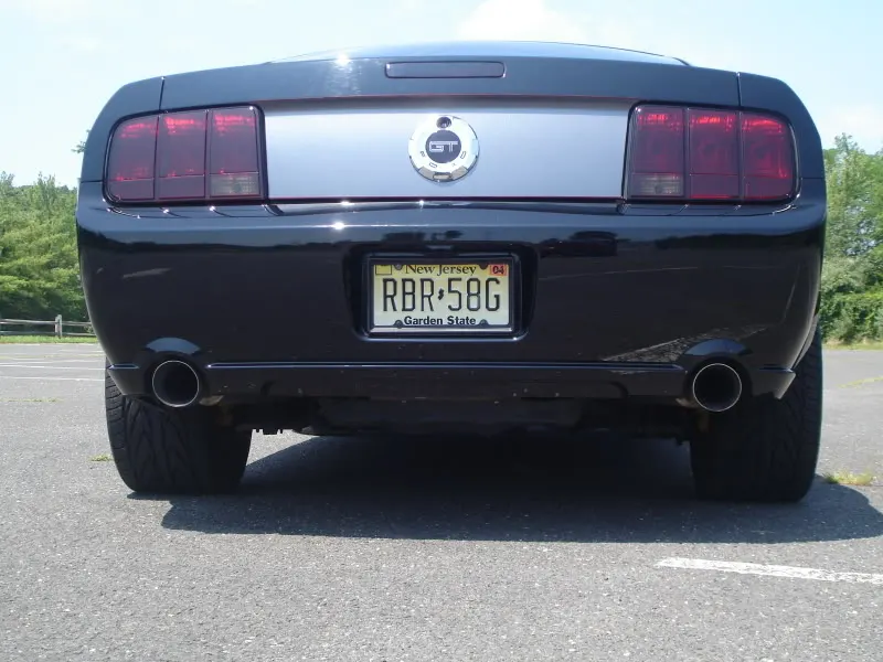

here's mine.....
i've got medium on the tails, and dark on the 3rd light and sidemarkers. made a world of difference on how my car looks. they're all sanded, shot with the tint, cleared, then buffed. with paint you could also paint parts of the lights to match (like the low parts between the lights) We paint large parts of charger lamps and it makes them fit the car much better

That's a pretty cool paint scheme there Infamousjim. Silver panel with a darker/black car.
thanks, the striping was actually done by the previous owner, who had a few posts here. (i just did alot to finish, pinstripe, new bumper, shaving spoiler, etc)
