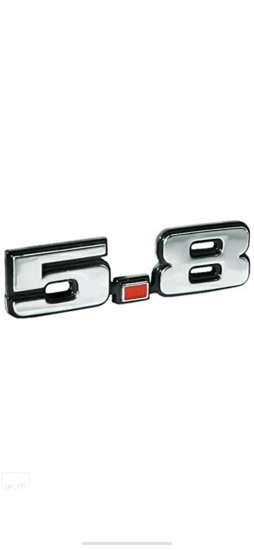

Thanks for your response..... I am sure ( years ago) I went by a newer mustang on a parking lot ( 80's on up car) that had a 5.8 fender emblem on it... This was when I knew NOTHING about mustangs ( I still know very little) and it always aroused my curiousity....
They sold 5.8 emblems that were the correct font and script for the factory 5.0 emblem. I saw cars had them when the 5.0 was pulled out and it was swapped to a 351W so that is what you may have seen.
Reactions: limp
5.8 badge
Reactions: limp
