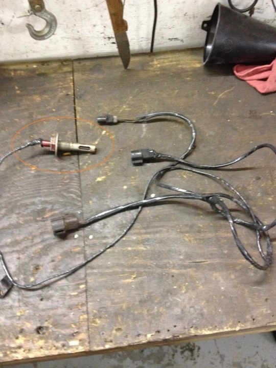

Not sure what this is or where it goes but its on the O2 sensor part of the harness:

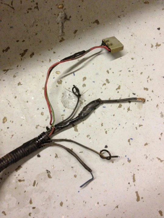

Next is a few wires that have no plugs, just bare ends. These wires come right out with the ignition coil plug. Not sure where or what these wires are for:

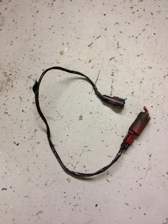

Not really sure what this thing is or where it goes or if I even need it...

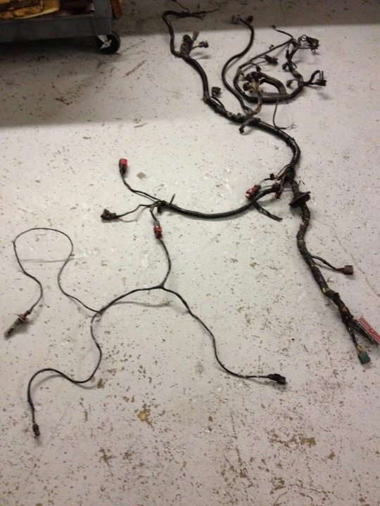

And here is the whole harness. Looks to be complete.

The first picture is the low oil sensor that goes into the side of the oil pan. Im unsure on the others

The last one is the EVAP purge solenoid. Should be a vacuum line that comes from the charcoal canister to that, then from that to the upper intake manifold.

Well thats getting thrown away LOL

Do I even need this? I mean, I monitor oil pressure and every car I have ever driven in my never had a low oil light, even my brand new car lol. I think I just answered my own question. REMOVED!

After searching, I found a 93 harness and it looks like the 4 wires next to ignition coil plug are could be: A/C clutch 2 pin connector (black/yellow and black/white), EEC ground, 20 gauge fusible link to starter relay. So in the pic the 2 tires tied in a not are A/C, the stripped blue copper wire is the ground and the fusible link wire goes to starter relay

Charcoal canister plumbing - one 3/8" tube from the bottom of the upper manifold to the rubber hose. Rubber hose connects to one side of the canister solenoid valve. Other side of the solenoid valve connects to one side of the canister. The other side of the canister connects to a rubber hose that connects to a line that goes all the way back to the gas tank. There is an electrical connector coming from the passenger side injector harness near #1 injector that plugs into the canister solenoid valve. It's purpose is to vent the gas tank. The solenoid valve opens at cruse to provide some extra fuel. The canister is normally mounted on the passenger side frame rail near the smog pump pulley.
It does not weigh but a pound or so and helps richen up the cruse mixture. It draws no HP & keeps the car from smelling like gasoline in a closed garage. So with all these good things and no bad ones, why not hook it up & use it?
The purge valve solenoid connector is a dangling wire that is near the ECT sensor and oil filler on the passenger side rocker cover. The actual solenoid valve is down next to the carbon canister. There is about 12"-16" of wire that runs parallel to the canister vent hose that comes off the bottom side of the upper intake manifold. That hose connects one port of the solenoid valve; the other port connects to the carbon canister.
The purge valve solenoid should be available at your local auto parts store.
