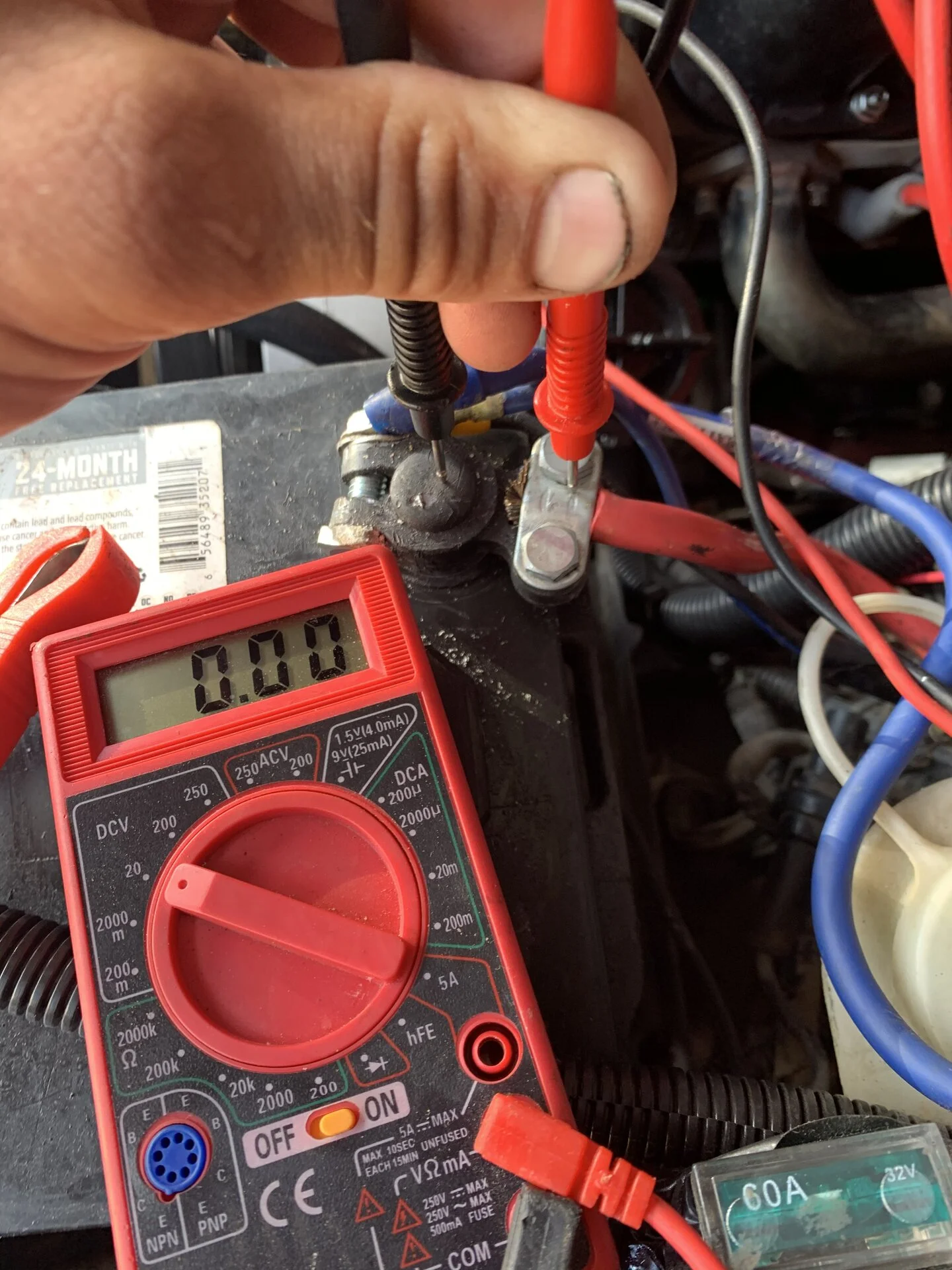

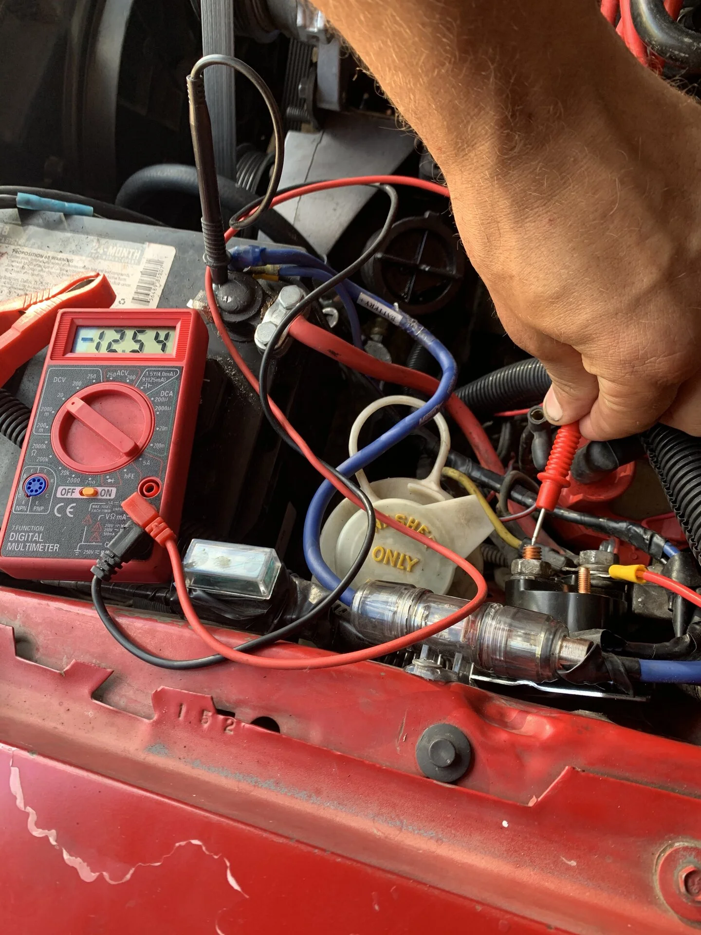

Pic #1 shows O volts between the batt post and the cable clamp, pic #2 shows 12+ volts between the batt post and the solenoid stud, this tells me and this an observation from pics, that pics #1 shows a bad connection, now pjc #2 shows a complete circuit so that tells me either pic #1 is operator error or a loose/bad connection at that clamp.
This is only an observation based on pics and written word,

0 volts between between the battery post and the cable clamp is good. The less voltage drop between connection points, the better the connection is.
12 volts between the battery cable clamp and the solenoid terminal is bad - that is a classic open circuit. Replace the short cable between the battery and the solenoid.
You should never use a cable clamp on a battery wire unless it s a very temporary repair. Replace the cable assembly as soon as possible.
