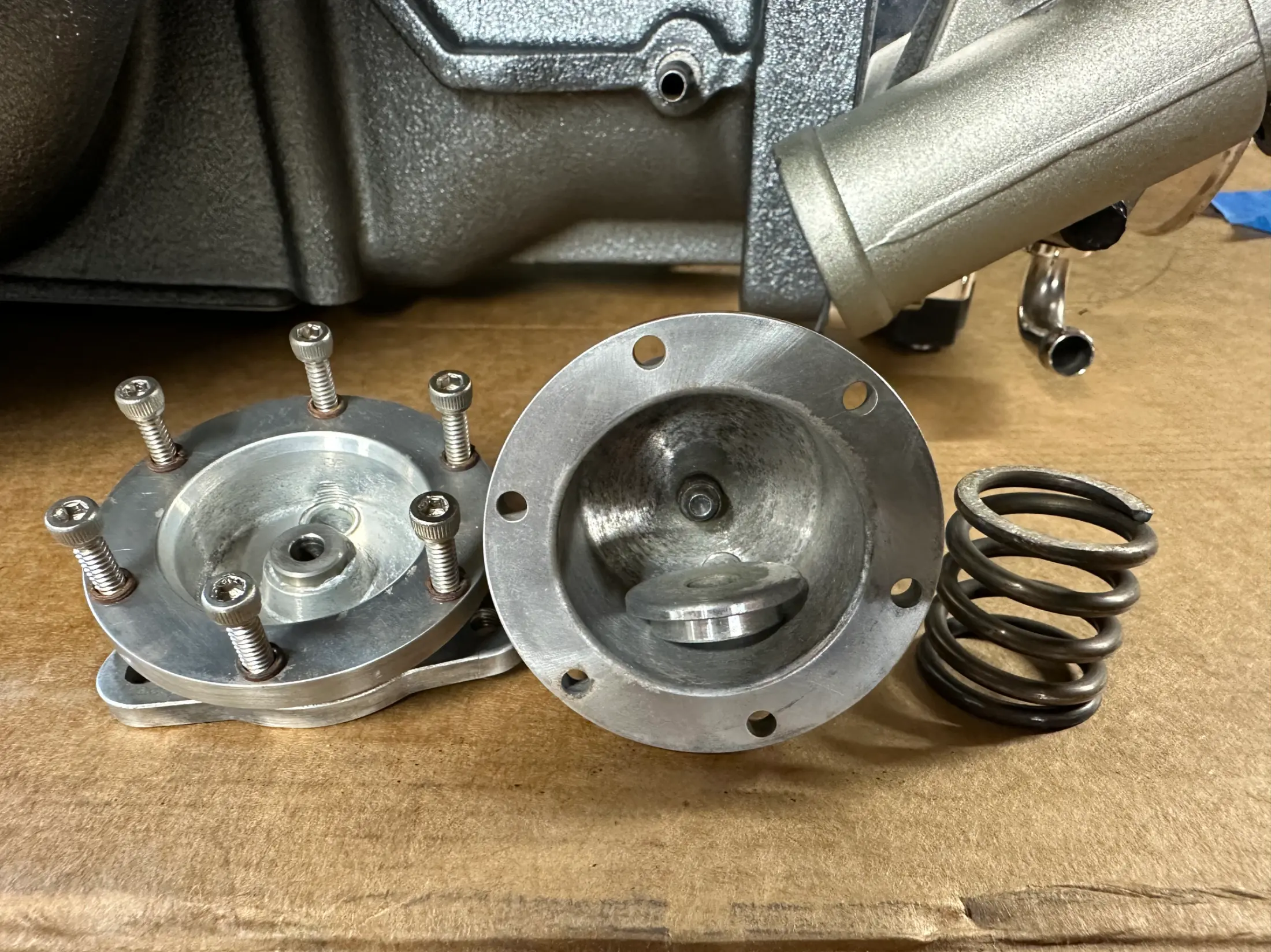

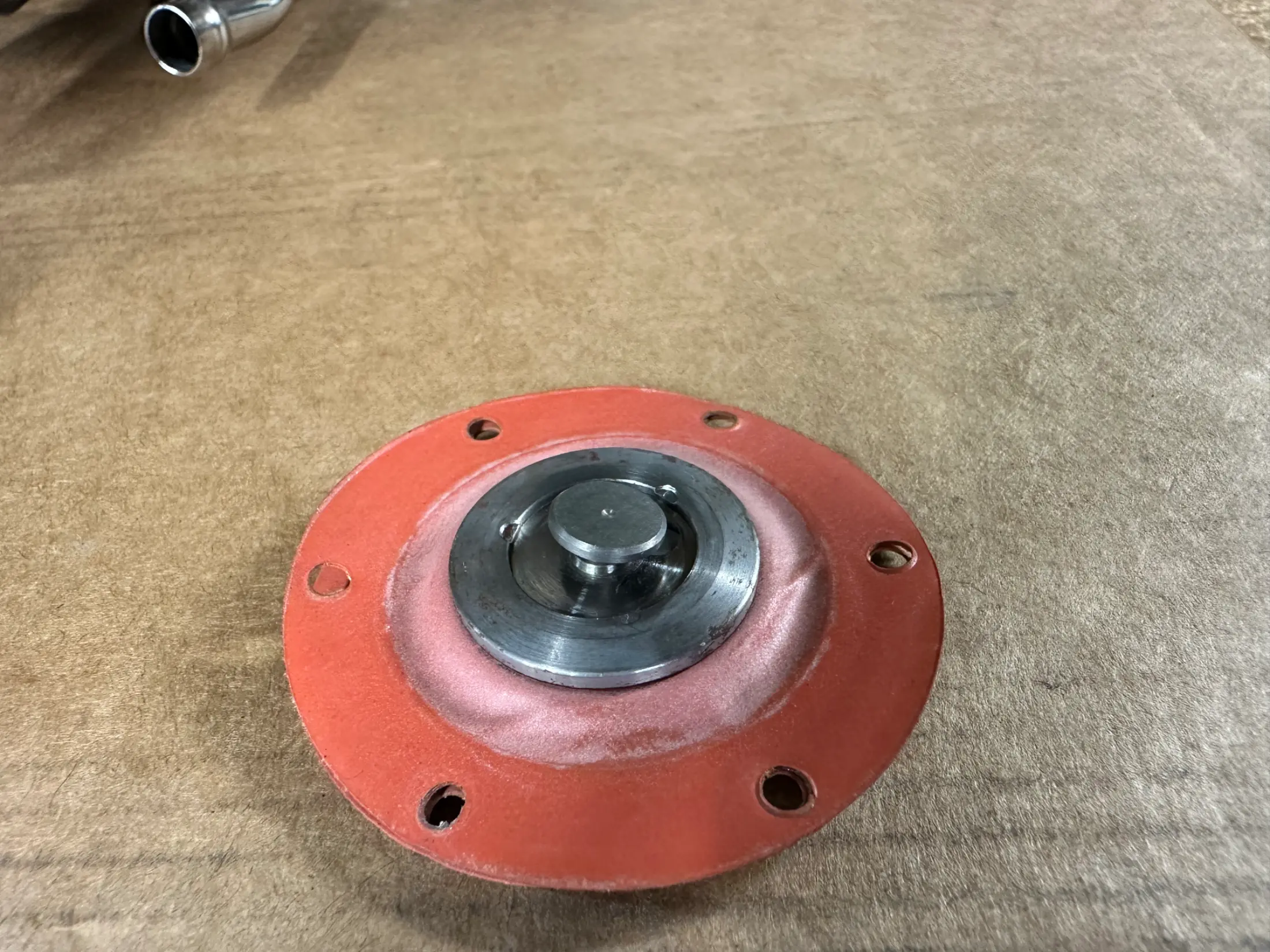

dug into it to pull off the reg
Nothing jumps out at me as bad. A little oxidation on the vacuum side, but no rips.
Got a cheapo stock reg coming tomorrow. I’ll throw it on and see if key cycling and running the pump results in 39psi.
If that checks out, I’ll order up a diaphragm for this, and put this all back together and move onto the tank side of things.
Upper intake was soaked in fuel, but I see no signs of fuel on the vac side of the regulator. Something to pay attention to. Might just be a tuning thing.
