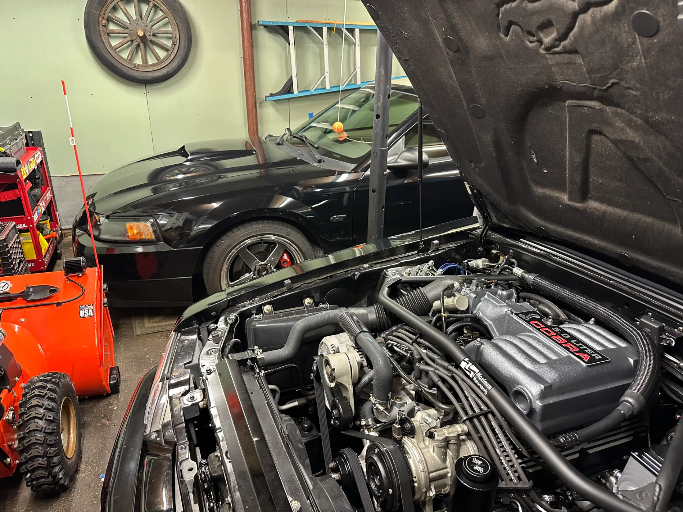

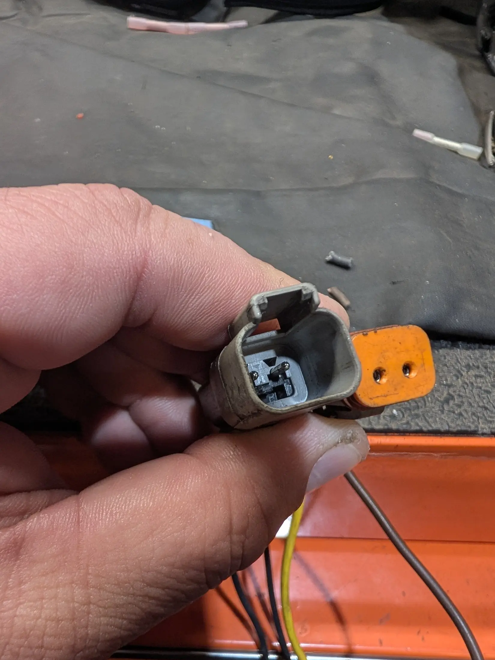

Backed it out today. Wanted to clean out the garage. Let it warm up a bit and it died. Turns out the Deutch Weather pack I installed just isn’t making a solid reliable connection. Apparently the pins only stick out 1mm or so?? Seems very odd but I followed the directions and all the illustrations show this.
See the pins waaaay back there? Ive just lost my trust in this connector now that it failed within 10 feet of backing out the driveway. Looks like I’ll be swapping that out for some sort of other connector type.
Anyway outside in the fresh air. Did not drive it though.
I’m half tempted to pull the intake and pull the fuel rail off, along with the metal lines down the side of the engine with the pressure transducer in it and blow through them/ run a peice of weed whacker string and just verify they are clear. Also going to put the car on jackstands and go over every inch of the fuel line and just verify no pinches anywhere.

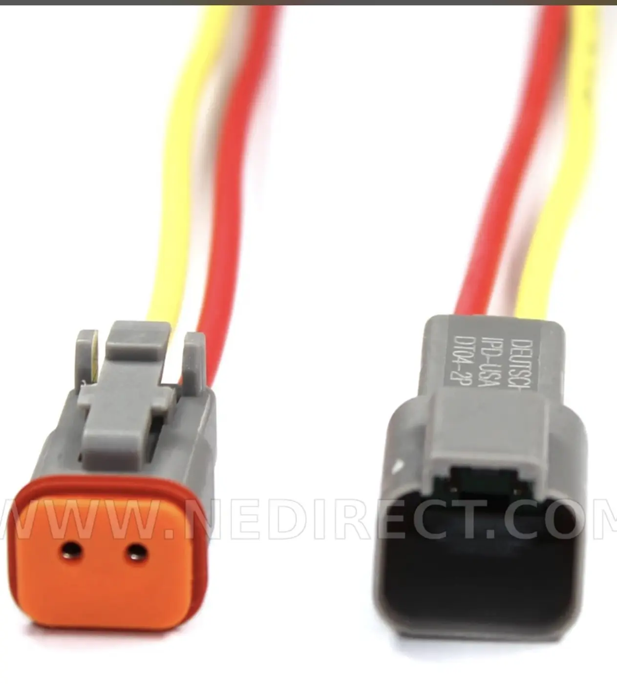

I use Deutch connectors daily at work. Theyre one of the best... There should be about 1 cm of male pin protrusion in the connector body.. something is wrong there
That’s what I assume it should be. I definitely don’t have that so maybe the male pins aren’t fully engaged into the connector. I’ll check it out shortly.

They real dts Connectors or the $10 China clones. I like the the barrel vs open crimp leads, but some of the knock offs are garbage from the ones I've tried..
THIS

Here what it should look like, not quite 1cm of pin but close
Dammit. This was it!
China clone sold as the real thing!
