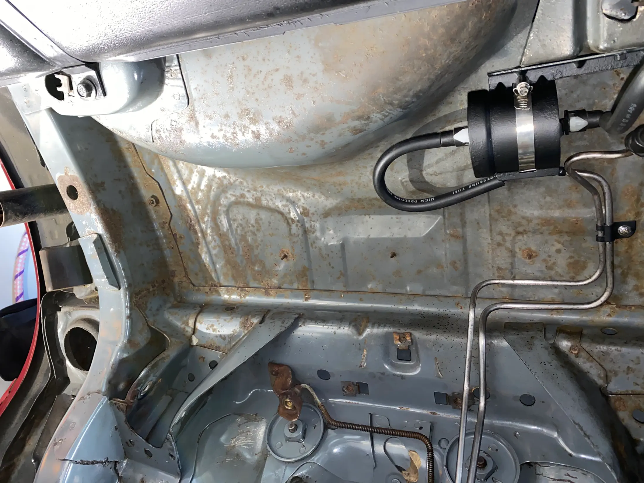

I can’t add much to solving this dilemma, but from my old pics, I can confirm the larger flanged end of the filter faces the driver side.

Stuck my arm under with my phone and a light and snapped a bunch of pics and from what I can see, the fuel filter is oriented correctly with the lines hooked up like shown in the above pic in post 350 and flanged end facing drivers side. So i made a mistake. I'll jack car up later and go look but from what I can see the fuel filter is installed correctly.
