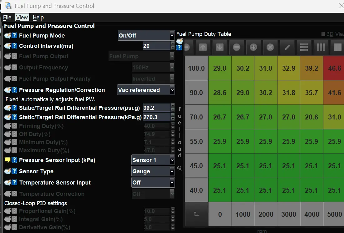

OK. I can't tell from that screen shot but here me out.
Check to make sure you don't have a fuel pressure differential (PSID) enabled somewhere in your software. If you do, that is 100% your issue for everything.
It needs to be PSIG or PSI "guage" for the time being. I can elaborate more on that if this turns out to be the case.
TL;DR
Disable PSID and select PSIG. Start your car. Disconnect and plug your FPR vacuum line. Check your PSIG in your software. Betcha it says your base FP is 29 psi engine running vac line removed.
Prepare for a brain dump....
PSID or differential reads the difference between your rail and intake. It's getting your FP from the rail. It's getting your intake reading from your MAP (or other vac sensor in the intake, not familiar with your software/hardware exactly). However when thats enabled you don't actually see either of those values. You only see the calculated differential.
So, when you unplug your vac line from your regulator to set your FP the software is comparing rail FP against your vacuum in the intake. For easy numbers let's say you have 20" engine vacuum at idle. To do the differential calculation first we need to convert to like values for each side of the equation. It's easiest to convert vacuum inches of mercury to psi. The equation is divide vacuum by 2.03692 for the negative psi value. But 2 is close enough. Or in half. So 20" vacuum = negative 10 psi. The differential between positive 39 psi FP and negative 10 psi intake conditions is 49 psi.
So when you set your base to 39 psid on the software, you were actually setting it about 10 psi lower than you thought.
The following equations are for an engine vacuum at idle of 20"hg (or negative 10 psi intake conditions at idle) Your actual engine vacuum will differ of course. The equation works regardless, just enter your actual numbers.
-That would explain your KOEO FP of 29 becasue base FP is actually set at 29 psi. The differential calculation there would be base 29 fp + 0 intake vacuum = 29 psid. Exactly what you see KOEO.
-That would explain why it goes up to 39 in the software when you start it at idle with the vac line off the regulator as you mentioned. The differential calculation would be positive 29 base fp + half of engine vacuum (negative 10 psi) = 39 psid. Exactly what you are seeing.
-That would explain why it reverts to 29 psi at WOT becasue it's actually set to that. The differential calculation would be base positive 29 psi + 0 vacuum at WOT = 29 psid. Exactly what you're seeing.
-That would explain the lean spike becasue your FP is actually 10 psi low.
-That would explain why you were adding so much fuel and not seeing the outcome you expected.
It actually explains all of it. It's gotta be it.
Interesting....I need to sit back and digest that a little.

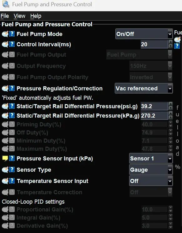

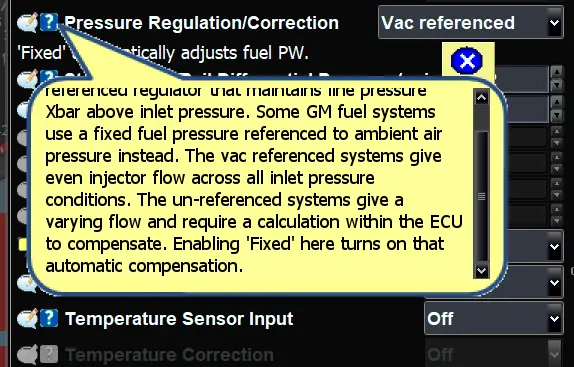

But it made me realize I set this menu up here. I assumed this would not do anything since my pump is not PWM controlled. Now i wonder if it is doing something here....
But it made me
Oh boy
EDIT: I dont have fixed set here, but I need to understand what vac referenced means. Let me go back to the base tune and probably match those settings
EDIT2: Base tune is the same other than pressure set to 42psi. Let me change a few settings and see if this changes any readings when i key cycle.

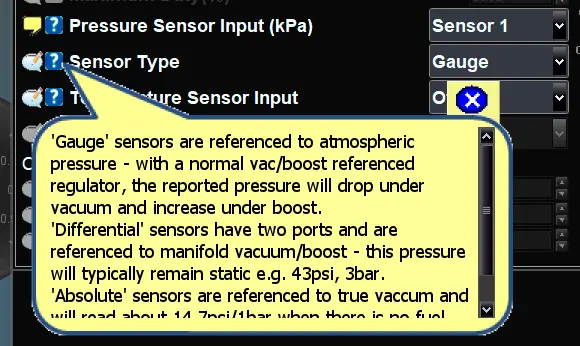

So, Vac-referenced is what makes sense to me, and I also see "Sensor type: gauge" at the bottom. That too looks right. Can you give us the other options for both settings?
In any case, you need to know that the pressure reading you're making decisions off of is what you think it is. I'd get away from all of it and use a manual pressure tester to set the rail pressure baseline. They screw into the schrader valve on the stock fuel rail. Then I'd rev it and see if mechanical pressure actually drops. Get away from the electronics for a second and back to analog.
Reactions: nicholase

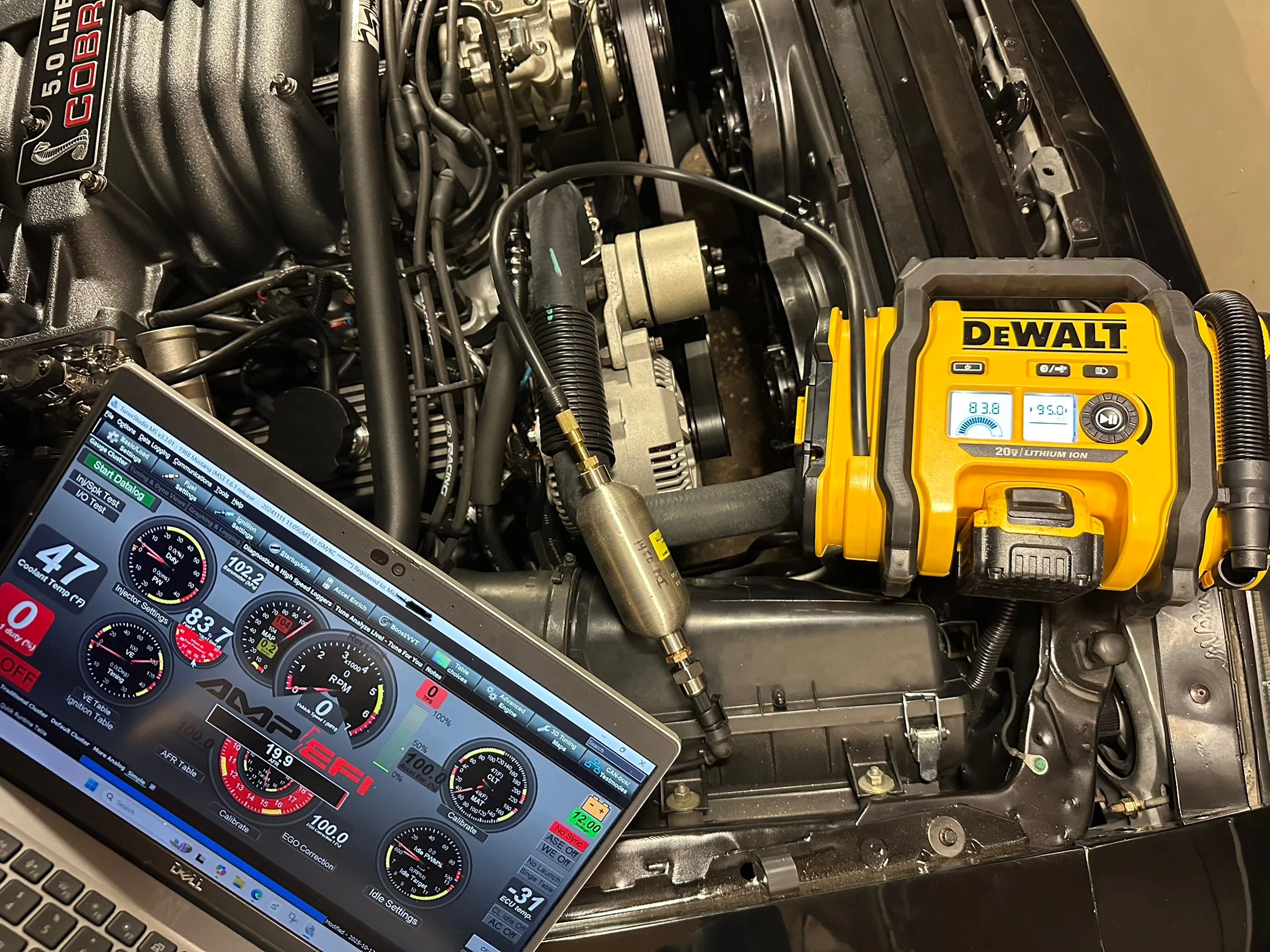

I messed with a bunch of settings in MS, and nothing changed how the transducer read. I changed a bunch of stuff here to wild numbers and it made no difference. 29, 39, 79psi. All the same
I took the pressure sensor off the car and plumbed it into a gas cylinder I have. I then used a compressed air to fill this cylinder to various pressures with a mechanical gauge on the cylinder. The transducer reads within 1 psi or so of the gauge. Ran it up to about 75PSI or so. The sensor free in ambient is 0 psi, as you’d expect.
I'm feeling pretty good here that the transducer is reading accurate enough and is configured properly in MS. I have a better mechanical gauge coming so i'll likely try and set up a tee.
Appreciate the out-of-the-box thinking here though. Keep it coming.

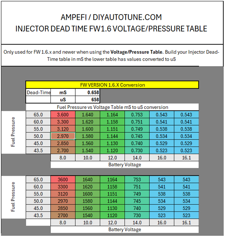

Someone else suggested checking my injector dead times. If they were way off it would account for extra fuel being injected. SO i need to sit down and go through that again. My AFR is not excessively rich when driving, so I don't think this is the case.
I need to sit down and go through this from scratch and make sure i have this set right
Guage was the right setting. But changing it did nothing. I don't think this menu affects much since my pump is an on/off type and not PWM controlled

While dead time is a tuning concern, it doesn’t explain the fuel pressure drop. The fact that it was happening with the 30s makes me doubt injector demand was overwhelming the pump or lines, and neither should the 14 ms blip shown in the log.

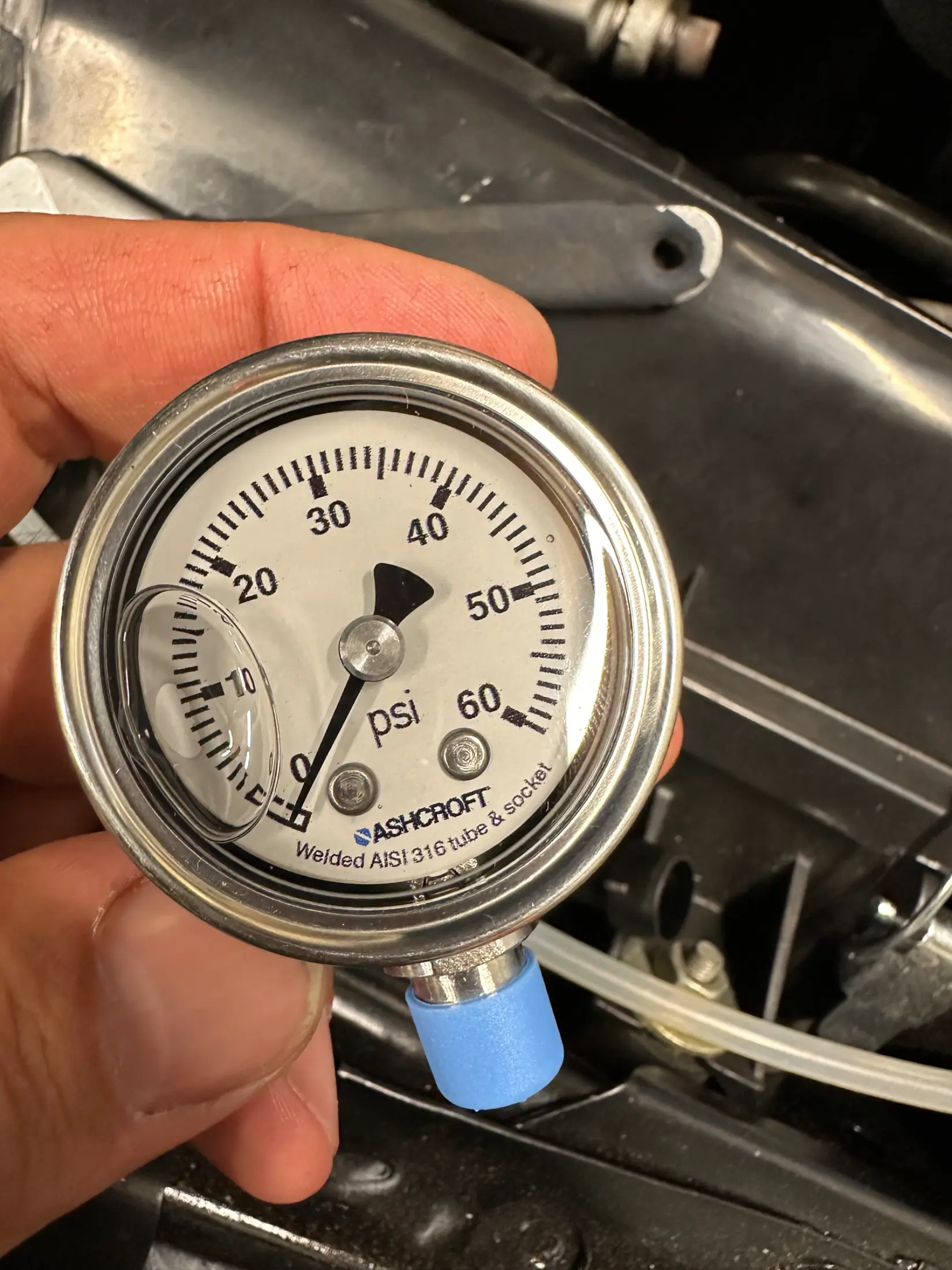

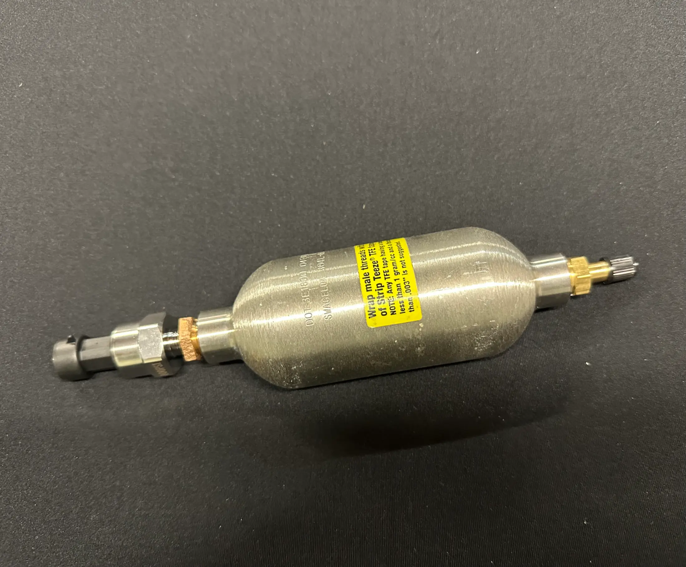

Well, grabbed another pressure sensor off Amazon and made this little grenade from some parts at work.
Hooked it up to the car and ran it up and down to verify pressure and the MS is reading spot on, so i trust the numbers. TBH i wanted to do this anyway just to be sure as i'm basing my fuel injector data off this value.
Just for the hell of it, i ran the fuel pump with the engine off by commanding it on with Tuner Studio. No vac since engine is off. Ran right at 29-30psi. Aww damn. Pretty sure I verified this with engine running but I could have sworn I set this with pressure at 39psi with engine running. I'm 99.5% sure I did. This is an interesting discrepancy. Was too late to fire up the engine so maybe i'll play with this on the weekend. I need to adjust this with engine running anyway as my pressure should be a little higher with the pump at 14.4 volts vs the 12V or so I have with the engine off.
This post is the smoking gun. Your base pressure is and has been 29psi, not 39.

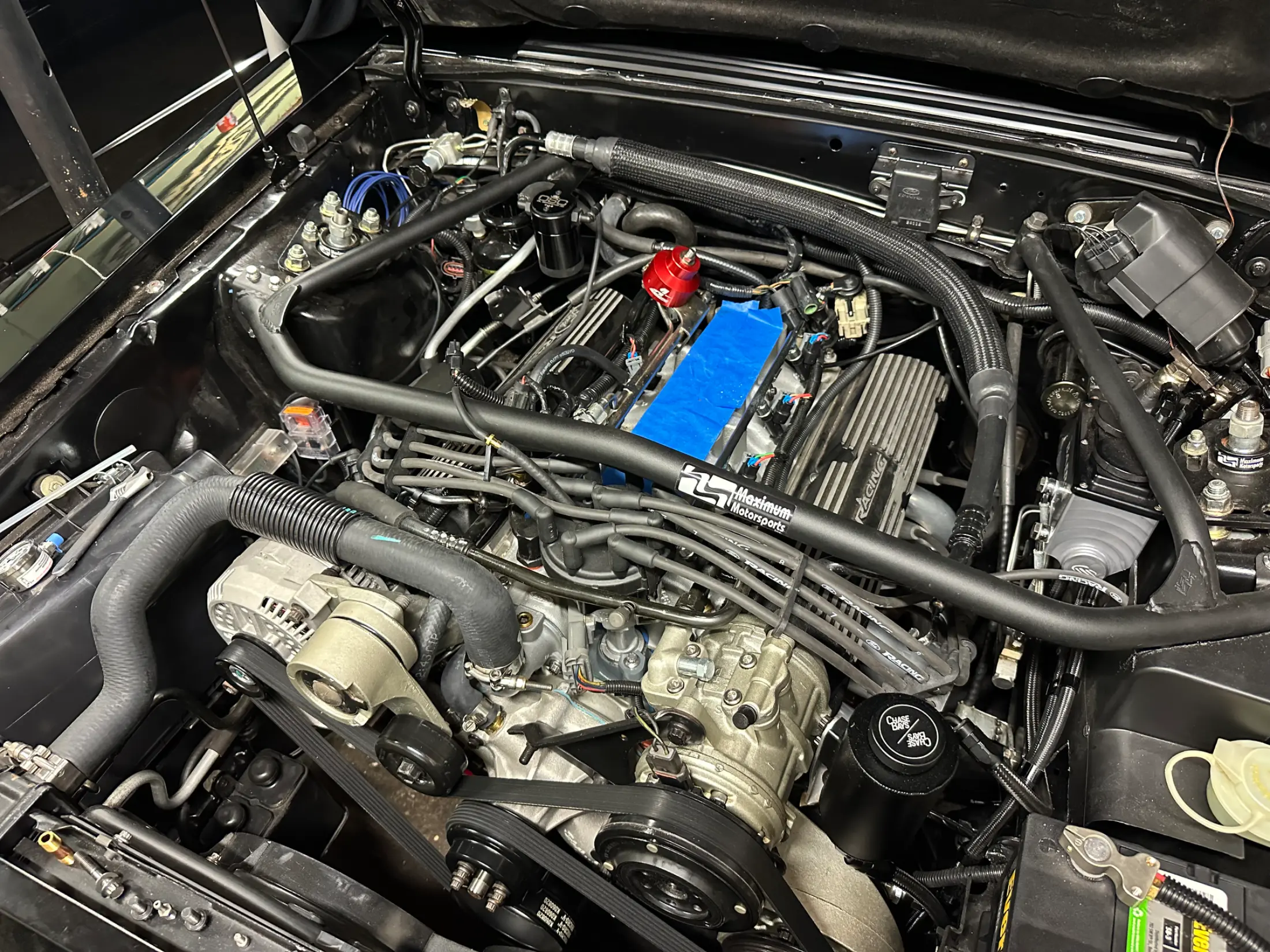

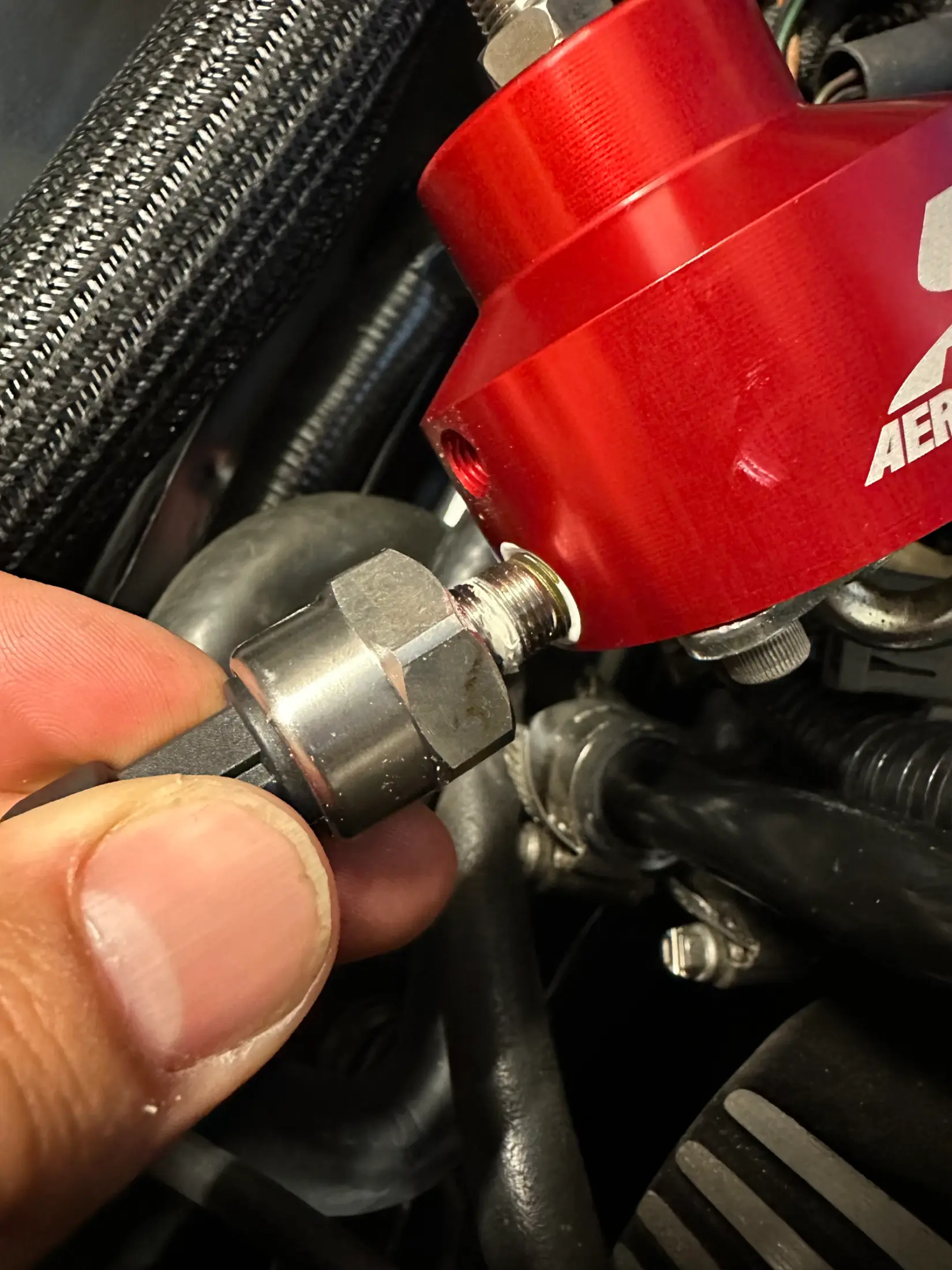

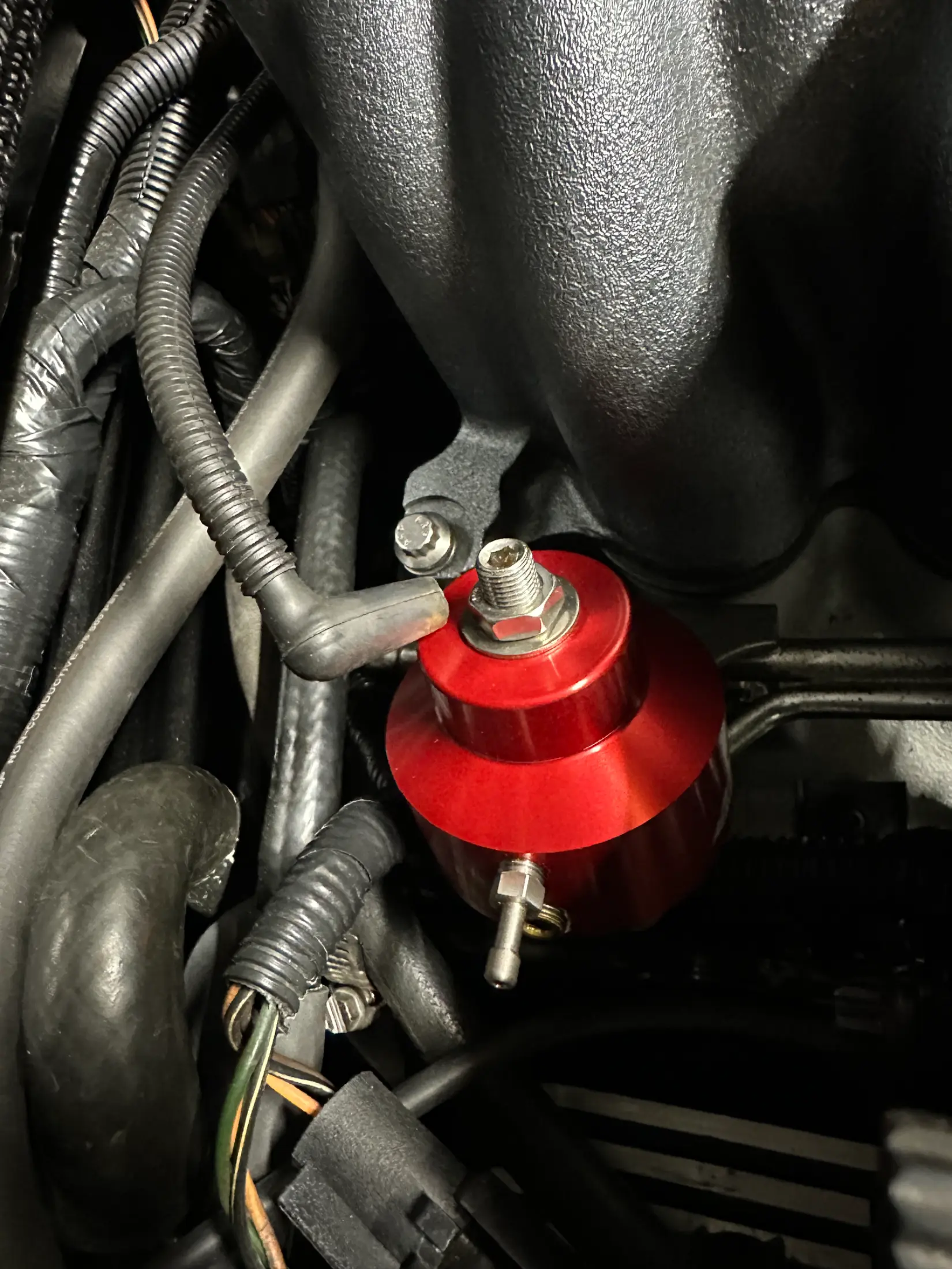

New reg installed. I didn’t have the right assortment of fittings to attach my transducer however so had to order an adapter. Why couldn’t aeromotove just offset the vac port 45 degrees ?
Not a fan of the red on my engine setup, so I really hope the intake obscures this.
Also, do NOT use the Eastwood Aluma Blast spray paint. As you can see, it yellows with heat. Prob will redo that tensioner at some point. Ac compressor a bit harder
Obviously couldn’t start the engine, but I test for leaks. I ran the pump and adjusted the pressure to 39psi. I will say I did finally notice something is different
Before with the Kirban, when I data logged my key prime, it would spike to 31 and drop to 29.
When this aeromotive, a key prime is direct to 39 without that spike.
Now, I need to engine start to see if my pressure now overshoots. It did with the Kirban. 39psi set with the engine off would give me almost 50psi.
I’m crossing my fingers that it’s the reg. We will debate the reason why I missed it later.
Hopefully get my adapter fitting tomorrow so I can move the transducer and install this mech gauge at the stock location. Long term once I solve this, I’ll put the transducer back. I think it will be quite visible up top. At least this way I can run mech and digital pressure guages to see if they are saying the same thing.
If this doesn’t work, I hope this will at least verify the problem does in fact exist.

If this works, and I feel it just may, take that other one apart and maybe you'll find something amiss inside.
I have taken it apart. I rebuilt it with a new diaphragms
I absolutely loathe the design of that regulator. I had to use several brass footings to get the gauge and the vacuum port to work and looks so tacky.
But yay for progress!
Even the vac port. The stock vac connection doesn’t reach it. Now I need to scrounge up a new line. I feel this could have been done better
Erm... I thought mine was an aero when you mentioned it, but it's an accufab. Can you send it back? Just tell em it didn't fit a stock setup. You might like this one more:
