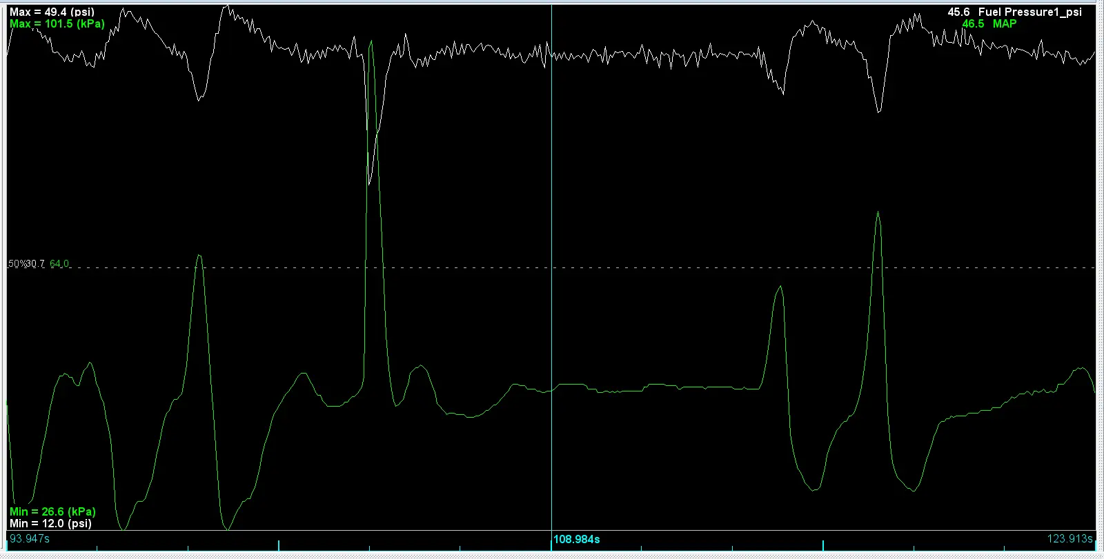

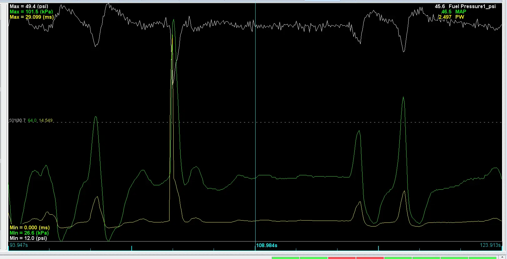

I think this confirms that the MS software is using MAP as a FP reference and giving you the dP across the injector. From what I can see in your picture, the mechanical gauge is reading 37 psi (confirmed in your text) and the ECU is reading MAP at -7.9 psi. If the transducer's raw voltage reading (please check the raw voltage and do the slope offset by hand to confirm) is correct for the gauge pressure, then the math is: transducer pressure (37 psi) - MAP (-7.9 psi) = 44.9 psi delta pressure. This is roughly the 45 psi shown on the MS software screen for fuel pressure.
I was running the FP fixed. Vac line was removed and capped. SO manifold vac shouldn't be affecting FP directly.
But i graphed FP to MAP, and do see a relationship. They are almost inverse to each other. But this could be correlation and not necessarily causation. I added in PW (yellow) and the engine is trying to add fuel when MAP increased, corresponding to increased load on the engine.

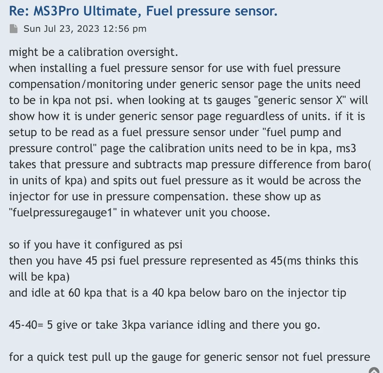

First, full credit to @nicholase for putting us onto the PSID/delta-pressure explanation. That was the key mechanism, and he nailed it.
But this is also why I kept harping on the old data and why I wanted the raw transducer voltage/generic sensor value. The transducer itself could be perfectly accurate and still mislead you if the MS “fuel pressure” channel was not raw rail pressure.
That’s what I was getting at here:
This post is the smoking gun. Your base pressure is and has been 29psi, not 39.
And here:
This is just telling you that base fuel pressure is 29. then when you run the car and pull the vacuum from the AFPR and get 39, that base is suddenly higher. How is that possible? I think the answer is that it isn't possible. Slightly more voltage, fuel being injected at idle, etc... these do not account for the 10psi change, but adding the intake vacuum in psi to the fuel pressure at the rail does.
And on Corral:
MAP and FP are basically mirrors.
And then
Put a multimeter directly on the transducer signal wire while the engine is running and compare voltage to what MS reports.
The raw transducer voltage would have allowed you to see the difference between calculated FP and raw sensor-derived FP. Because At that point, calculating pressure directly from raw voltage would have shown whether the MS calculated FP channel matched the transducer voltage alone.
The raw voltage/generic sensor test mattered because it separated three different things that were getting blended together: the transducer accuracy, the raw rail pressure, and the MS calculated fuel-pressure channel.
