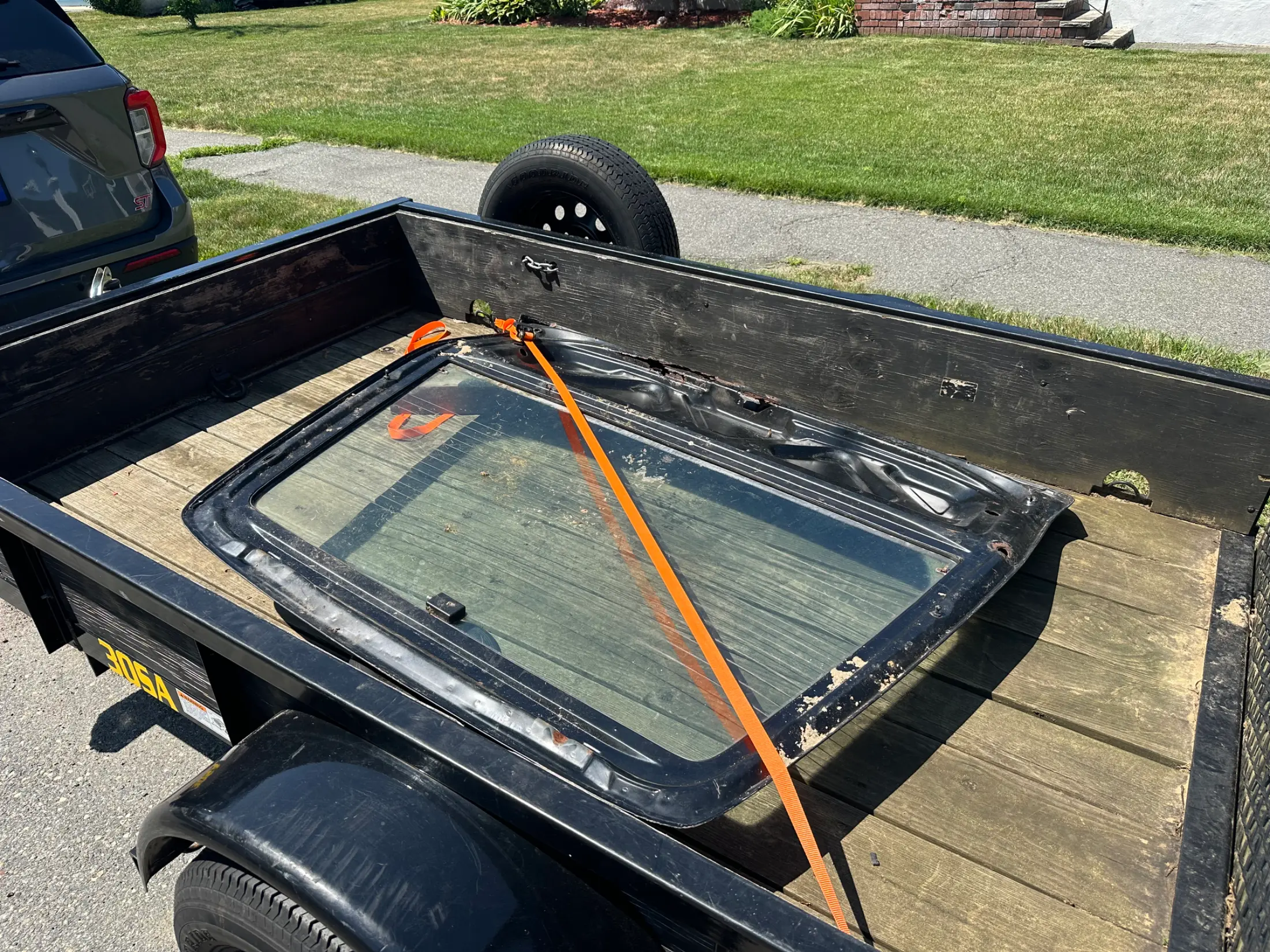

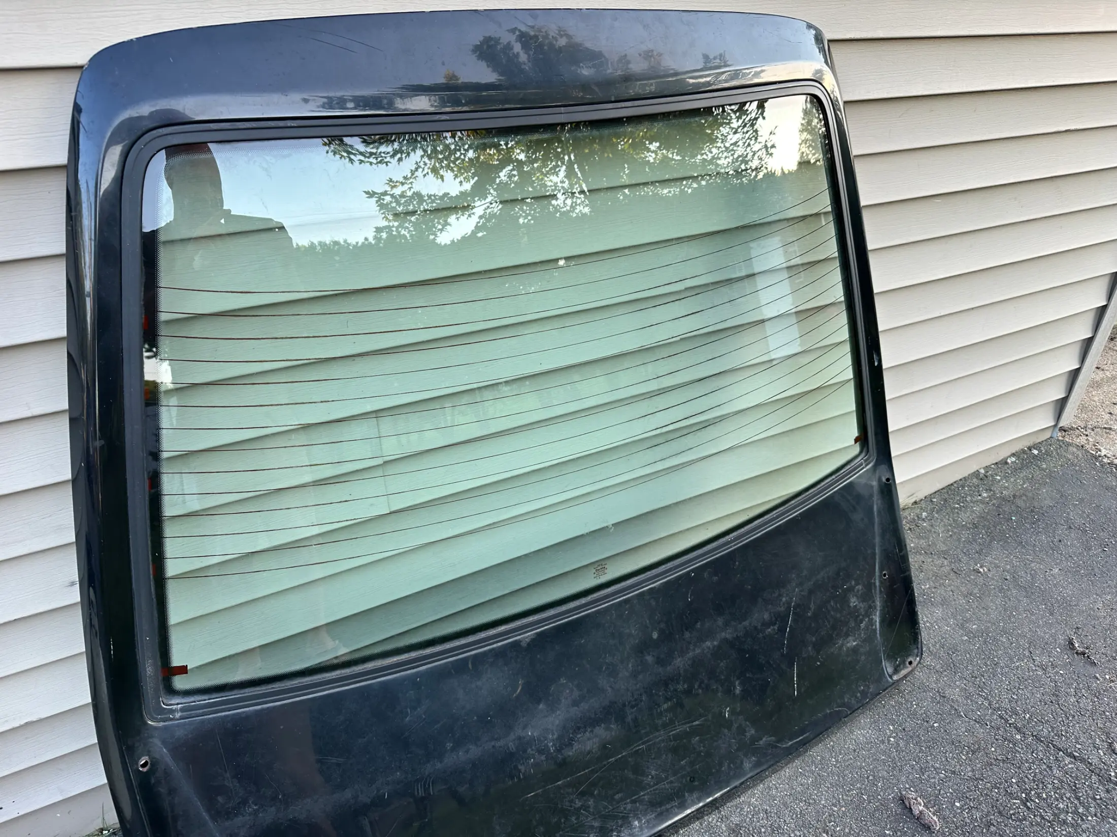

Welp. Hatch off an ‘87 Saleen is now with me.
Not sure if the defrost grid is good. Gonna remove the glass, test it out, polish it up, and if not acceptable I’ll just relist the glass and that’s that.

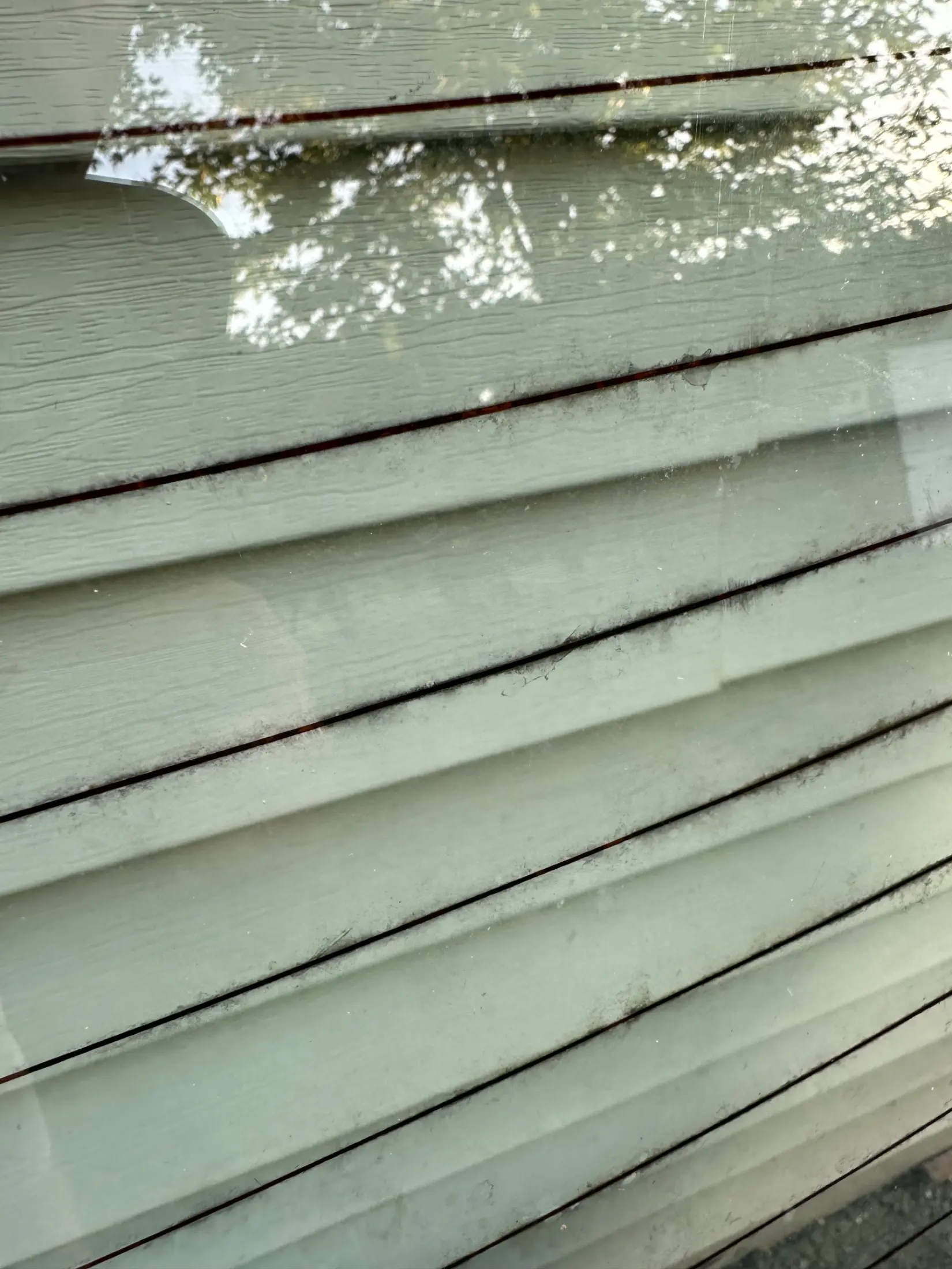

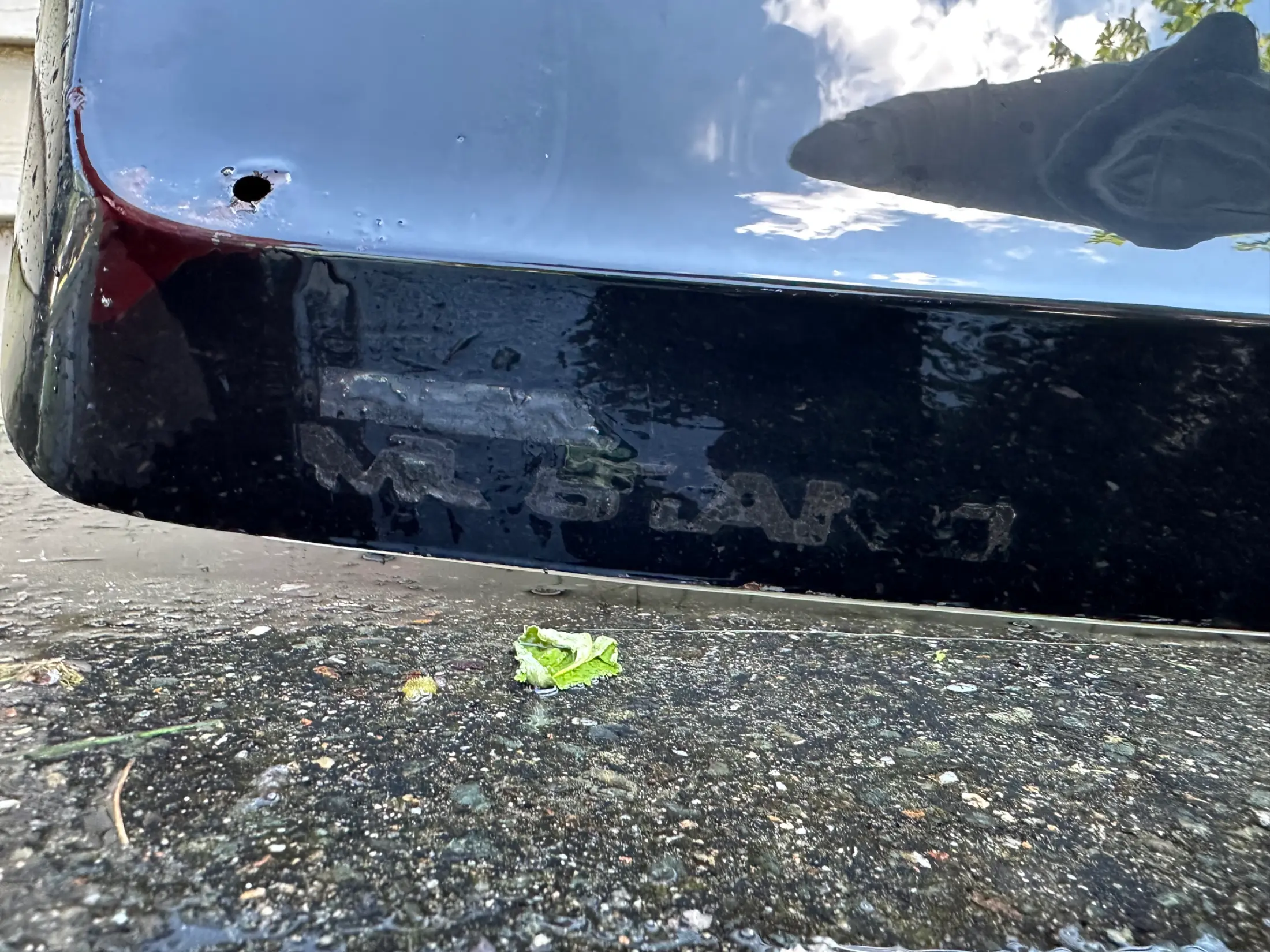

Started cleaning it off. Glad is clean. Grid is iffy. Will need to test it and see. There is some blotching I’m not a fan of.
Gotta see how I can remove this.
Just noticed the window molding trim is still on this hatch. It’s in decent shape. I also looked up what these were selling for on eBay and holy wow.
Ordered the tools to try and pull the trim off and the glass off without damage. Wish my luck.
Wish this badge was still on the hatch for my wall collection

I managed to get the window trim off without bending it up. Gonna SEM trim black paint it and squirrel it away. Now to cut the glass out. Good thing it's gonna be 95-100 this week. Figure lay it out on the ground to heat up, and my window cutting tool should cruise through the butyl without much fuss

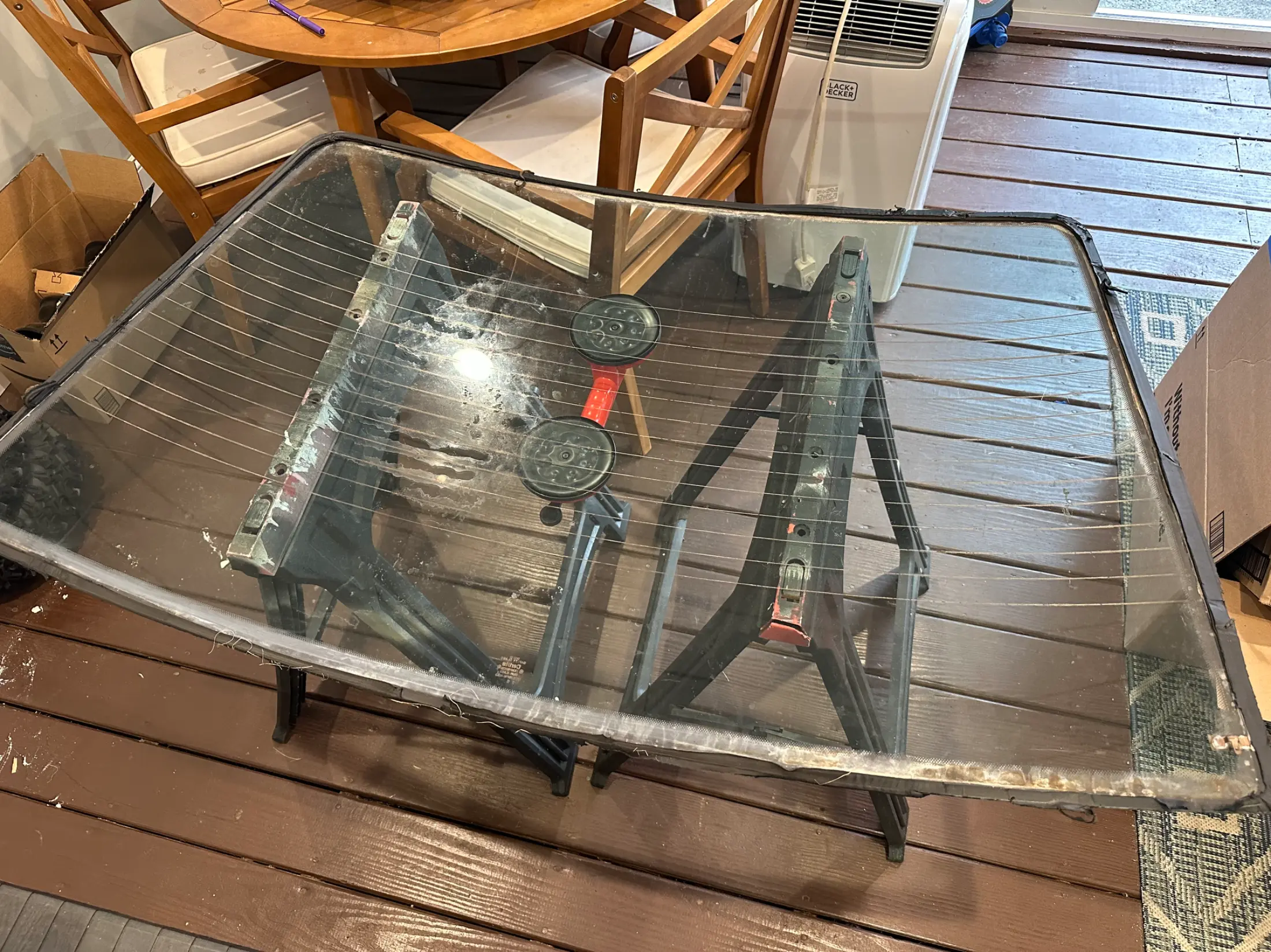

Glass out. That was easy. Put it in the sun and the tool cut through it like butter. All of 5-10 mins to do.
Unfortunately now that I can work on the glass, I’m getting inconsistent readings on the defrost grid. Not sure it works well enough to my liking. Gonna borrow an infrared camera and put 12v to it and see what happens. But I think all the conductive paint bled out a bit too much and the grid has too many breaks
But this project might be over. Gonna clean it up and toss back on marketplace. What’s used hatch glass go for? I did all the hard work removing it. I know the hatch trim has value.
