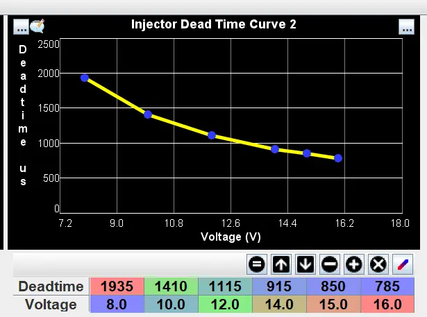

Well on an interesting note, the injector works again. I measured resistance and tested it, and it now fires. It did NOT fire earlier when I ran the injector test on TS. Now, it works when i test it.
I really hope it's the injector, and not the injector driver overheating in the ECU. I would think they would have been built a bit more robust than necessary. Kinda wish i took a spare injector and plugged it in earlier and verified it could fire an injector. Now i have to try and make it happen again or cross my fingers that the injector overheated...but then somehow cooled back down and worked again. I've never heard of that which makes me nervous.
I used some standard dead-time settings i found from a few diffenernt sources that were about the same. Given that I was plannong on changing these out, i didn't put a whole lot of thought into the settings

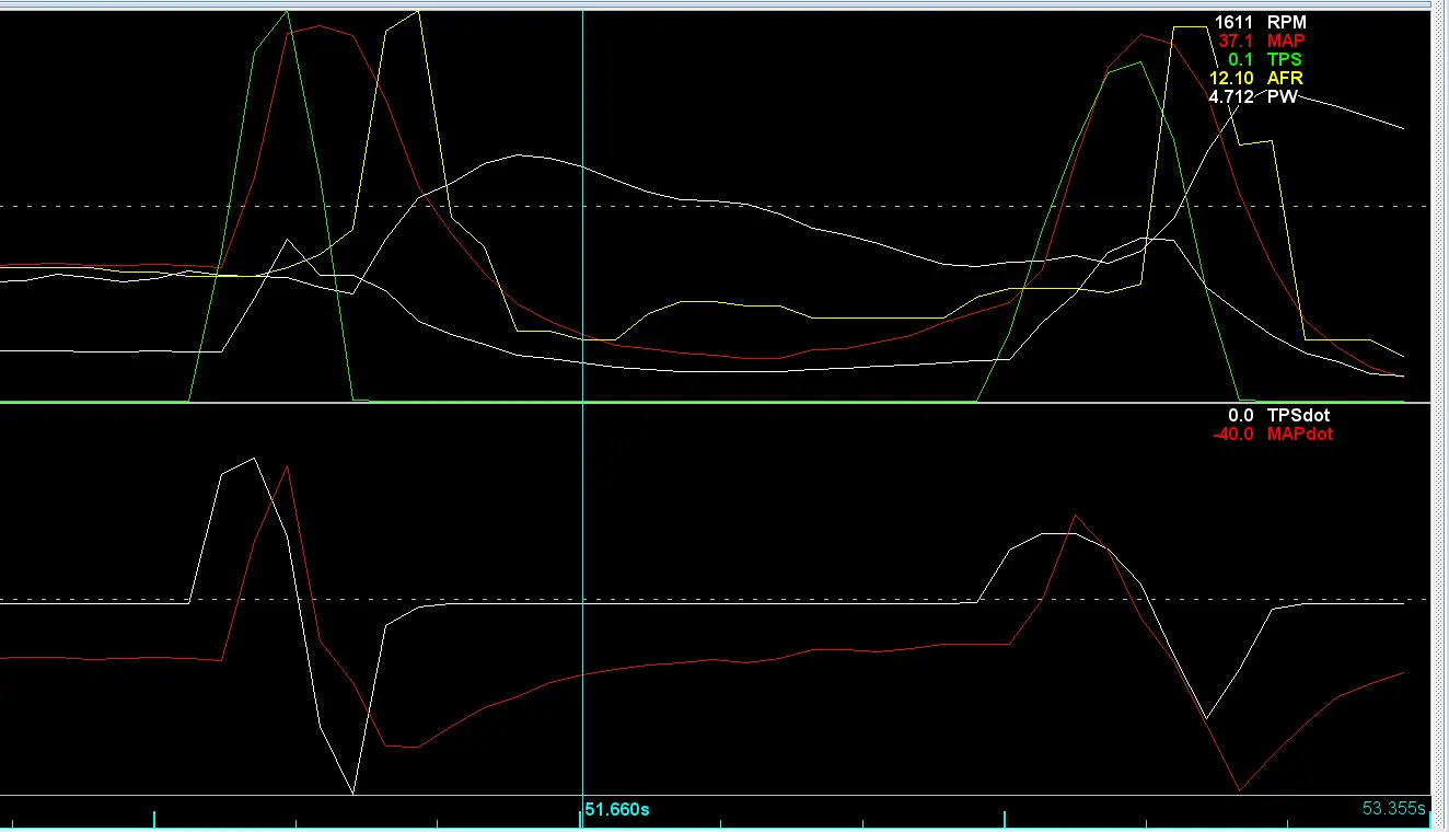

Well the injector issue seemed to have "fixed" itself. Really wish I could duplicate it as I want to confirm it's an injector issue. I'm going to cross my fingers it was an intermittent injector issue and not a ECU issue. Now it's going to bug me what really happened.
Didn't go for a drive, but a little more idle time so i didn't get to try and duplicate a long 3rd gear pull. It idles really well. Starts right up and no surge. Settles into a nice stable 800RPM idle at around 13.8 AFR. Any closed to 14.7 and it goes into a lopey, shakey, Cam dance. If i had to complain about anything it would be that I wish i could clean up the startup a little bit more to get it nice and smooth. I sometimes get a hesitation on start like a misfire. Could be the crank settings are too/lean rich but all this can be dialed in after i swap the injectors as no reason to do it twice.
Problem is off idle tip in. Now, i know i shouldn't be playing with this until i dial in my VE table and get the 30's on, but I've got nothing else to do.
This data log shows it perfectly. Two idle blips here. Smooth idle and then a little throttle blip and you get a stumble, dip and goes lean when it revs. This is really the one thing that is bugging me because If i jump on it in 2nd gear, i get that hesitation. The AFR spiking lean has me thinking not enough fuel, but playing with AE hasn't really done much. But again...i know i need to play around with the VE table a bit more especially right around idle.
I'm just playing with things a bit. I did order a fuel pressure sensor to add to this setup as I'd like to see what my FP is doing when i cruise.

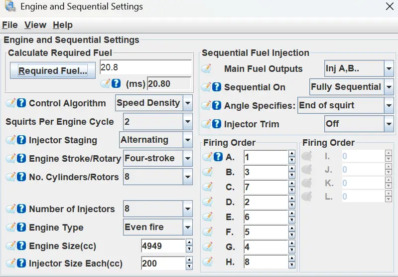

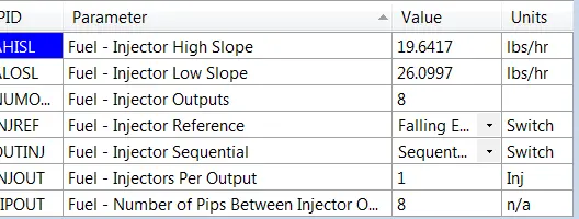

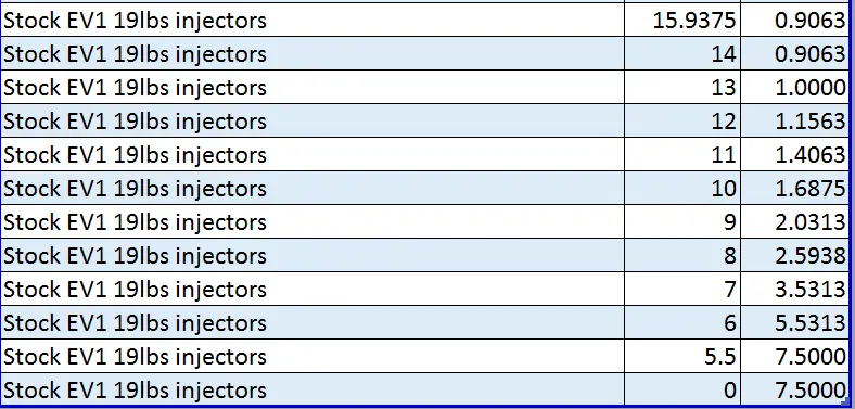

I'm interpretting 'dead time' as injector opening time. What the mega tune is showing in microseconds differs pretty significantly from what binary editor shows in the A9L.bin file (in milliseconds):
But what I'm not seeing in what you've posted is the high & low slopes, which is how the strategies in the EEC controls them:
Then, the EEC uses something called a breakover point, which I believe is the time after opening from which the injector acts as a high-slope sized injector to the time it acts as a low-slope injector. I believe this primarily matters at low pulse width where if your computer is demanding very low duty-cycle, the injector will act as though it's much bigger than its nominal flow rating. The break point in the A9L.bin for the stock 19 lbs injectors for all voltages is 0.000030398 lbs/rev. I'm not sure those units make sense, but that's the column header in the table I'm looking at. According to a post on EecTuning.org, "The injector break point is the pulse width value where the EEC changes the way that it addresses the injector. Above the injector break point, it goes to higher slopes, below the injector break point, it treats the injector at the lower slope." I thought the units were supposed to be in time. lbs/rev doesn't add up to that, to me.
I popped open my Big Stuff 3 software (I'm still using the original stuff that didn't require a subscription) & it doesn't have any of the hi or low slope data for the injectors, either... It just seems to have the nominal value for flow and the I/O times. I guess the rest of it is interpolated from some base assumption within the program, or maybe it's just not as important as the EEC makes it out to be.
Anyways, if I were in your shoes, I would use the A9L.bin data for the I/O times. That's a very well-vetted tune. Just need to convert the milli to the micro.
Why did you set it to 200cc? I can see that making the most sense if you're trying to pick a point between the low & high slopes. Just curious about your reasoning.
So, going way rich indicates that you have TOO MUCH 'accelerator pump' tip in. That spurt only lasts for a very brief time period, and then AE & close-loop correction takes over.
My best guess, and caveat first that you're right about getting the VE tables right, is that your initial tip-in is too much causing closed-loop corrections to pull it lean, before it finally re-corrects back to commanded AFR. Two ways to test my theory: pull tip-in out, or command open loop and see if it still happens.
