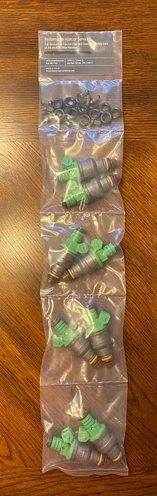

Picking my injectors up today from the guy that is doing the cleaning. Talked with him a bit yesterday and he is retired from the nuclear industry so he is a little bit OCD. His shop is really nice, clean, and very well organized. Curious to see if the injectors were any kind of dirty.
I used a local shop recently for my Ford 42's. New O rings, caps and filters as well. They were old with unknown mileage but oddly enough only 2 were slightly off before, now all perfect after cleaning.
Got them back and he said they were not terrible but definitely needed the cleaning. Were putting out about 39 lb/hr @ 43.5 psi and the spray patterns were quote "not the best". All cleaned up, all within 1% of each other and now putting out 45 lb/hr @ 43.5 psi. Very satisfied with the $120 spent on this.
