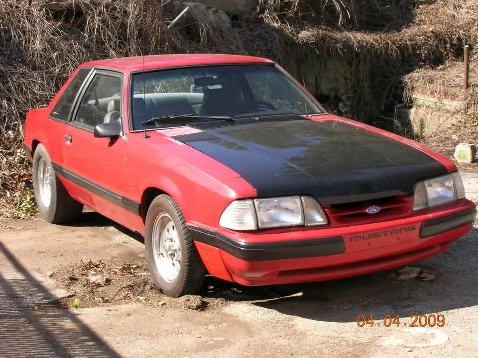

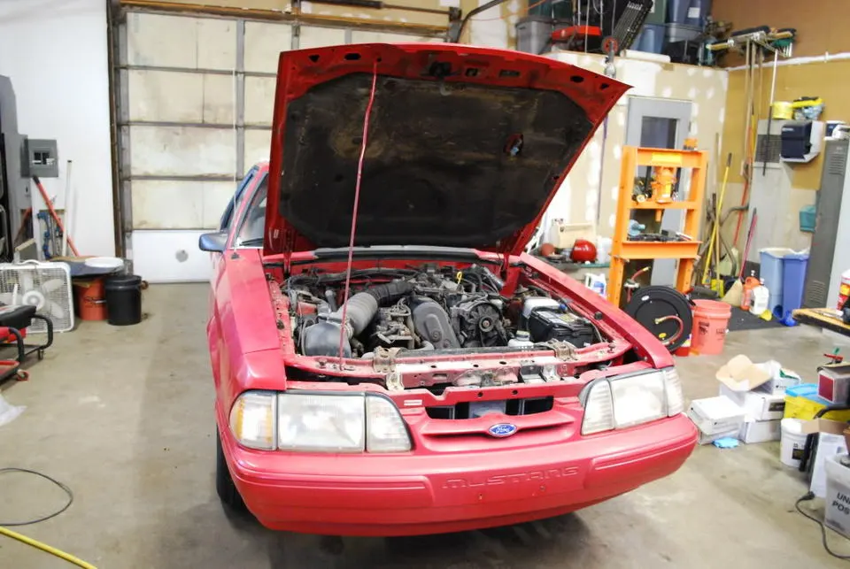

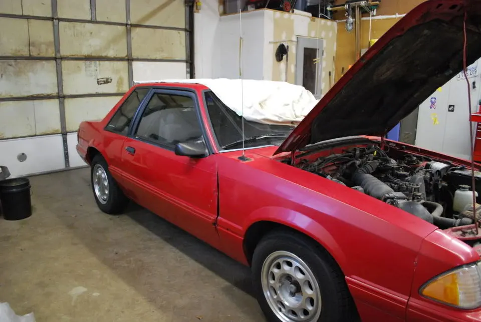

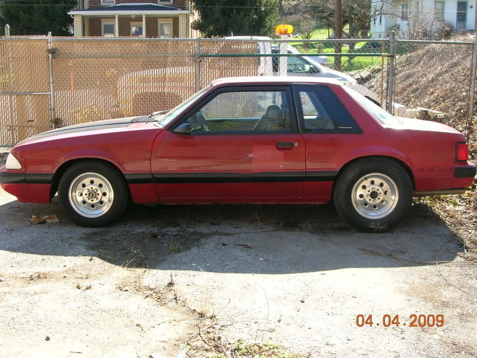

Well last weekend I started my coupe project. I have a 93 4 cylinder coupe, red with a 5-speed. I plan to remove the drive line out of my 83 GT and install it into the red coupe. Last weekend I removed the 4 banger and I just removed the 351 from the GT yesterday. I have now learned that I really don't like my headers so I think I will be ordering a new set of those. I have included some pics of the coupe
The coupe
The coupe again
The 83

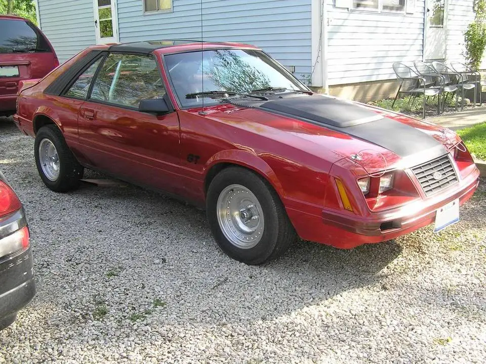

i hope there's some frame damage or serious hidden rust issues to justify gutting out an '83 t-top... it looks pretty clean from the pic :shrug: i don't think the amount of work would justify the weight savings alone
unless you have another powerplant waiting to go in the '83??

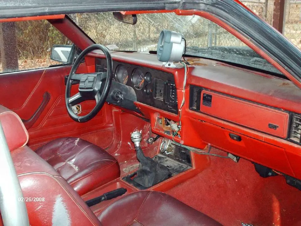

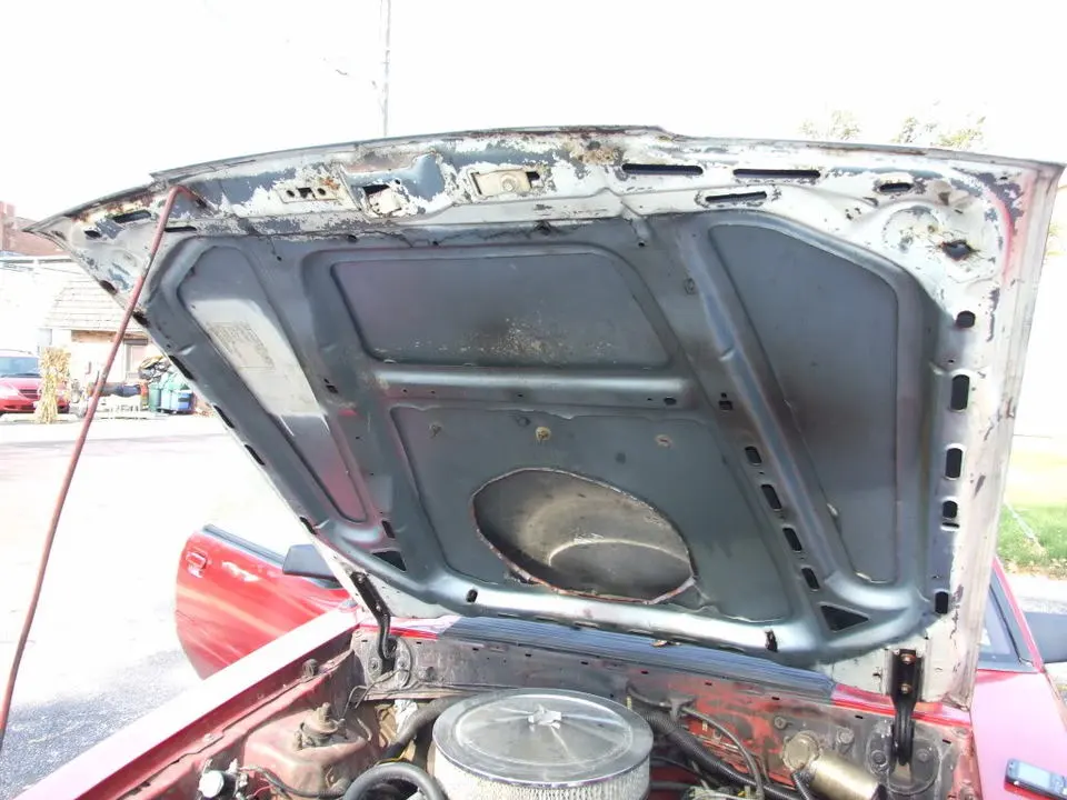

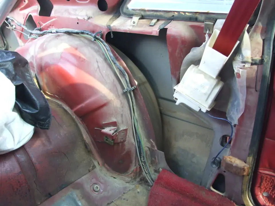

Who said I was hacking up the 83? I should have clarified that in my orginal post but I was really tired at the time. I am removing a non orginal drivetrain from the 83 and putting it in the notch. Why am I doing that? Well I wanted a coupe and not a hatchback. Yes the four eye is relatively clean, but the last owner removed most of the interior from the front seats back, all the trim is missing. So as it sits it is missing lots of parts and the stock engine, trans, and rear end are long gone, way before my time with the car. I figure if I am going to dump tons of cash into a car it might as well be what I really want, so I bought the 93. Now with that said I plan to sell the 83 to someone who will want to restore it back to its orginal glory. The 83 does have a clean title and solid floors, which is hard to believe since those T-tops just leak like crazy! Trust me I am not parting it out! It is a good looking car but it needs work just like any other 25 year old car.

I will post some pics of the 83 when I get free tonight, I would do it now but I am locked out of photobucket and that is where I have the pics hosted. I am telling you the previous owners did some bad things to it, poor thing.
Interior parts are piddly issues. I could gut the rear half of the interior out of a four-eyed Fox from a local yard for probably $100, plop it in there, and it'd all be groovy again. Your '83 looks structurally solid - that's the main point. Are you still keeping the '83 to do other things with it, or are you ditching it? If you sell it, you'll sure be making someone's day. I know I, for one, would love to have that thing... :drool:

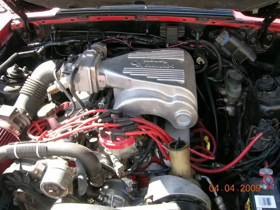

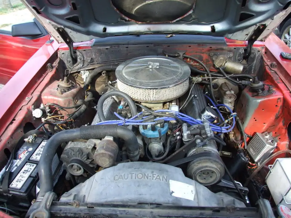

I pulled the 351 out of the 83 and discovered why the exhaust leaked so bad. The headers are slip fit, so the passenger side had three pipes that slipped together and the drivers side had one. Well I ordered up a set of BBK shorty headers for the engine, polished ceramic coat. I love these headers they went on really easy friday night. Plus it helps that the engine is out of the car. Saturday morning I removed some rust in the engine bay and hit it with some paint, I also cleared out the cowl of leaves and dirt and shot that with some paint too. Now I need to switch the rear ends and reinstall the engine. I did buy a speedo gear so this time around I will be able to see how fast I am going.

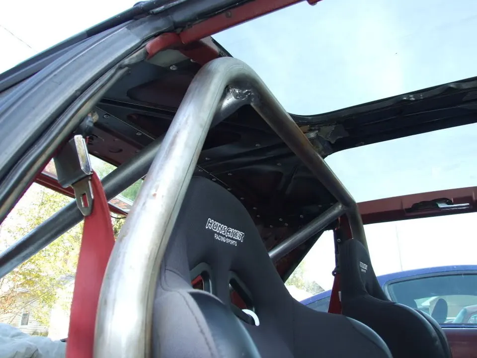

I like the Hunsackers, they are a step up from their lowest priced seat. They are very supportive. And the price was not to bad, I think they ended up being $350 with shipping. I bought them for my old 66, so when I sold that I kept the seats and put them in the 83. I plan to keep them I just don't know how soon they will end up in the notch.
