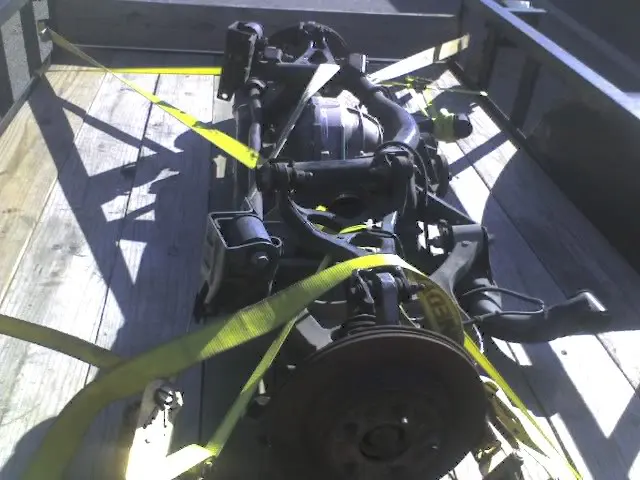

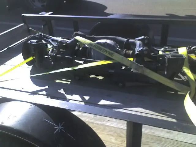

Well I didn't get anything done on the car but I did go pick up a used rear end for it. I could not pass up the deal
It came off a 2004 Cobra and it has a broken drivers side half shaft, which to me means the passenger side is not far behind. I am told it has a 4:10 gear and some new bushing. Now I need to get calipers and brackets and figure out how to replace the half shafts. I can't wait to get this into the car.

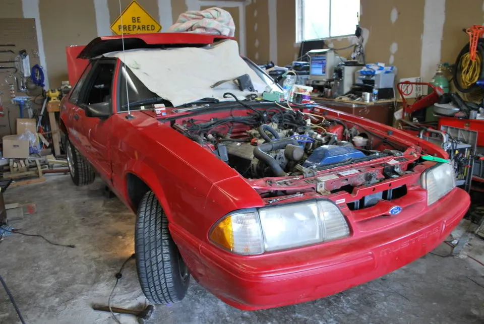

Just a little project update. Last weekend I managed to get the motor installed and transmission in and bolted up to the cross member. The motor bolts right up to the stock 4 cylinder K-member, so they seem to be the same. I am able to close the stock hook on the engine but I have not tried to place the air cleaner on top of the carb as of yet. Yesterday I installed the clutch cable, throttle cable, speedo cable, cleaned out the interior, topped the fluids off in the trans. Today I plan to reinstall the shifter, console, seats, radiator, heater hoses, fill fluids in the engine, oh the power steering cable needs to go on. I started on the h-pipe yesterday too, that one is going to be a pain, the hanger doesn't want to line up. At first I though I had the hanger upside down. So I told my buddy that I would crawl under the first fox I saw and check the hanger configuration. Well that turned out to not take long at all, we pulled into the parking lot at the pizza place last night and there sat a red GT convertible. I said give me the flashlight and I ran over and checked it out and it matches mine. I just looks like I need to give it a little persuasion. So we will see what all I get accomplished today.

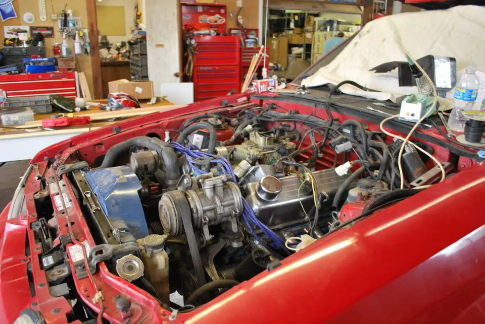

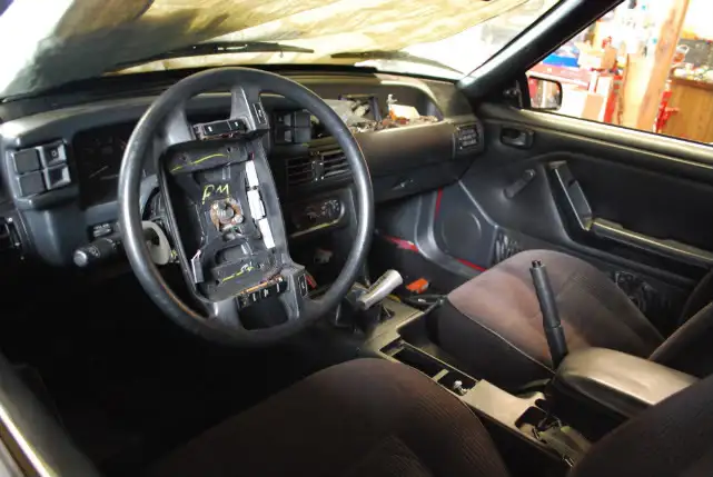

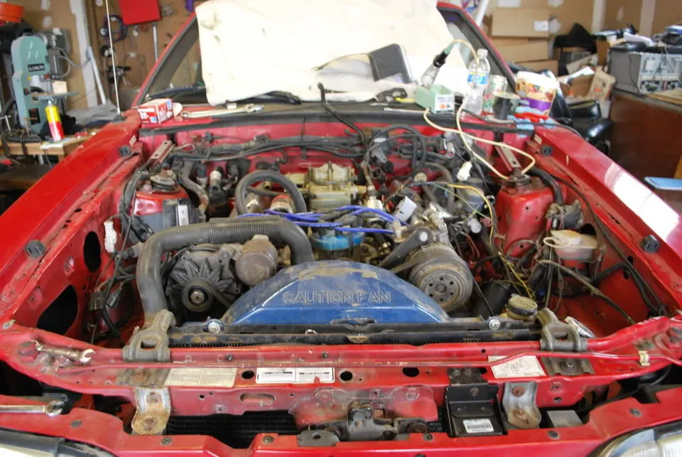

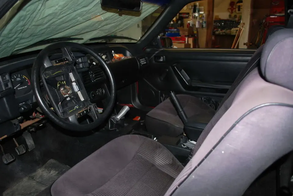

Well I worked on the car for two solid days and I still don't have the engine running yet. I ran into a wiring issue last night. I have included pictures of the engine installed and the almost complete interior.

After installing a new fuel tank, fuel pump, fuel filter and carb I managed to get the mustang purring like a kitten. All was well until the water pump started to leak. I went and tightened down the bolts and snapped one off in the block, so now the engine is sitting there with not water pump or timing chain cover while I go out and pick up an easy out! This is the second ford motor that I have done this on. I removed all the accessories and brackets to free up some room to work. I don't think that the A/C or smog pump are going back on. That is were I am at now, almost on the road.
slp352
Oct 19, 2004
42
Peoria,IL
Aug 6, 2009
#31
  • Aug 6, 2009
  • #31
I finally drove it out of the garage last night under its own power. I put five gallons of gas in it and drove up to the local casey's to top of the tank. It is so nice to finally have it up and running. Since my last post I have done the following:
Removed the broken bolt and reassembled the front of the motor, I removed the smog pump and A/C -it was not hooked up anyway.
I had to source new brackets to relocate the power steering pump up to where the A/C once was.
I replaced the power steering pump and installed a shorter belt.
I also swapped out the battery and starter
I know have all but 1 piece of interior trim, I installed the cover over the steering column and the panel under the dash on the drivers side, although I need to paint that piece because it is grey and I have the black interior.
Now I need to adjust the clutch cable, tune the carb, and button up some items under the hood. I also need to hook up the tach and figure out why the oil pressure guage is not working, I am sure it is a simple wiring issue and hopefully I really don't have oil pressure issues in the motor. I will take pictures of it this weekend to show everyone what it now looks like.
Oh and I sold the 83 GT to a guy in a nearby town, it now lives next to his 82 Mercury Capri, not sure what he plans to do with it but hopefully he will see that it stays in good shape.

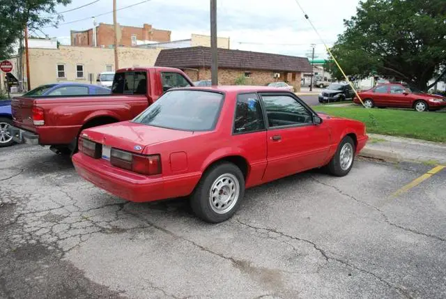

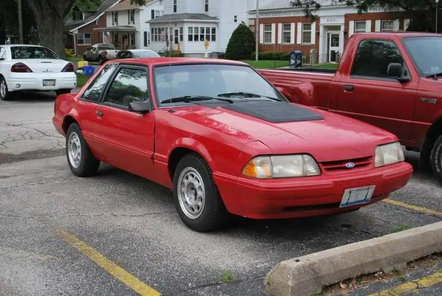

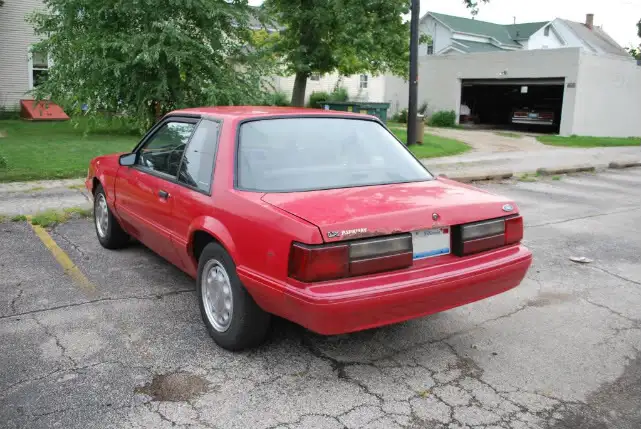

Here are some pics from last summer.

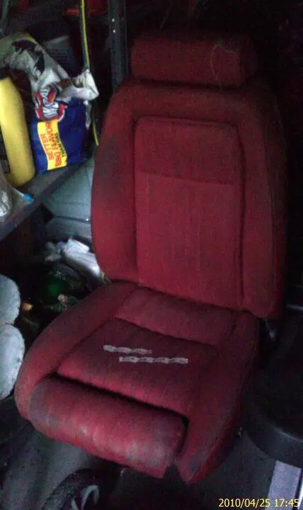

New Old Seats
Well it rained most of the weekend so no work on the car. However I did get a call from my mother on saturday saying she was at a garage sale and she had found some mustang seats. She told me they were only 15 bucks for the pair, so I started asking questions and after the third one she said "I don't know, here ask your grandfather" so she passes the phone to him which helps cause grandpa is a gearhead who loves his bargains. So I asked if the seats had side bolsters and if they had hoops for a headrests. He said yes to the bolsters and yes to the hoops and then mentioned it was a powered seat and that the guy at the sale said that he had no idea what year they were but he guessed late 70's. Well I figured for $15 if they didn't fit I could just sell them off. So here is what I ended up with for $12.
They are dirty, but they don't lean like alot of stock seats do after years of use. A while back I decided I didn't want to use the hansacker seats in this car so these buckets will be good enough until I decided what kind of seats I want. I might just recover these in new black tweed and do the rears to match and be done with it.
