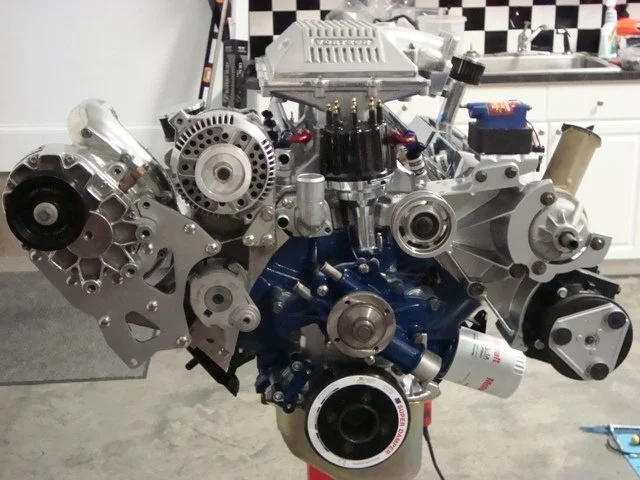

Thought I'd post up my build here she is on the stand in mock up right now
Specs:
Engine
74' Block
Eagle Crank and Rods SRP Pistons
Victor Jr. Heads no port work
Comp XE270HR Cam
Vortech Igloo intake
TFS-R Lower
Vortech S-Trim for now T or Si later on
Trans:
Viper Spec T56
Spec Twin Disc Clutch
Fuel:
Aeromotive Stealth A1000 Fuel System
FAST XFI Fuel Injection complete rewire
Plus also did a complete underhood/underbody base/clear paintjob and powdercoated almost everything else.
Going in this car
94' Opal Frost/Red Interior
Should be running in 2-3 weeks I'll post up some more pics when I get them uploaded

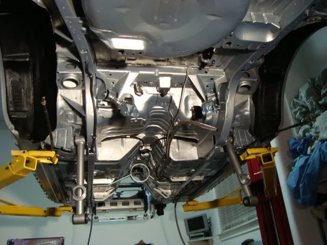

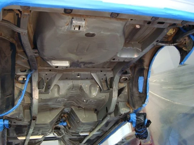

Here is a cool before/after on the under side paint the rest of my pics are on my work computer.

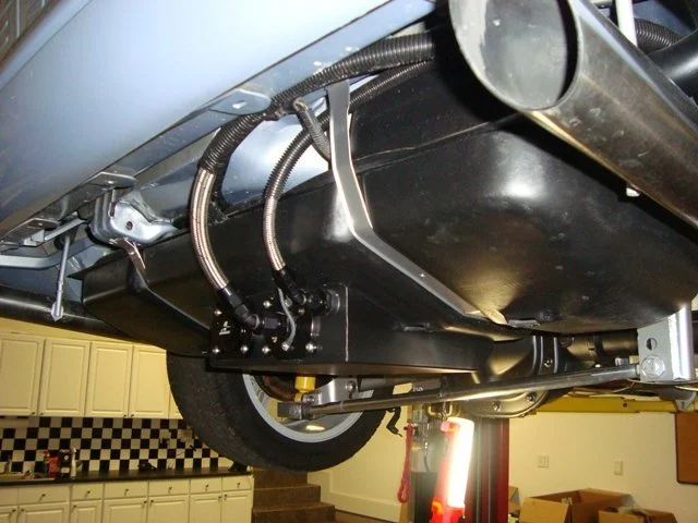

Here is a shot of the Aeromotive Stealth Sump in the stock tank which has the A1000 pump and prefilfter in the sump.

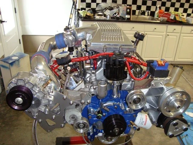

and the nearly completed motor on the stand
Just waiting on a different balancer hub so I can get my belts sorted out. Then its ready to go in
