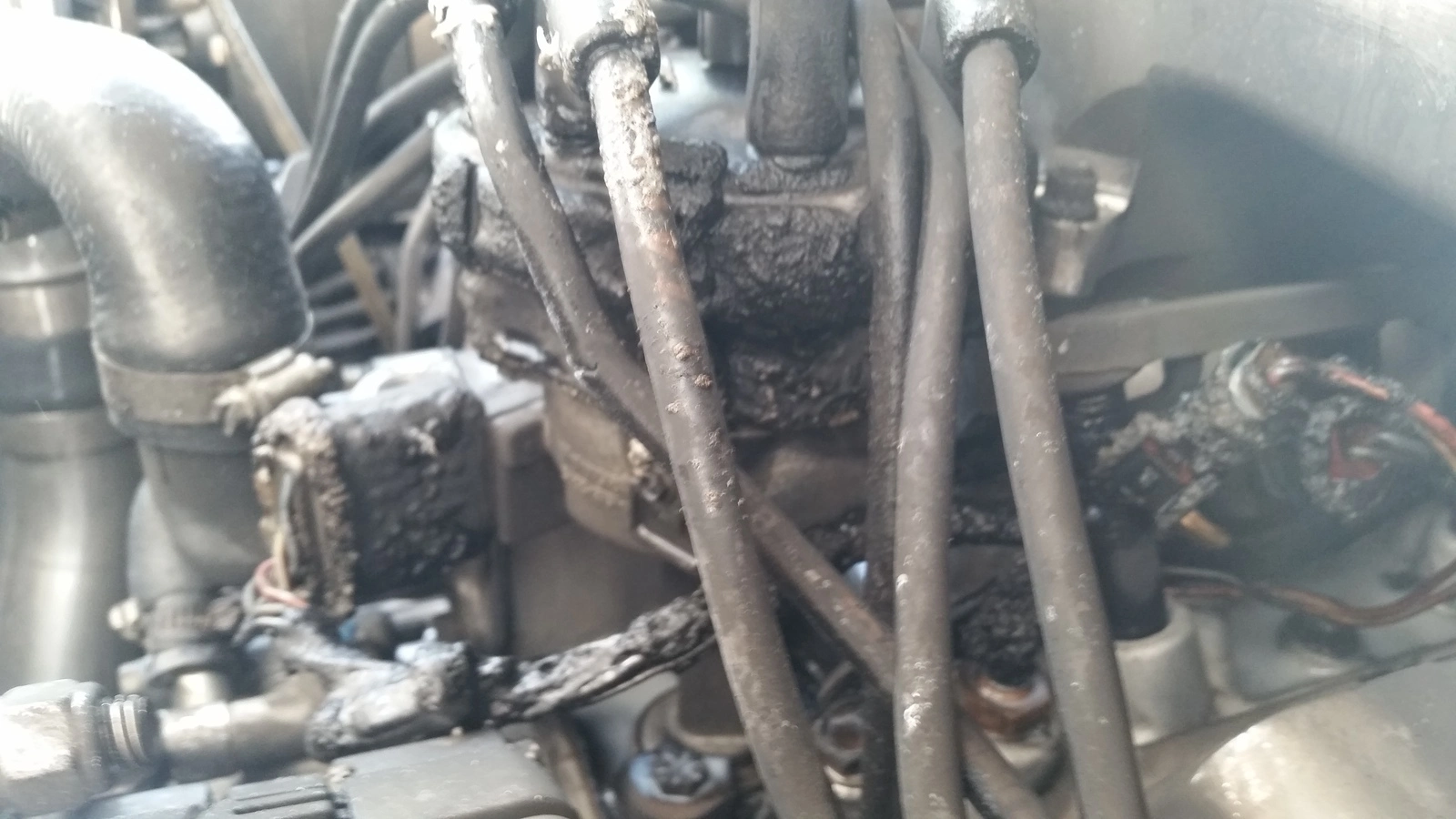

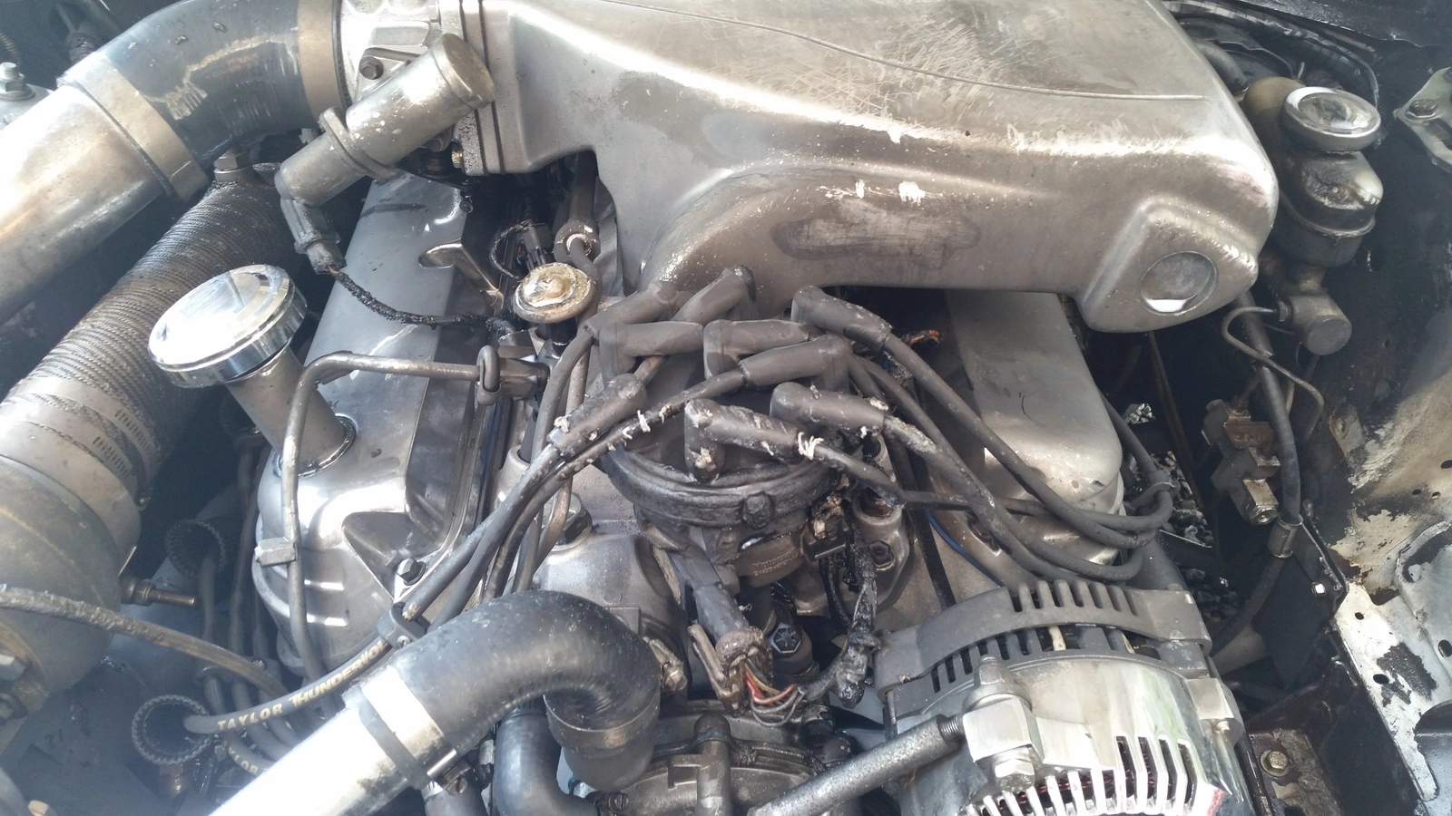

New fuel pressure gauge came in. Got it mounted at the rail and all seemed fine. Ran the key through a few cycles to prime the fuel system. Gauge read a bit low, so I disconnected the vacuum line and loosened up the adjustment nut on the fpr. Fired her up. All good. Ran in the house for a second to grab a glass of water. Came out, bay was engulfed in flames. Shut it down quick, but too late.
Wifey had a throw rug lying nearby, so I grabbed that and threw it (no pun intended) on top of the bay till I could grab the water hose from out back.

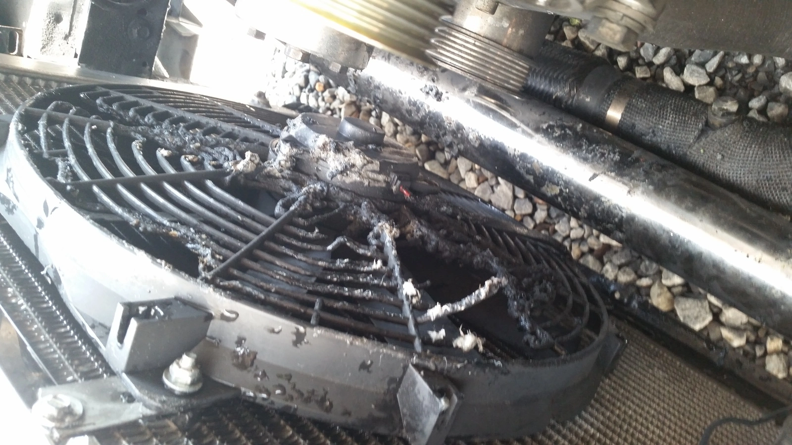

Appears to be mostly cosmetic damage, but I called Grundy to report it. Theres a bunch of wires and other stuff all melted, as well as soot and black chit all over. E fan is melted, all the plug wires and cap.

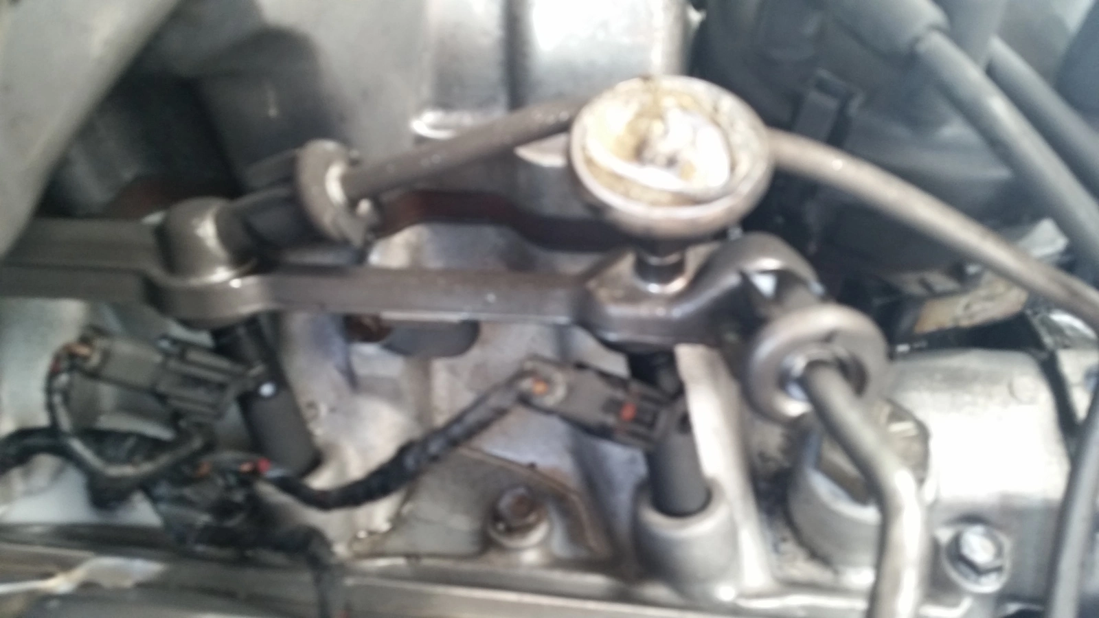

It appears as though the fuel pressure gauge blew its seal between the plastic lens and the housing. Not sure how it got ignited, but you never know with fuel.

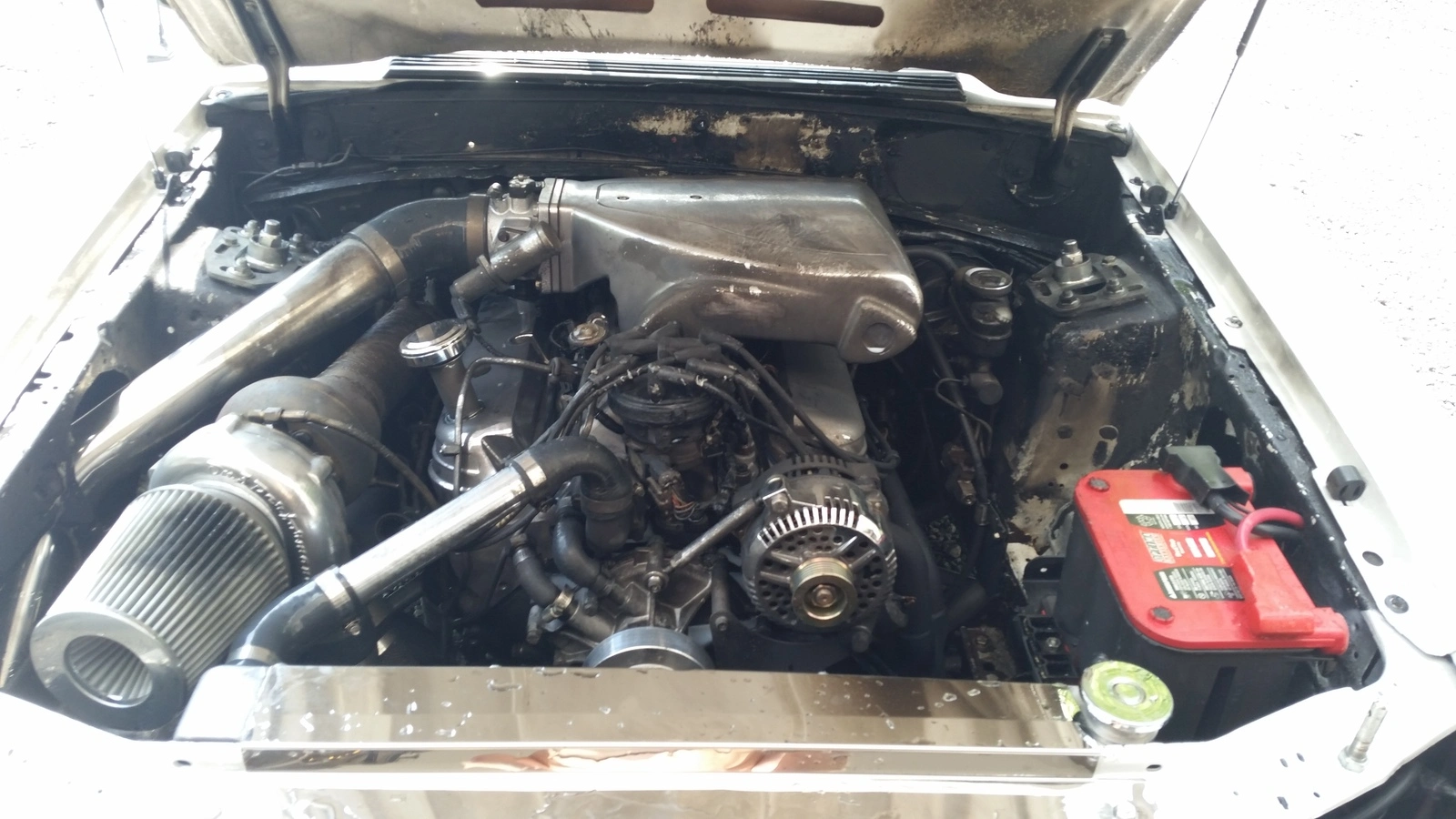

Few pics
HOOOOOOOOOOOOLLLLEEEEEE HEEEELLL!

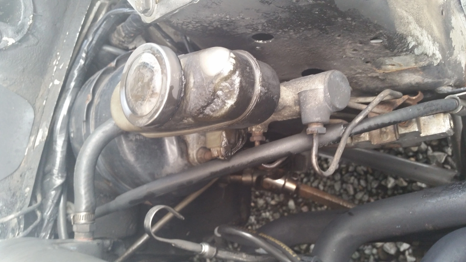

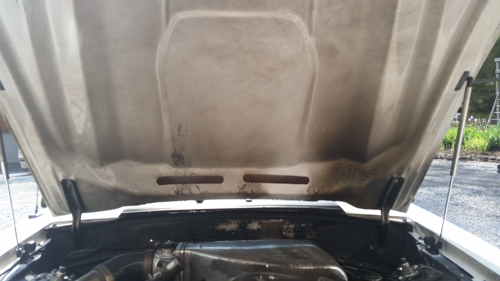

What did it do to the hood and paint?
Looking at the pics, it looks like all re really lost is rubber and plastic.
Definitely sucks. Sorry about that man. I hope I'm right about the damage though.

I would say suck it up, look like it repaireable , mostly wired ...sad to see this, but good luck.

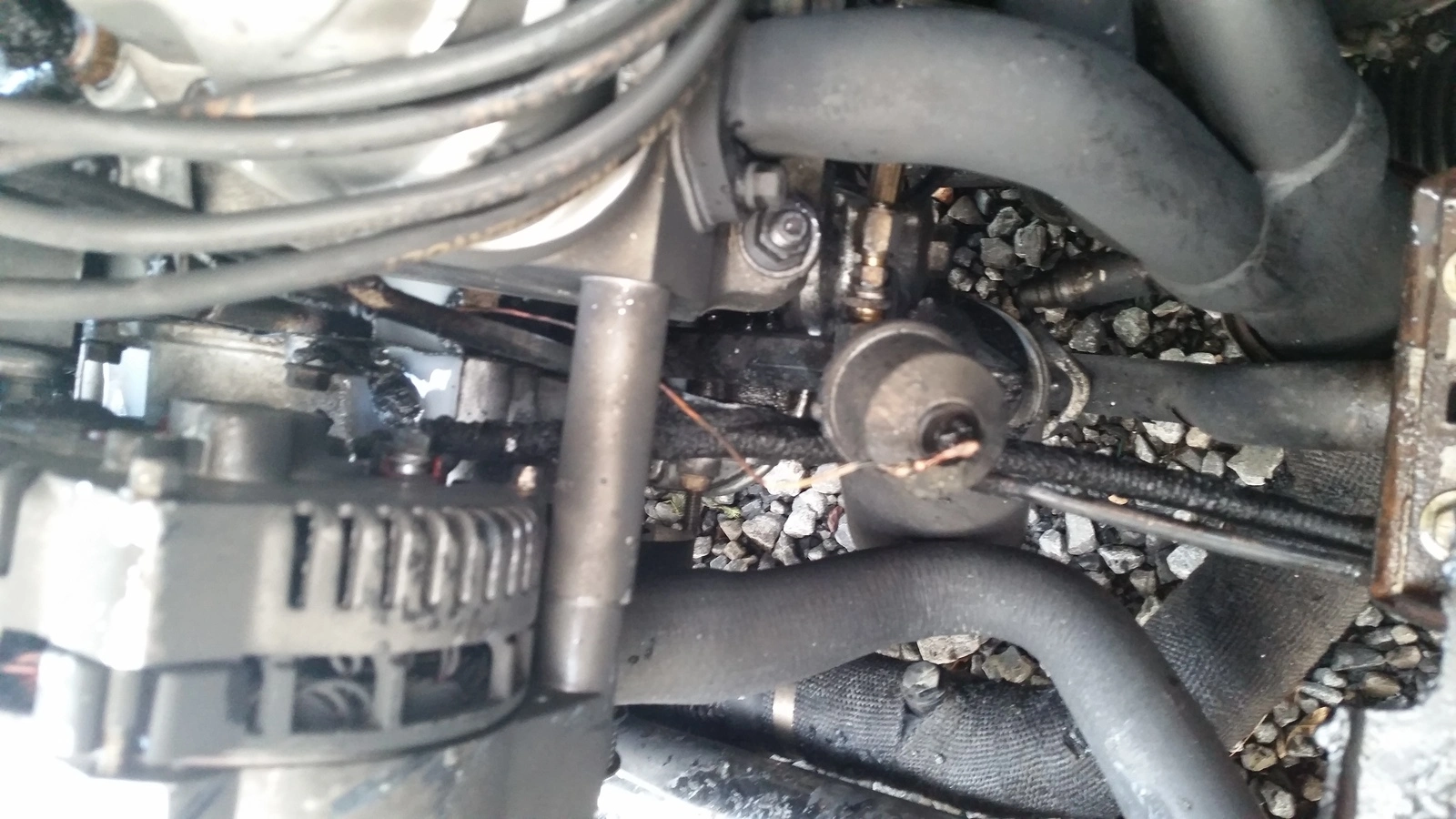

does look like fuel ran into valley
you cut the belt off? pullies all look untouched!
should be pretty straight forward hang on / wiring swaps.... let someone else do it... dont think i could bear it...
