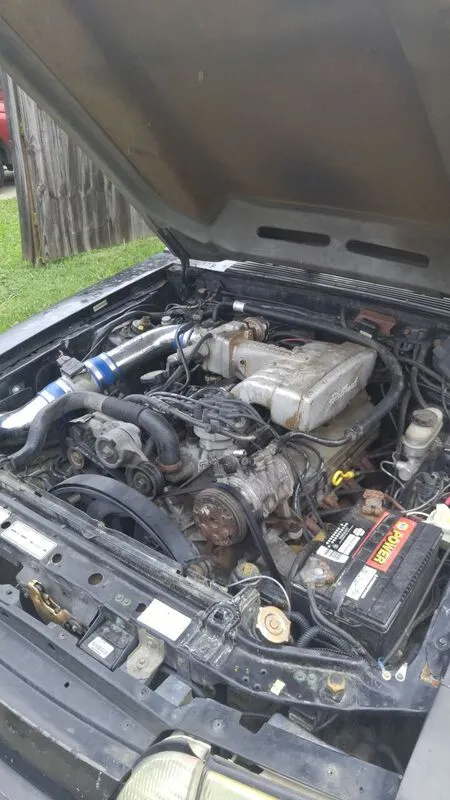

My 93 Foxbody Gt

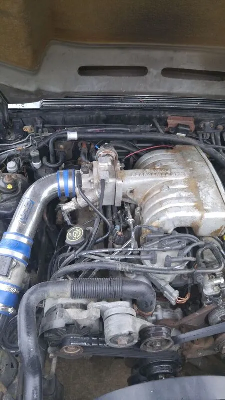

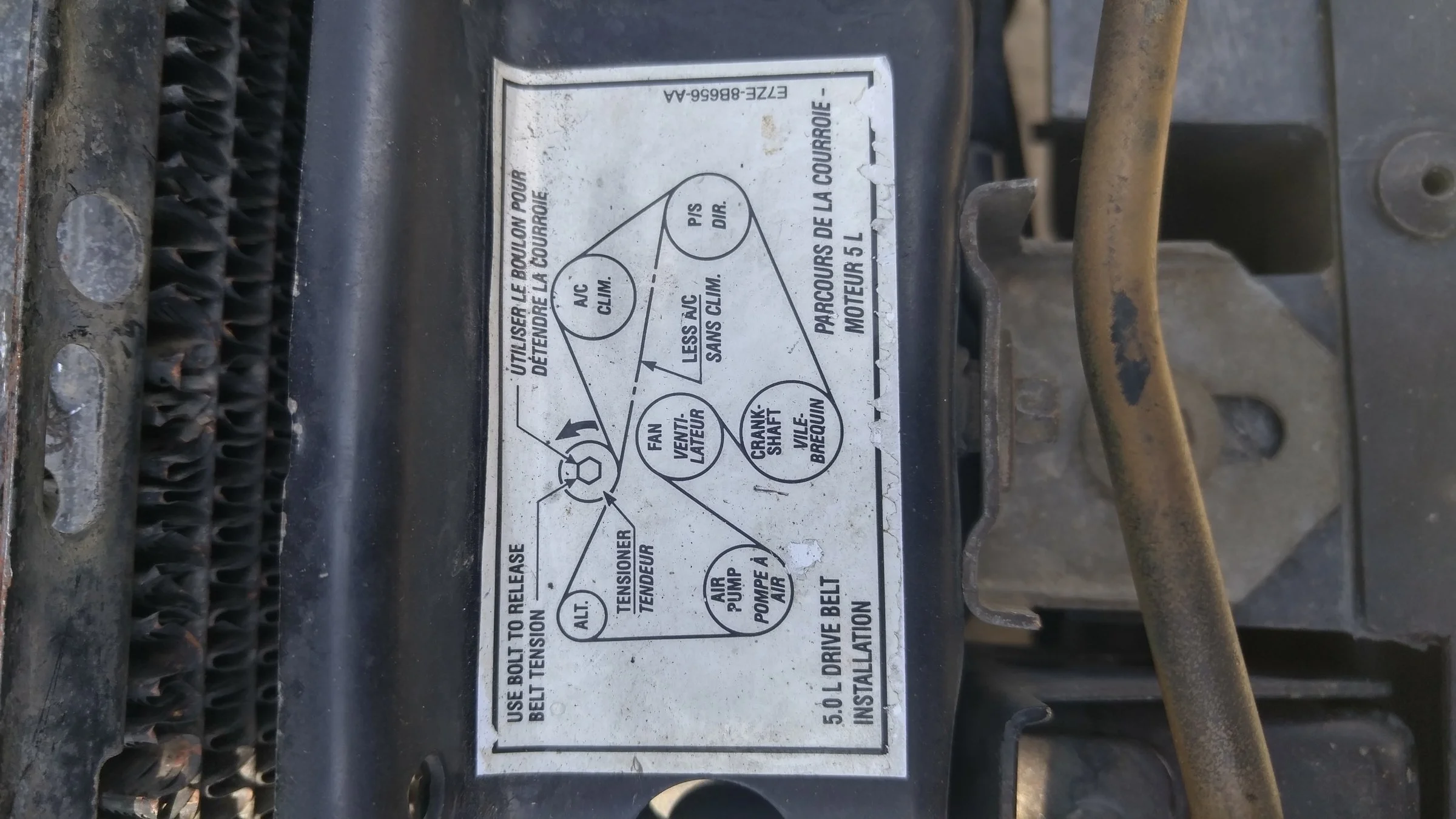

Yup, factory routing minus the pump.
However, at some point you should change it to match the diagram. As the belt stretches the tensioner can move and the belt can rub against itself, leading to failure.
You have enough gap, for now, so don't lose sleep over it.
