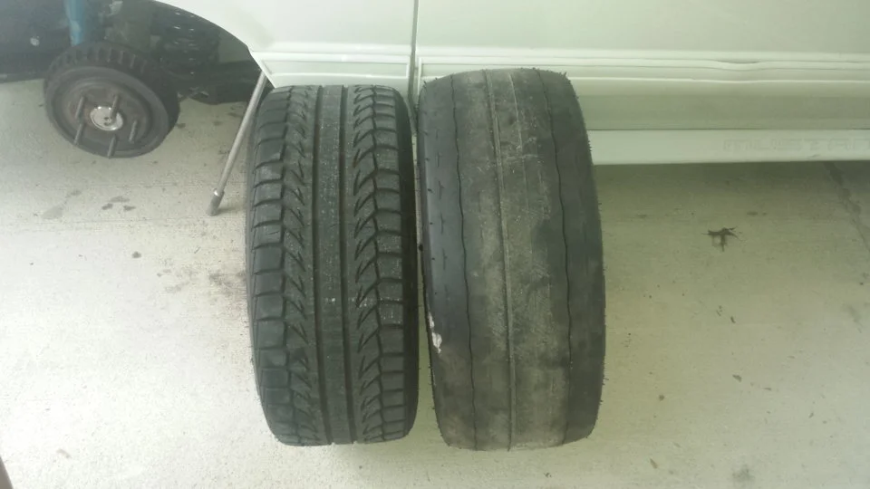

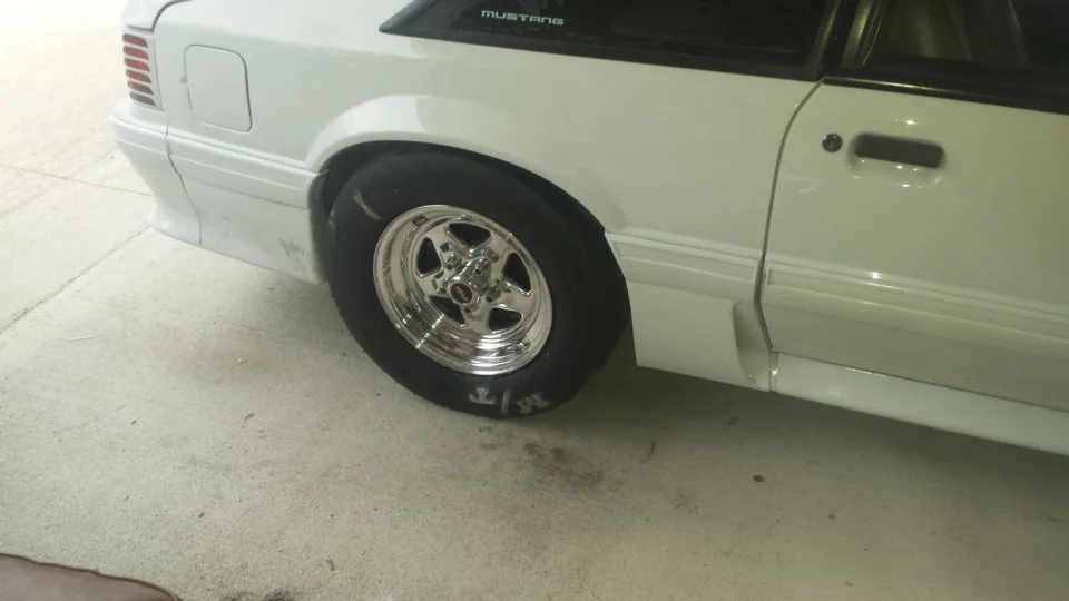

took the car to work today (finally), came home, and swapped these on:
took it for a drive, and i'll just say that next time, i'm going radial. they're balanced fine and i didnt have any problems, but they are a bit floaty. should launch pretty good though.
supposed to rain its ass off the next two days, but saturday is a long track day (opens at 10am for tnt/jr. drag, and then they moved friday's midnight madness to saturday cause of the forecast, so should be running till about 1am if its like 2 weeks ago). hoping it runs as fast or faster than the coyote, at the very least it will stick better.
Yeah they float around pretty good. Make sure you do a good burnout and start around 13-15# pressure at the track. Should hook really well. I'd start off at 4500rpm launch and see what they do. If not to concerened about breaking you can go up from there. I would expect somewhere around 12.2-12.50's. It's a lot harder to get a radial to hook with a manual. I still could t get mine to with Nitto's(which obviously isn't the best radial).

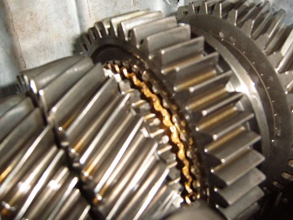

wednesday i was launching at 4500-5000 and getting 1.72's, yesterday i was trying 5000-6000 (even left off the limiter once) and it still only did 1.7x. some of this i'm sure is the suspension, its all still setup for street duty and leaves fairly flat (b-springs, tockiko hp's, mm xd lca's), but it hooks apparently a little too good. i think some extra power, whether it be a tune, or a cam and intake change (thinkg tfs2 and a systemax) will help both the bogging and the top-end.

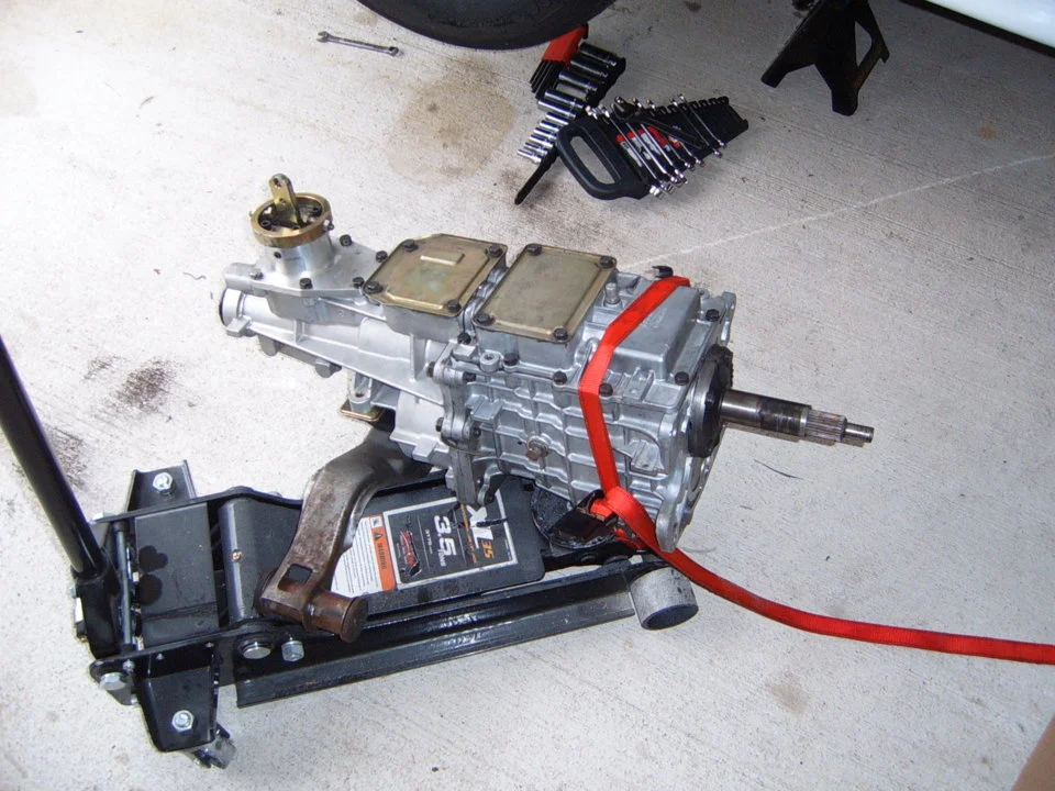

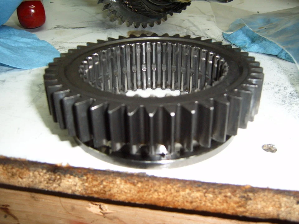

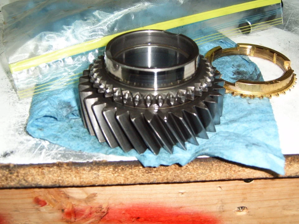

first thing i gotta address though is the trans. it wont powershift 2nd or 3rd, and half the time it wont go into 2nd at all. got it out and torn apart today, now i gotta find someone who carries parts for this thing so i can get it put back together this week. took pics, of course my phone's didnt want to focus today, and my digital camera is old and has a tiny screen, but hopefully its enough to make out.
2nd gear and slider
2nd gear engagement teeth
2nd gear side of 1-2 slider
so i at LEAST need a new 1-2 slider, 2nd gear, and maybe a 3-4 slider and 3rd gear (not sure on the 3rd stuff, its not as bad as 2nd but its still rounded off). also want to find some carbon-lined blockers for 2, 3, and 4 but havent been able to find those online at places i feel comfortable ordering from. tomorrow i'm going to call hanlon, libertys, and/or d&d (astro may be on the list too, they list a few tko-500 gears) and see what i can get when. at least this things easy to work on, once i had it out (which itself only took about 30-40 mins of work) it only took about 15-20 minutes to get the thing torn all the way down.

so called astro today (they actually had parts listed online unlike others) and ordered $800+ worth of parts
1-2 synchro assembly
3-4 synchro
2nd gear
3rd gear
3 carbon blocker rings
so for those keeping count and comparing to new, this whole tko setup has now cost about $2600 for the trans, bell, pro-5.0 shifter, alum d/s, and new yoke, and the upgraded synchro's. i see most places advertise ~$2400 for just a basic tko500 plus the bell and upgrades, so i figure i'm still somewhat ahead, though not by much.
