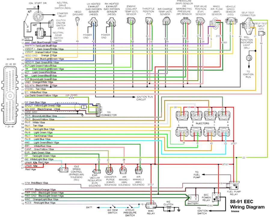

Check the resistance between the black/white wire (#46) on the self test connector and battery ground. You should see less than 1 ohm.
diagram courtsey of Tmoss & Stang&2birds
See http://www.veryuseful.com/mustang/tech/ for more good stuff...

I have a 5 speed car.. My clutch switch currently is bypassed (previous owner)
Could that be a reason i can't pull codes? I tested pin 46 and had near 0 resistance after some sandpaper touchup on the STO pin.
See Tmoss's post #7 above. The clutch-safety-switch has nothing to do with it (this is the switch on the clutch pedal you push to close the starter interlock circuit - to let the car start).
It sounds like this is what you are talking about and it does not affect code retrieval (as Tom already said).
Good luck.
I was just wondering.. I trested some wires today.. none of the sensors attached to pin 46 ground were bad.. I'm still getting the "voltage on" symptom..
Where is this Neutral Gear Switch?
Can i ground out pin 30 and bypass this feature?
