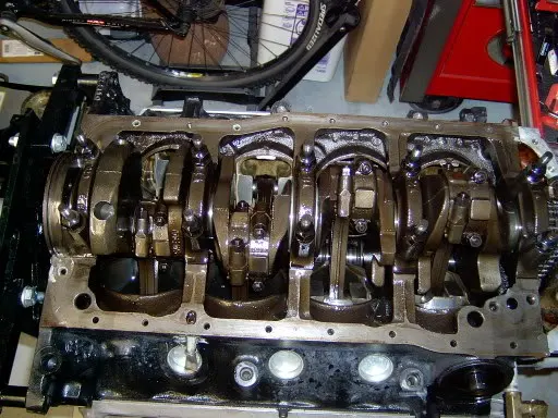

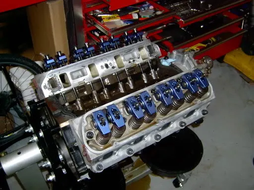

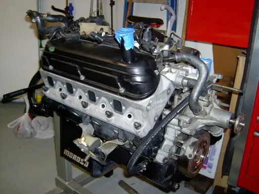

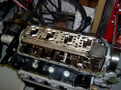

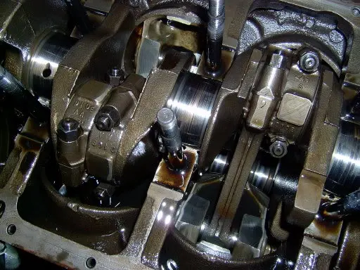

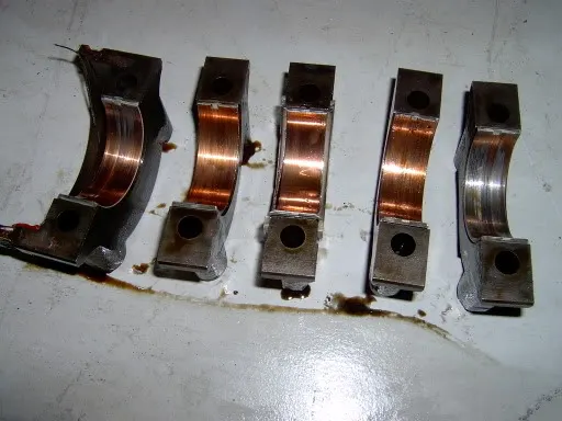

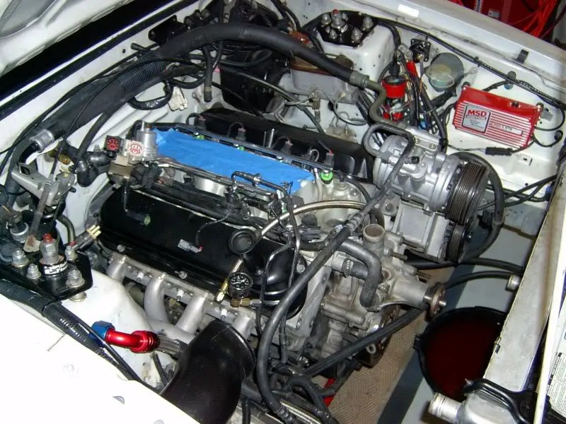

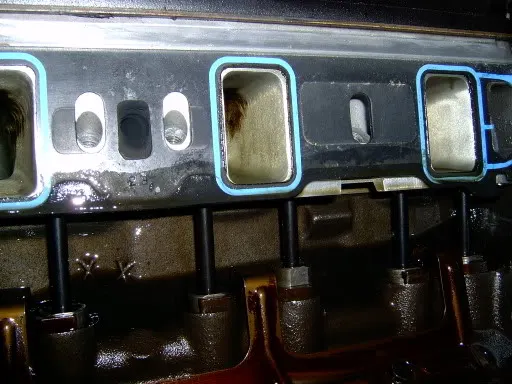

Finally got the engine out and partly torn down. Here's a few pics. No idea what caused it...:bang:
Car
Motor Out
Oil pan off
Copper particles, not good
Looks OK from a distance...
My wasted crankshaft
Wasted main bearings, rod bearings don't look too bad
Ported Edelbrocks, thats a 1262 gasket
Top shot

Mike what does the back and front on the thrust bearing look like? What do the back sides of the bearings look like? Clean off where the caps sitt on the mains saddles really well and take some pics, also take pics of the caps where they meet the block...this will tell us is the mains were walking.
You can set the blower up on a bench, and feed some new oil through it to flush it out, done this a few times when you take out a head gasket. Also check the filter screen on the blower fitting, I am sure it caught some on the debris as well. That is one reason I like the Self Contained blowers from Procharger.
i hate that you are having problems. that looks like a very well built and taken care of engine. in the top pic it looks like you have a bicycle seat sticking out of the right hand valve cover. did you race a schwinn and suck him up in your tailpipe??
also i have read that the cobra intake is only good for around 350 hp. seeing that you have a good build and a blower, i assume the 350 hp max is not accurate at all. what's the most you've gotten with that intake, just out of curiosity? i hope you get it up and running again soon. looks like alot of hard work went into it. good luck man.
Hey Rick, I'm gonna try and get some more pics up real soon. I'm having a heck of a time getting my balancer off. I already broke my puller on it. As for that thrust bearing, it's down to the copper on both sides. The main saddles seem to be OK, but I need to take a closer look

I might be able to benefit from a better intake, however my Cobra has been fully Extrude Honed, upper and lower. The porting actually cost more than the intake itself. I was making around 418 rwhp with it, and that was pulling out a lot of timing. It had a lot more in it, and I was planning to get a chip burned for it so I could put some timing back in it.

After seeing the extent of the damage, I think I'm leaning toward just buying a new 306 shortblock and reusing most of my other parts. While I'm at it I think I'm gonna put in a AFM blower cam
is that a DSS short block?i have to agree with the mains walking alittle.also if it wasnt line bored properly that could cause it i belive.sorry to see that.that kinda happened to my last motor.the crank wasnt machined right.and wasted most of the bearings.it sucks.

Generally speaking a crankshaft can be turned, but since this is a rebuilt motor, this one has been turned down already. I don't know if it could be done again. DSS sells their "race prepped" factory crank and bearing kit for $299 though
